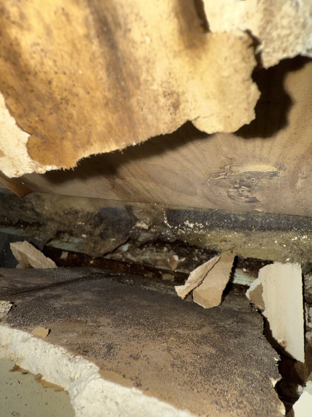

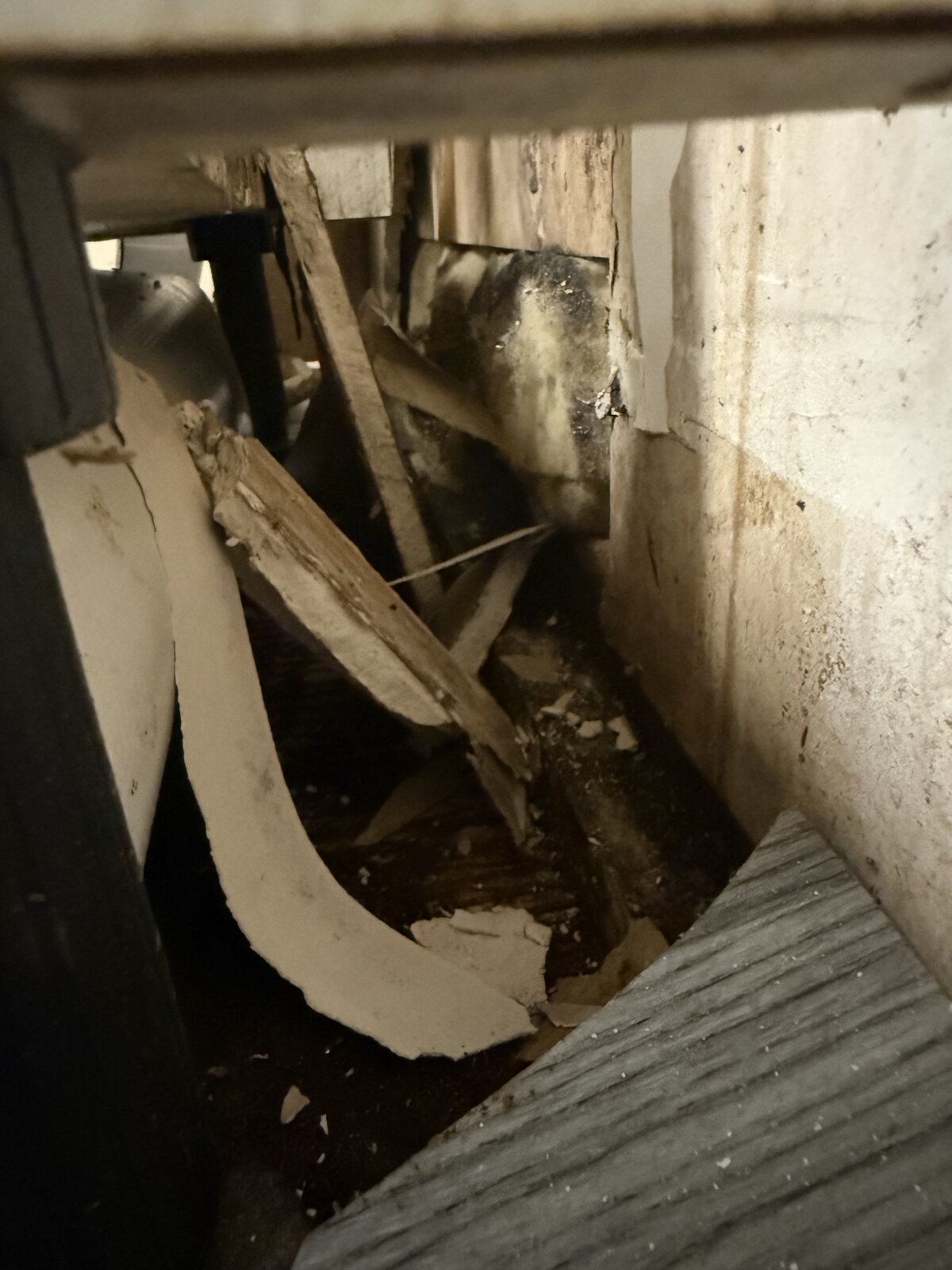

I know there are a couple of other posts, but can you please help me? I’m in a housing association property built in 2020, but I don’t know if they bought materials the year before or not when asbestos was banned?
I’m having my kitchen refurbed and like my bathroom before it a leak has caused the floor and wall boards to disintegrate as well as the kitchen fitted unit. I only went in there to hoover before they came tomorrow, and was shocked to find screws and attachments under the vinyl they’ve laid. So I pulled them out and hoovered it all. Well, unit and flooring collapsed. Behind the wall is yellow filler.
Can you see from the pictures likelihood of asbestos please? I’ll ask them to check but I know they’ll say it’s fine. How can you actually know without testing though?
Thank you

Asbestos tends to be tough. Hard to drill through. It was used for roofing and fences; therefore, it resists water. If you are worried, get someone to test it. But remember, if left and not touched, it won't do you any harm. Do you really want to rip it out, which will scatter fragments all over the house? (Let sleeping dogs lie.) I've often found it to be labelled. Look for markings painted on it, or even paper stickers glued on it. Get a bright light on it and take lots of photographs to see if you can pick up on any identification marks. If it does turn out to be asbestos, dispose of the vacuum cleaner (properly) and clean the place like there's been an infectious disease in the place and don't keep any of the rags.

The yellow filler you refer to is insulation. Its either rockwool or glass wool, not asbestos.
Get it tested if you're worried, but its highly unlikely to be asbestos with a house of that age. The nasty asbestos was banned in 1985 with ban extended to white asbestos which is no where near as dangerous in 1999. However, people had stopped using it long before the ban and i've never heard of or seen asbestos that looks anything like the insulation shown in your photos.

To the poster, no sign of asbestos in the photos.

No one can tell from photos. Getting it tested ASAP is the only way to go.
Before we do any refurbishment, we must always consider asbestos unless the property was built after asbestos was banned. And even then, be on the cautious side.
My experience is that tradesmen generally don't consider asbestos and aren't qualified to advice. Having had a bad experience with high content asbestos, and a tradesman who endangered himself and me, I will get an asbestos inspection before any work if not sure of the prescence of asbestos.
You are spending about 2K on refurbishment? Another £100 on a survey, insures safety.
Now, we're not taught asbestos awareness at school so don't beat yourself up about it. Just get hold of an asbestos pro and have a survey done.
