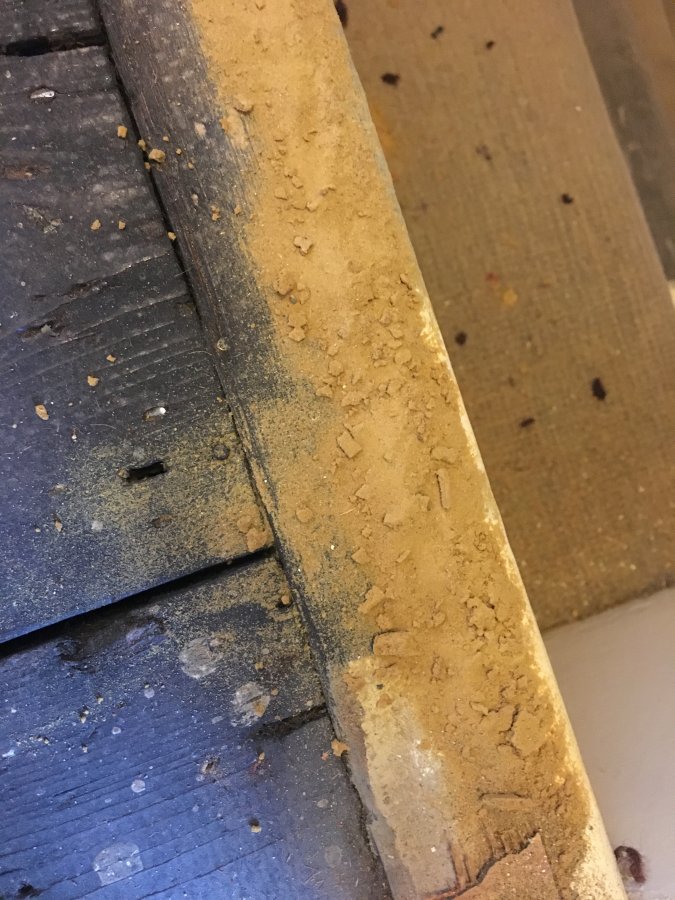

My partner and I have moved into an old Victorian house that needs renovating.
We're in the process of throwing out the carpet.
I'm now worried that we've been too hasty and have exposed something we shouldn't have.
There is dust under carpet lining under the old carpets. It's above the floorboards, which we've exposed. Do I need to be concerned about this dust?
Thanks.
Here is the dust

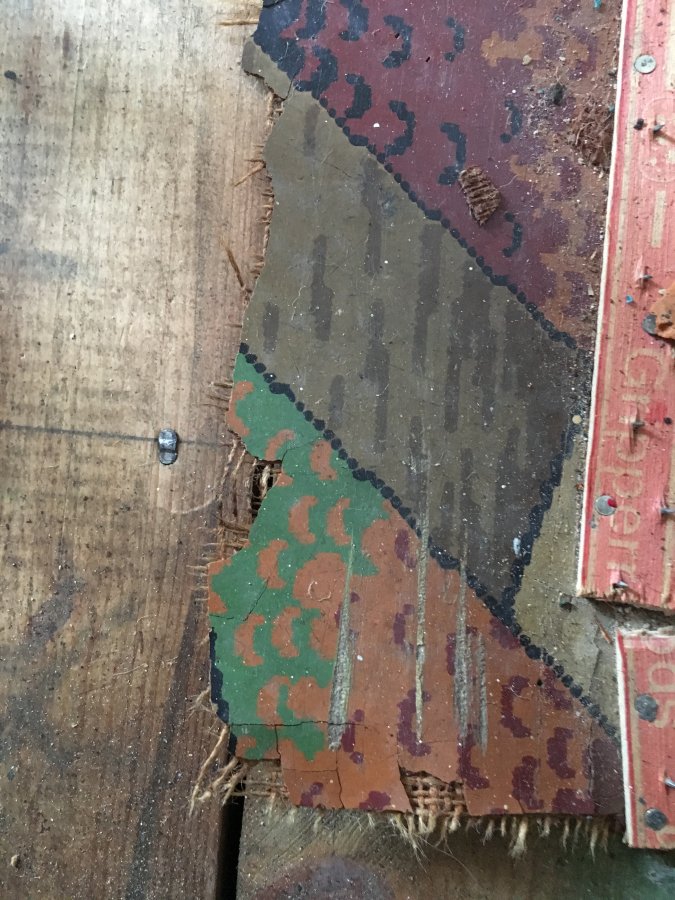

And this was under the carpet in the dining room. Vinyl like underlay?

Thanks.
Some paper underlay and vinyl underlay under the carpets. There wouldn't be any in those?
Thanks.
Its a foam backed carpet where the backing has gone hard and disintegrated ,we had quite a few rooms with the same dust under the carpets in high wear areas. second picture looks like old lino?
