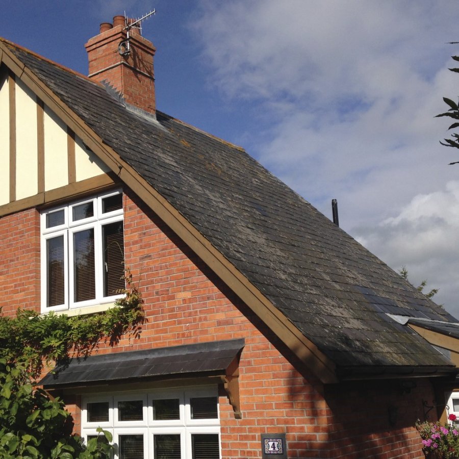

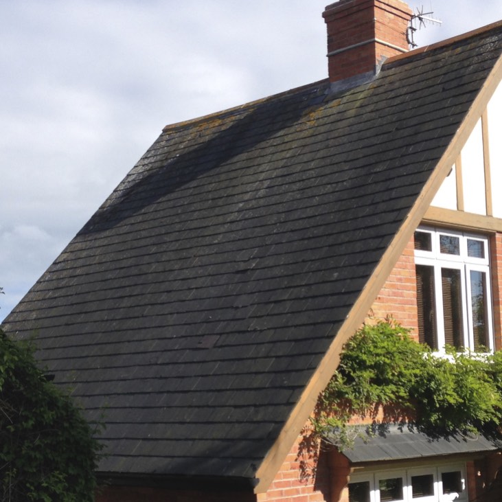

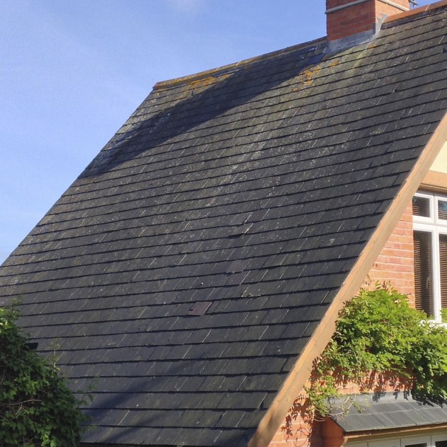

Hey guys and roofers, here are pics as promised! Difficult to get a real side on shot from the road...unless I started trespassing...
But I could see some shifted slates, slates that had lost the odd corner. Quite a few slates with copper hooks.
It's funny because the owner is a builder by trade and the inside is immaculate, he repointed and that looks very nice work, but seems he has largely avoided anything major on the roof. Without checking the loft, it's impossible to say if it has been re-slated at some time. The next door house does look like it's had a re-slate, the slates look cleaner, more regular and no clips visible.

From 1925 you probably have at least 100 more years life in the slate
