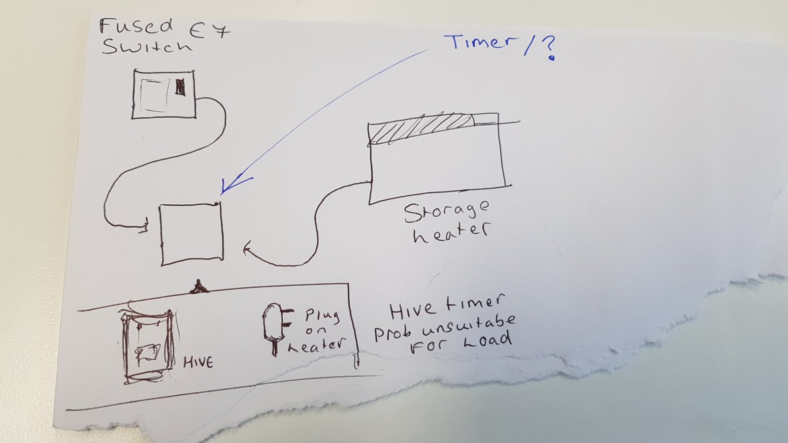

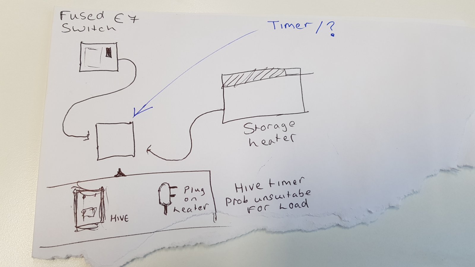

What i would like to do is somehow 'switch on' the storage heater/s the day before (say during Thursday night / Friday morning) so the house is warm on my return (say Friday afternoon).
I was thinking along the lines of a Hive Plug (or similar) so I could use the app on my phone and have the electric to the heater turned on in time for the economy 7 to kick in and heat up the bricks. (although the hiveplug will only connect to the power during E7 times but should keep it's settings along the same lines as the Hive Lightbulbs)

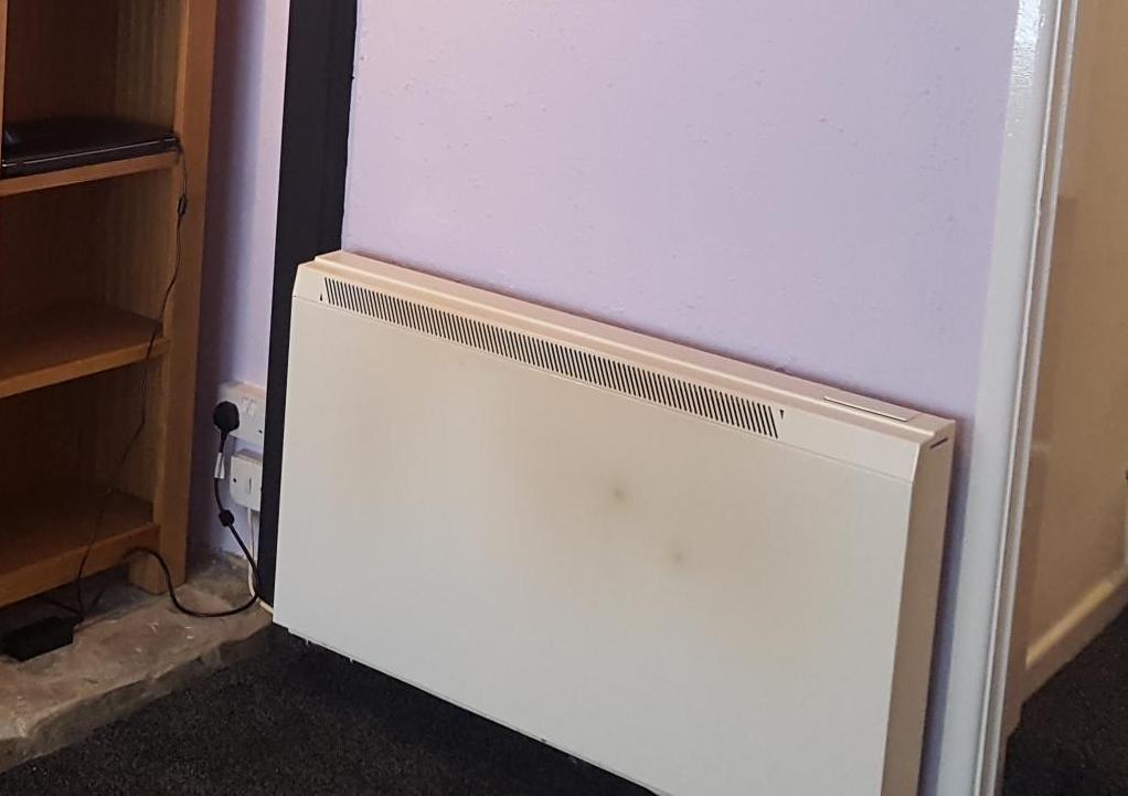

Currently the electric to the heaters is controlled by a on/off switch (assumed fused).
I know I can't just can't stick a plug on the heater and plug it into a socket as the heater will overload the plug and socket.
Was just wondering if anyone had and ideas / solutions of how this possibly can be done.

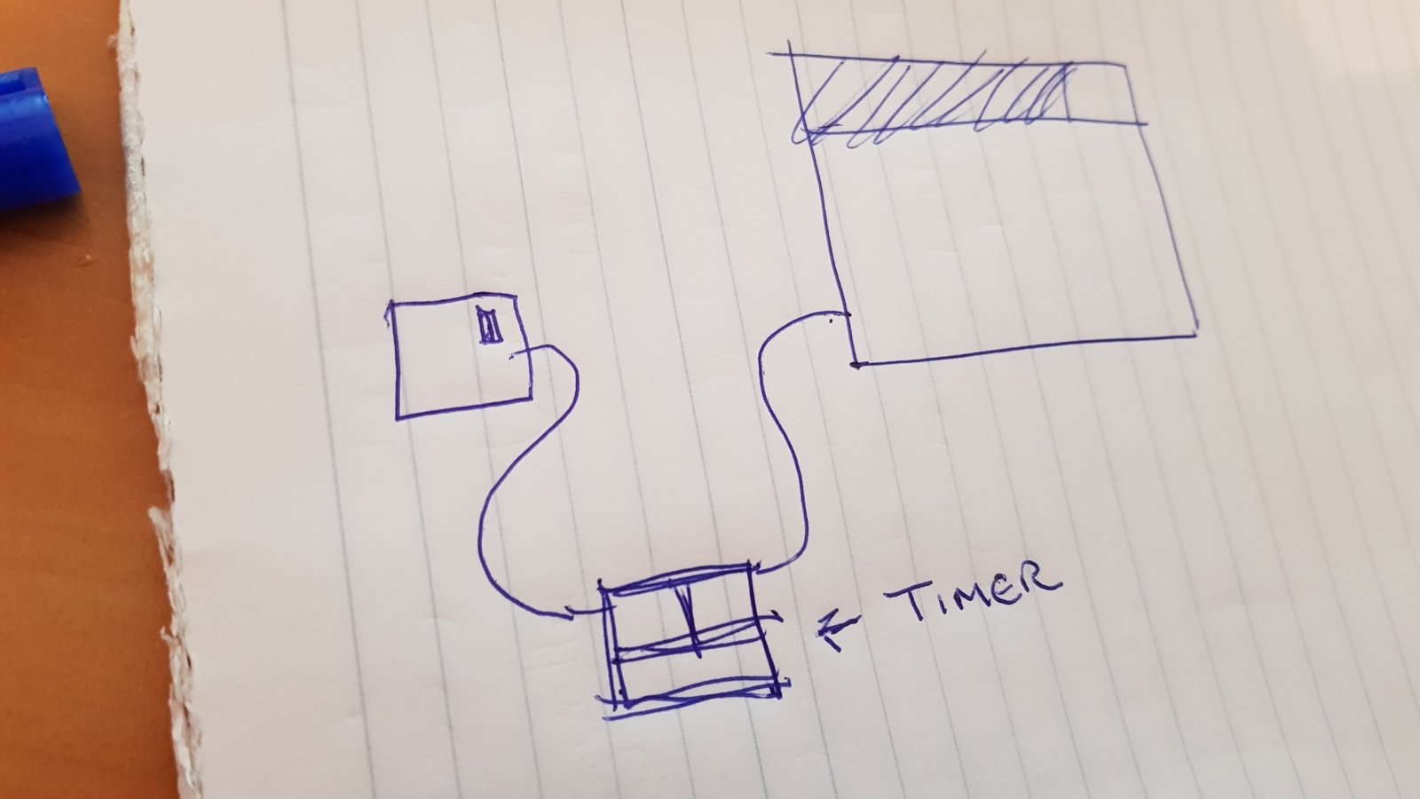

Even having the heater come on every Thursday night on some kind of manual timer, instead of wifi based, would be better than wasting 4 weeks of electricity.
Could i cut the wire from the heater to the fused switch and add something between ? (first idea was a plug and socket and hive plug but assume hive plug wouldn't handle the power either)

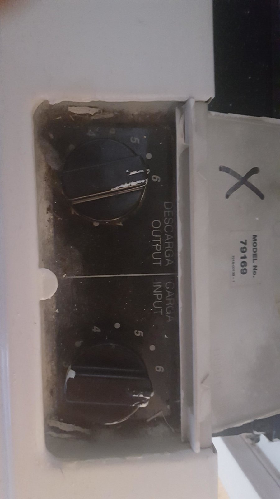

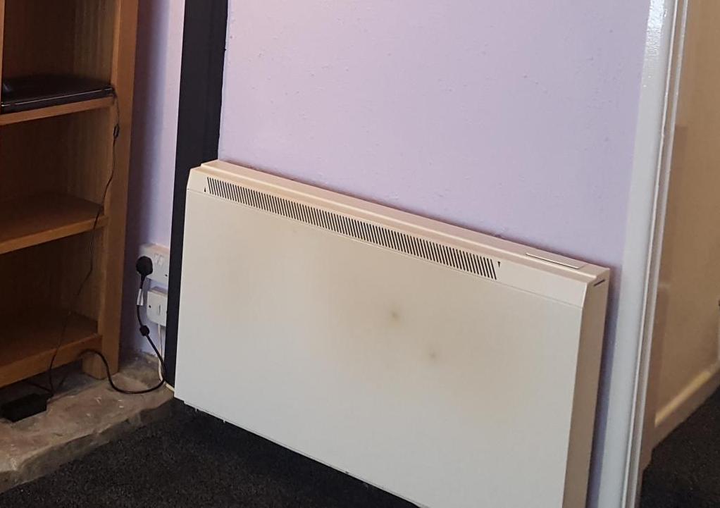

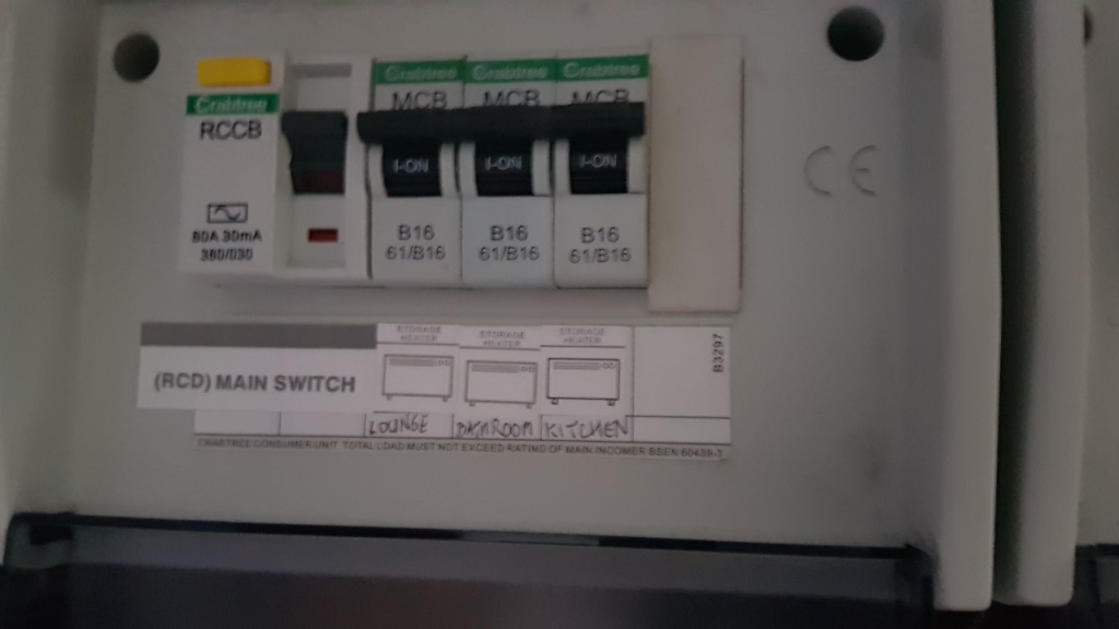

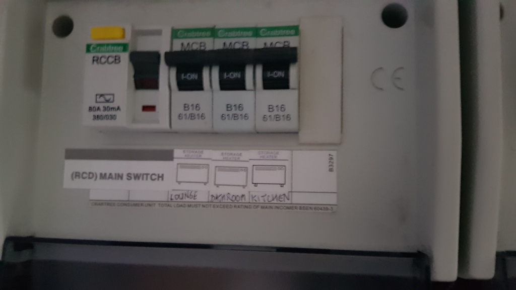

Have attached a couple of pictures of heater / switch and E7 fusebox. (Plus a rough sketch of my silly idea!)
many thanks.

If the heaters are all like the one in the picture they will contain 4 elements, 850W each, 3.4kW, which is more than 13A.
No 13A plug device will be suitable, for the same reason 13A FCUs are not suitable - they will overheat and fail.
The solution - a contactor in the supply tails to the off peak consumer unit, controlled by to whatever electronic internet connected piece is desired.
Plus a manual override switch to use for the inevitable day when the 'smart' timer or switch fails.

Indeed - those wire-in 'immersion' time switches are usually rated at about 16A, which should be enough for one storage heater.
However, as I said before, a 'mechanical' one certainly could not simply be wired into the feed to a heater (and, obviously, one one heater), since it would only be powered during the cheap-rate hours (so the timer's clock would stop for 17h every day!). As I also said, one of the electronic versions might work, if it's internal battery could cope with it only being powered for 7h each day.

Storage heater installations should have a separate consumer unit just for the heating. It is only 'live' during the 'off peak' times.

There are two systems.
1. There are two feeds from the meter. One feed is timed to come on at off peak times, times controlled by the meter, or by an external timer. This needs a separate consumer unit for the heaters.
2. There is only one output from the meter, but use of the electricity is charged at lower rates at cheap rate times. This requires separate timers that turn on heaters and immersions (eg) when its cheaper. The Horstman Economy 7 is a typical device that does this.
Looks like the OP has type 1.
Only suggestion would be a wifi switch that operates a hefty contactor that switches off the E7 supply to the off-peak CU. Maybe someone has something in mind that could do that?
Method 2 is not normally used for storage heaters, unless there is perhaps just one heater. The electrical load for several heaters would necessitate either each heater having its own timer, or a single timer being used with relays / contactors to switch the heaters on. It's much more convenient to use a dedicated off peak supply direct from the electricity suppliers meter. This also avoids the timers going out of sync with the off peak period and will allow the storage heaters to make full use of the entire off peak supply time.

Thanks everyone for your replies and comments. It's been really interesting reading.
I'm definitely looking for something fairly easy to install and not massively over complicated.
Using an Hive WiFi plug socket timer means that even if the plug was offline (i.e no electric or internet) it would always save your settings as the on/off programs would be pre-programmed when the unit is active and are saved in the cloud. (Hive light bulbs work the same way. If the light switch is turned off then the on/off programs won't work but are still stored for he next time it receives power)
Alas that's not an option though as the load of the heater load would be too much.
I'd be happy with just the one heater be controlled with a timer and having the heater coming on once a week wouldn't be a massive problem. (Still better than heating an empty house for 3 - 4 weeks)

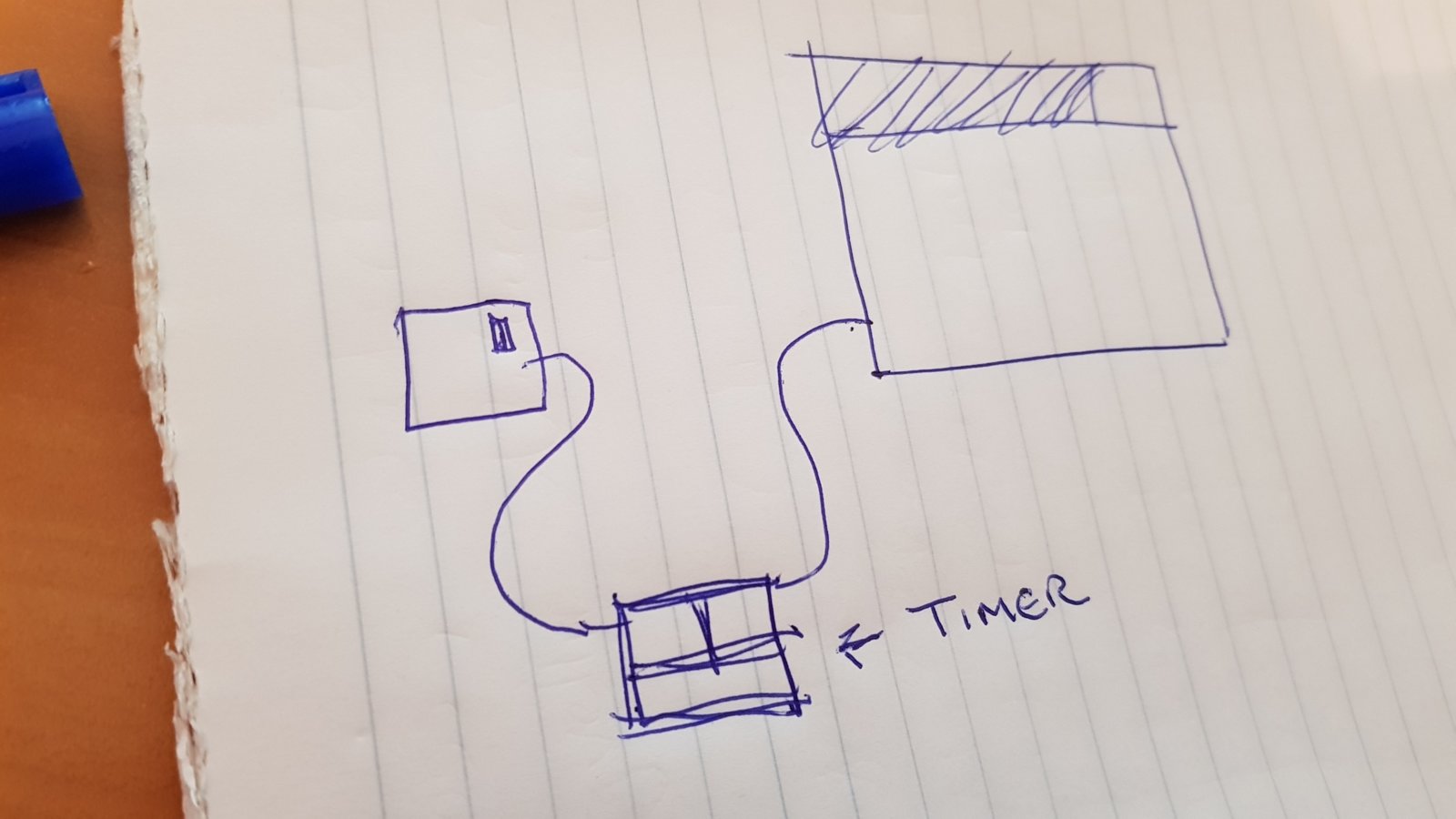

Could I, however, install it between the heater and the wall switch?
rough sketch!
Thanks again everyone for your help and advice.
