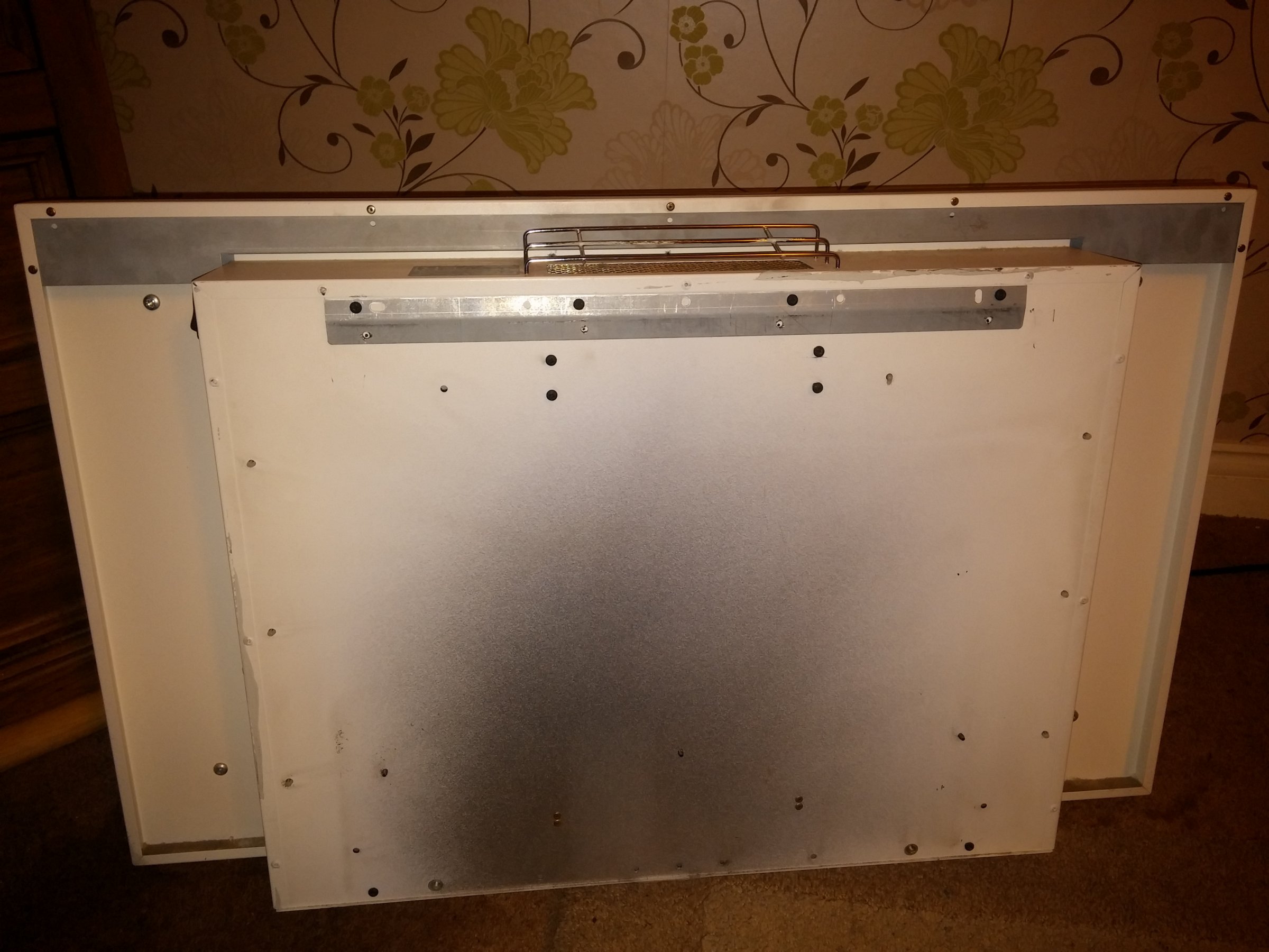

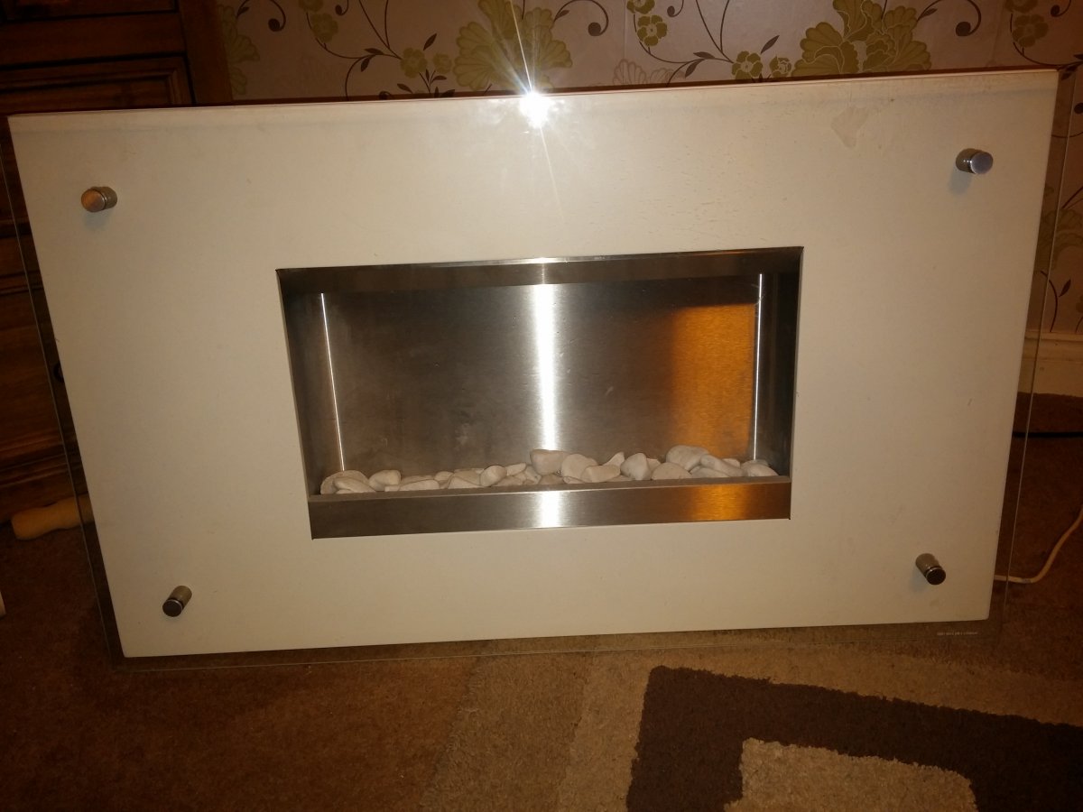

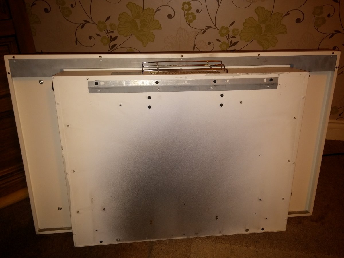

Hi,
Hoping someone can advise as to the best method in hanging a fire to a solid wall.
I was given a electric fire but there appears to be no obvious mounting points on the back of it in order to secure it to the wall.
How do I best mount the fire?
Thank you.

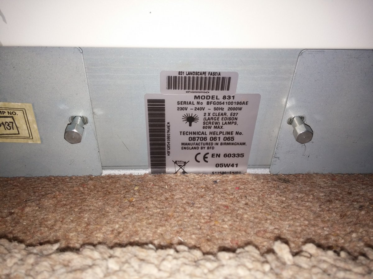

Model and brand would help or a pic?
Hello, thank you for replying.
Not sure on brand/model, took a picture of the label on fire

Well the clue might be the words
"Technical Helpline"
A telephone number 08706 061 065
And the words
"Manufactured in Birmingham England by BFD"
And the words
"MODEL NUMBER 831"
Where's the electrical cable/flex?
It's missing a part.
There should be a horizontal bar (wall plate) to fit onto the wall - the metal bar on the back of the fire hooks over the wall plate
