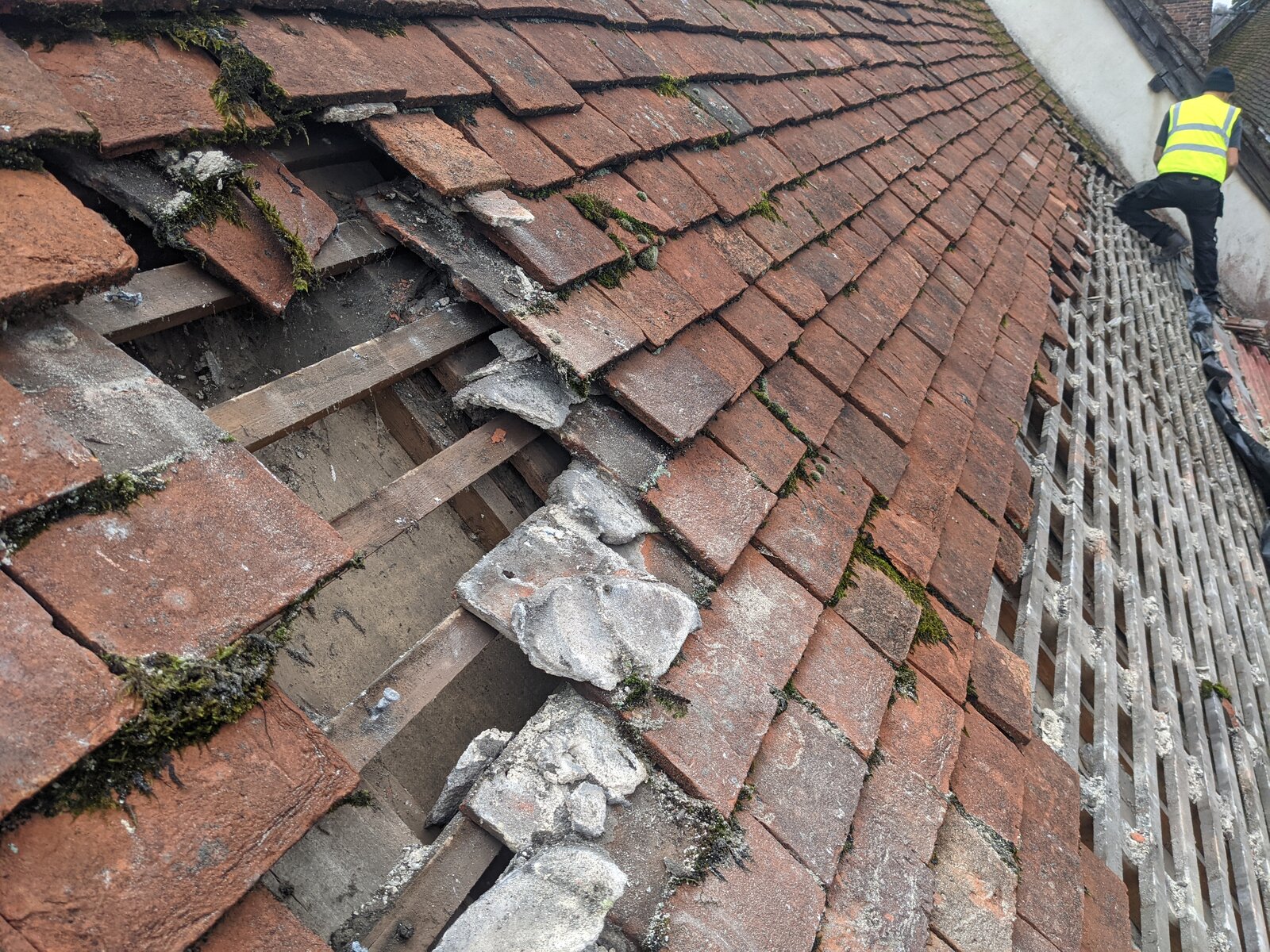

PXL_20211116_110412814.jpg Peg tiles are by nature uneven.
They are not meant to look like machine made tiles.
We currently have a church project underway, I'll take and post a few images that might be useful .

Boxgrove priory church is one of ours (peg tiles too )Arundel Cathedral ..slate
