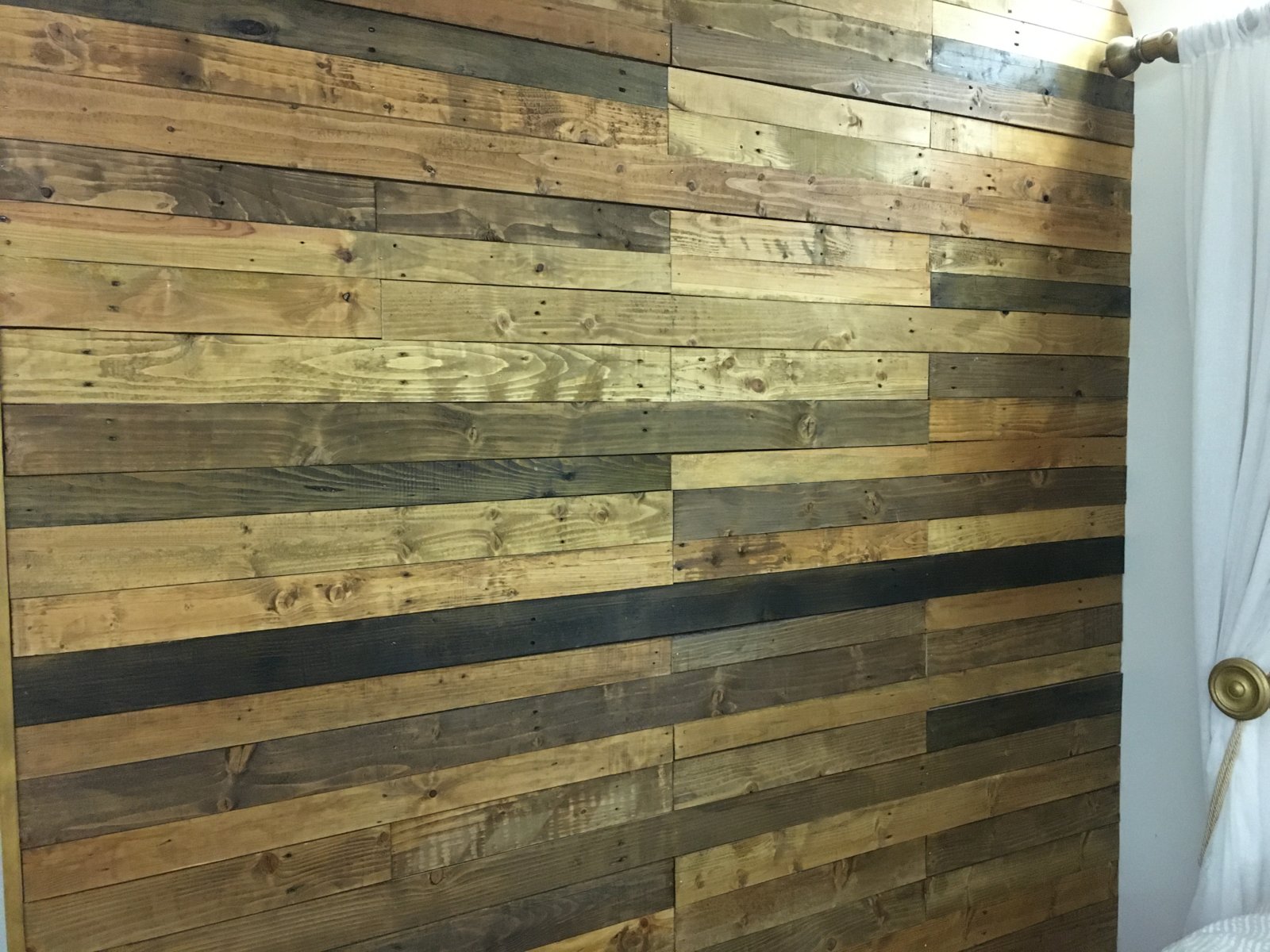

2D21B32D-C26A-4F3C-800D-7DDADD6FC3B0.jpeg Nailed mine , stained different shades + danish oil .
