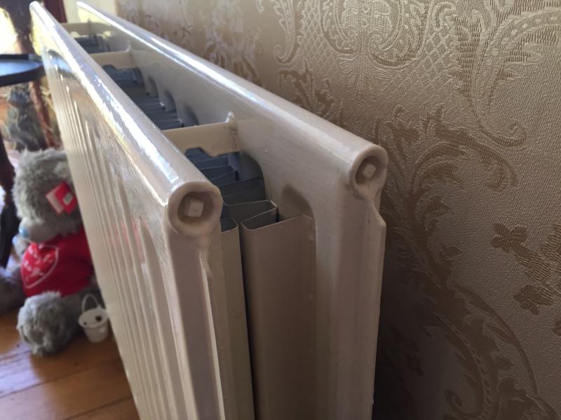

Hi, does anyone know if it's possible to get an automatic bleed valve to fit this type of radiator?
Why would you want one? If you have to bleed it often there is a system issue!
first radiator in the system after pump/boiler always needs bleeding. Other rads all fine
As said fix the main problem...constantly bleeding the rad is just causing more problems.
These autobleed valves are just a bodge to getting the real problem fixed.
Could be poorly configured pump/pipework/blockages/leaks etc.
