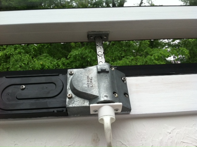

I read about bathroom fans, but the idea of a fan circulating air while in the shower sends a chill to my bones. Thermo-syphon will cause quite a draft when the window is open and soon dries out the room. However we forget to close the window, so a device which will open the window for 15 minutes after the light is switched off would be great. Are they made?

230v window actuator such as http://www.ebay.co.uk/itm/like/301282787153
and a time delay switch: http://www.screwfix.com/p/elkay-columbus-pneumatic-time-delay-switch/68088
Nothing else required.
Actuator has 3 wires - neutral, open, close and they generally have limit switches built in so the motor inside will stop once the window is fully opened or closed.
The Columbus switch is a changeover type, so its line in to the common terminal, with the actuator open and close to the other terminals.
