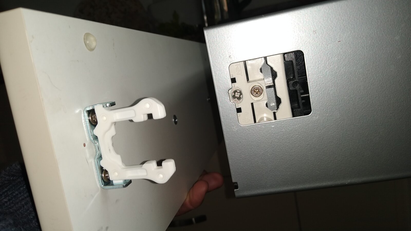

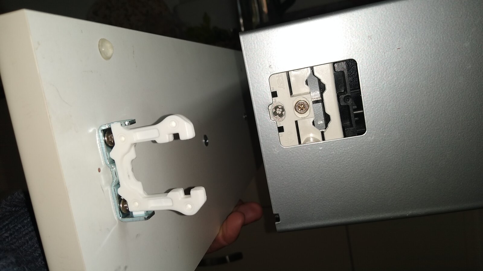

Hi, my kitchen drawer front has come off the screws this morning, but for the life of me I cannot figure out how to get the drawer to release the drawer clips. I'm looking to refit the drawer front.
Does anyone have any idea how to do so? The kitchen was fitted before I moved in so I don't the make, but from research I think it's a B&Q soft close drawer.
do you have any photos , are the runners BLUM ?
Quite a few youtube videos on BLUM runners and draw fronts
Are you asking how to get the draw front off the carcass or the runners
I think its BLUM runners, but the clips for the drawer front don't seem to have release mechanisms like other drawers I have seen. I can get the drawer off the runners but am struggling to remove the drawer front itself.

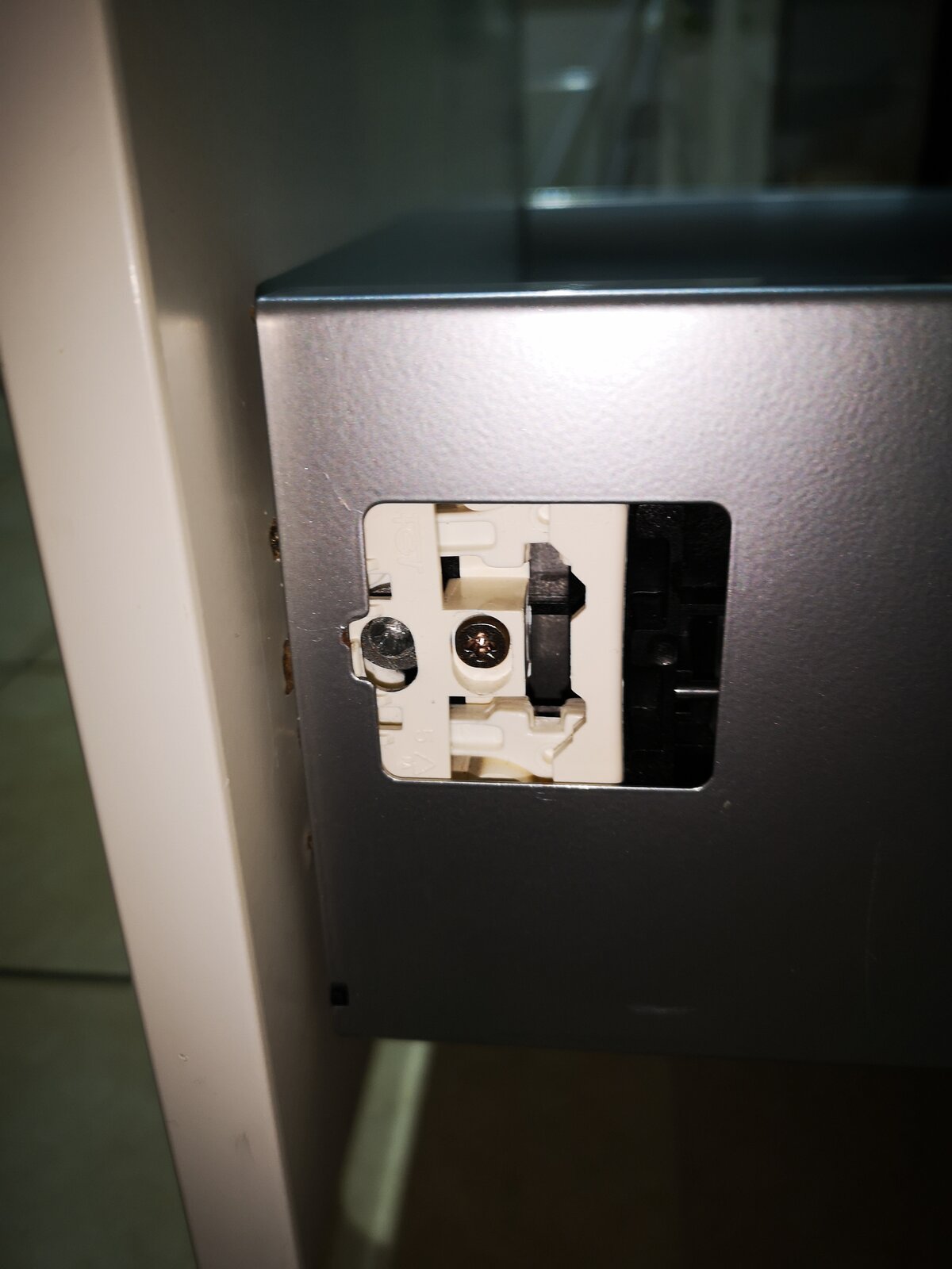

One you remove the square covers off each side , they lock the front on , drawer front pulls out
Worked perfectly, thank you so much! didn't try it before as I thought it was more complicated, you've just saved me from a very expensive fix
