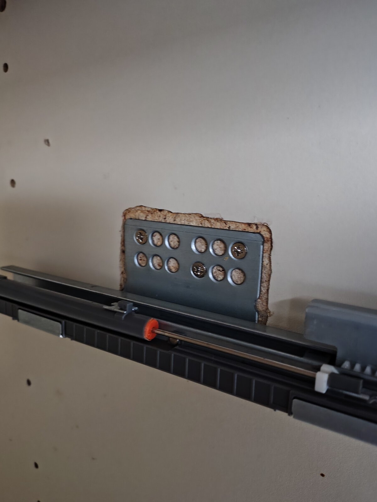

Hi all, I new here so not sure if this is posted I the correct places- i have b&q / goodhome drawers, the smaller drawers are fine but the 800mm have a bit of a drooping when fully extended (obviously I have to much weight in them) so im looking for a heavy duty soft close runner replacement ideally one the would just be a straight swap out - if anyone has ever done this or has any advise I would appreciate it. I have searched but can't seem to find a soto one and im not sure about the fitting on others I have seen.
You will get some some sag in drawers that wide when fully extended IME.
Hi, yes I know and its probably me thats got to much weight in them but I've seen runners advertised that take 100kg fully extended but I don't know anything about the fitment, thats why I was hoping someone may have upgraded and could give advice.
I brought a soto one for a 500 unit - a non Band Q unit and my unit was 3 or 4 mm narrower internally than a B and q ones as it was a thicker carcass. and the self close would not work nicely as it was too tight so I routed out 2mm from each side of the inside face of the cabinet where the soto brackets were.
So make sure the cabinet internal is exactly the same.
Hi, yes the ones pictured is the ones i have now, soto drawers and runners in b&q cabinets - was looks for a heavy duty runners that would just be a straight swap out i don't really want to mess with the cabinets or drawers - i thought soto would have made heavy duty ones, but if they do I can't find them
