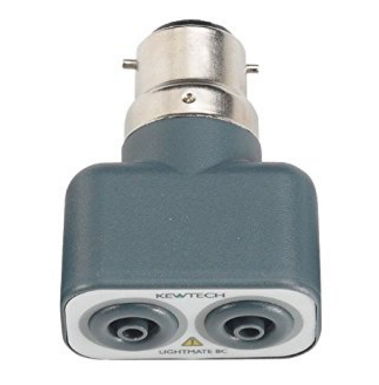

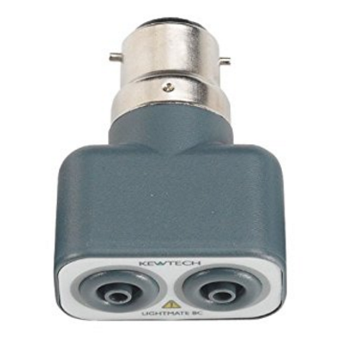

B22/BC to Flex outlet adapter legal?
28 Jul 2012
1,449
64
Surrey
Just spotted the below listing on eBay and it reminded me of the stories my Grandparents have told me in the past about when they used to plug appliances like vacuum cleaners and electric irons into the ceiling lamp holder via an adapter in the 50's and 60's.
http://www.ebay.co.uk/itm/B22-to-Ca...ance-Connection-via-Lamp-Socket-/350848479627
Is the item in the above listing even legal due to the high probability it could be used in an unsafe manor? Yes you could bake B22/BC extension cables with it, but how about when one stupid person idiotically connects something like a hoover up to it?
Regards: Elliott.
He does say maximum 5A - 1200W @ 240V
A Vacuum will likely trip the MCB on start-up although Henrys are only 620W and the others are limited to 900W.
That's what the MCB and all the safety devices are for - to protect people who are doing stupid things.
Knives are legal.
Things like this could be used in an unsafe manner:
Should they be made illegal?
