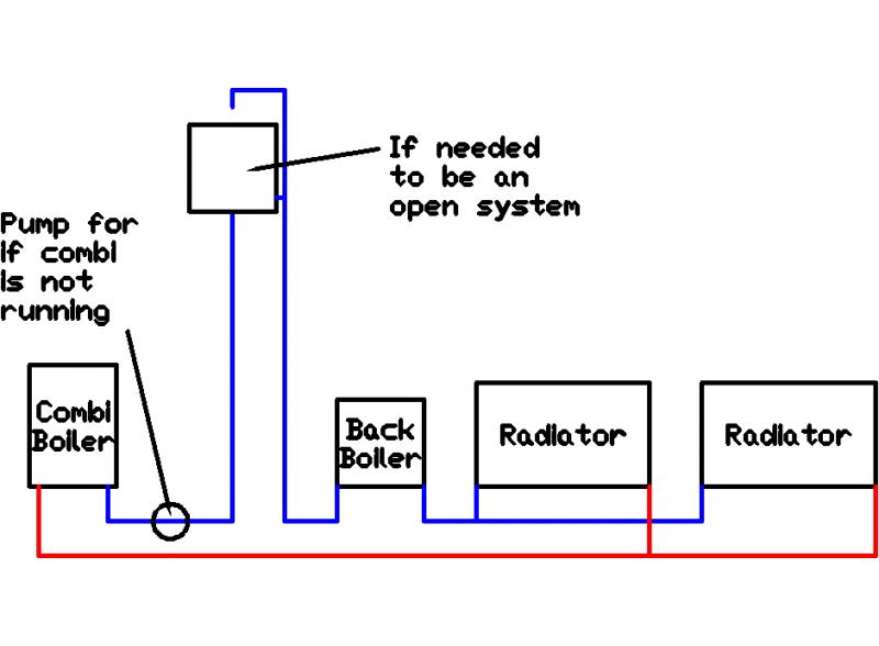

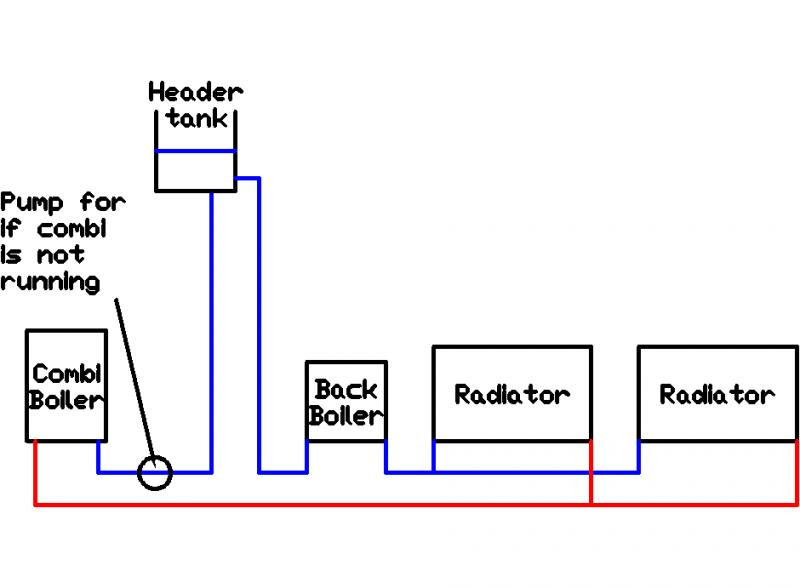

a header tank so that the system is not sealed to alow for water expansion. i guess the pump may have to go before the header tank.
i am a novice and trying to get my head around it lol.
ok look at it again you have the bbu connected to the vent it aint going anywhere fella ;)
and depending on which way that pump is :LOL:
if it was that easy we would all be out of a job ;)
The water is pumped after the header tank through the combi, all the rads and bbu then back to the header tank. would this work or am i just not getting it, can you explain a little more as i dont understand what you mean?
