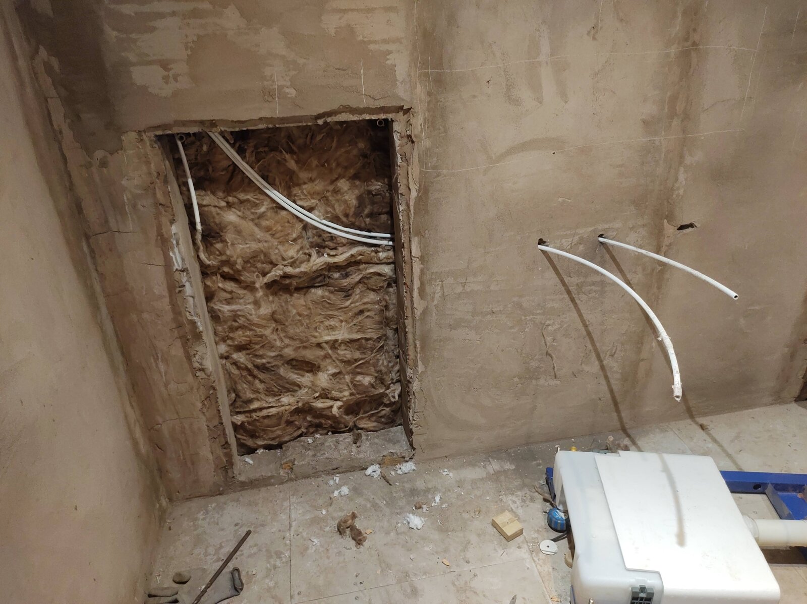

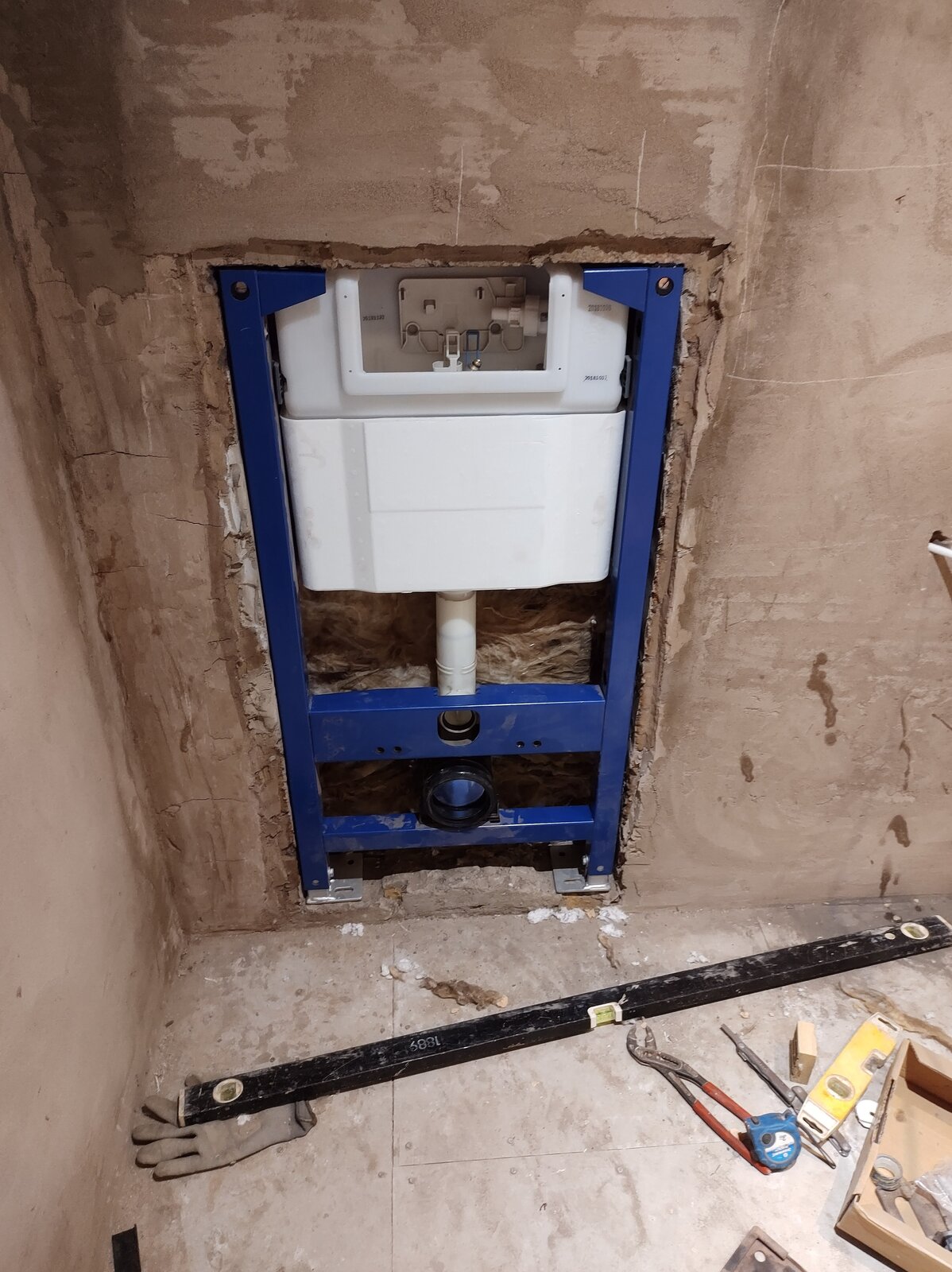

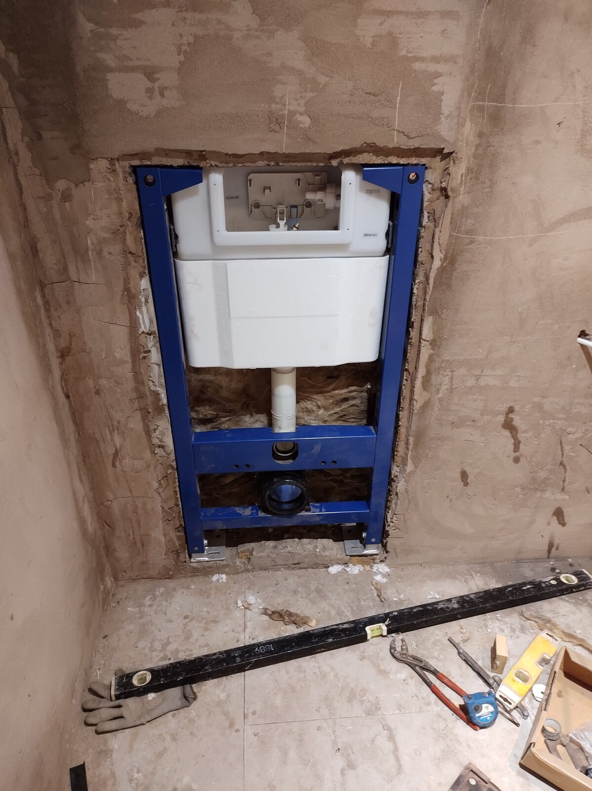

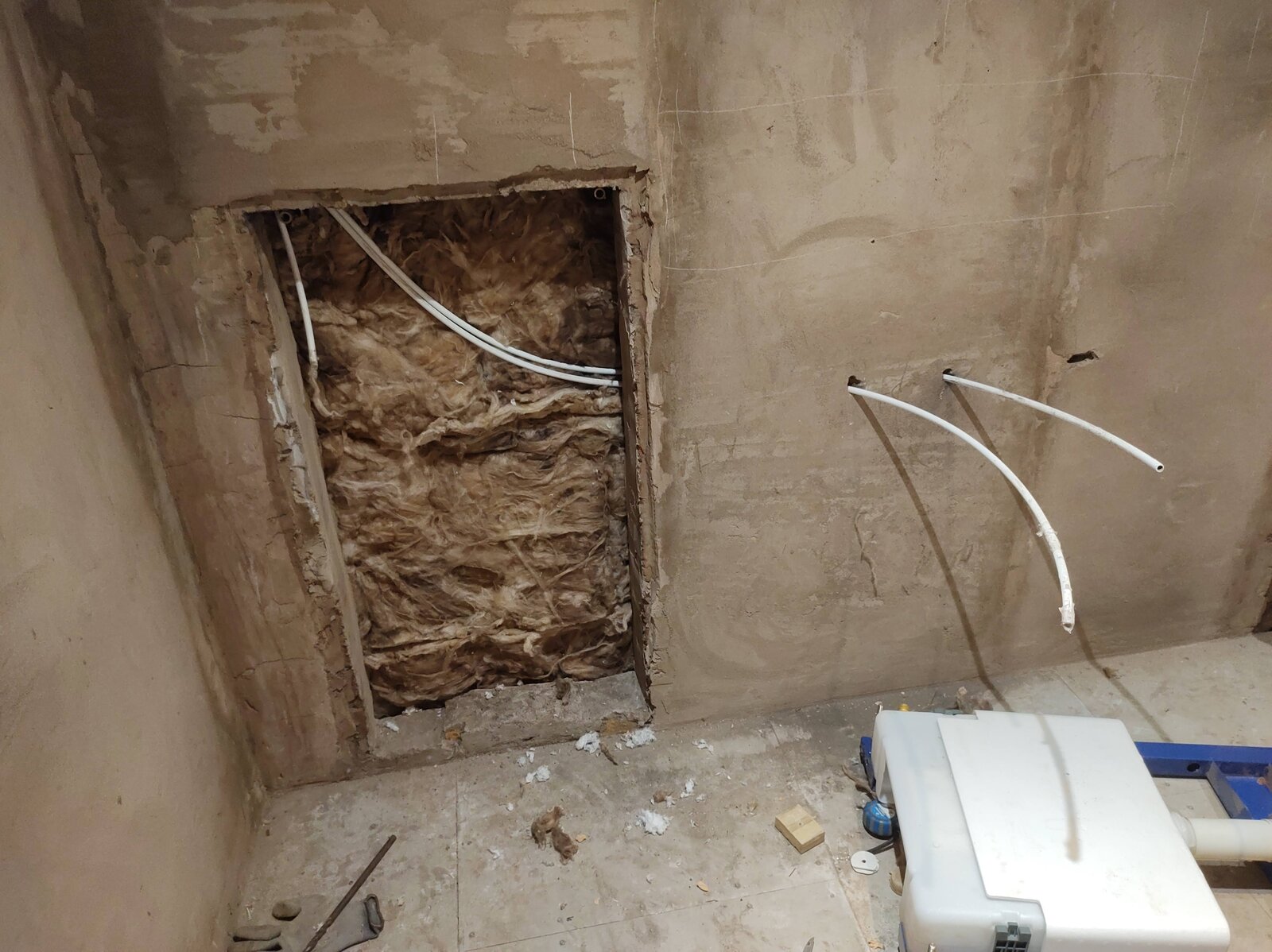

Here's mine, the opening isn't generally an issue but the insulation needs some consideration. A lot of work and only recommend if you have a tiny bathroom (which I have). And if you do go ahead, make sure you pull the entire inlet valve inside the cistern (just remove the backnut) or you'll never at it if it leaks.
Nice work. Yeah my bathroom is tiny 92x159cm

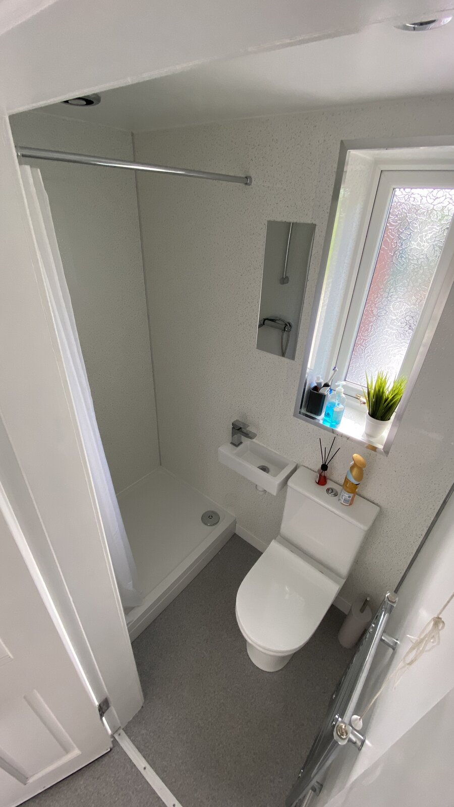

All the shops I've asked said they can't do it. Added an image of my current bathroom if anyone has any more input.
thanks

@cdbe , is that lintel'd?
Unfortunately @nasa777 , the fact that you have a window in there, if that's the wall you want it in, seriously compounds the issue.
Yep that's the wall.
I did have another idea, I found an 8cm cistern and a back to wall toilet that projects 46cm. Could have someone build something to hold the 8cm cistern and do it that way?
my current toilet projects 60cm so I'll be saving 6cm which makes a big difference as I'm tall and have to watch my head as I sit down.
What about a corner toiler. May leave a bit more roof around the sink/shower but can't tell if that would fit next to the rad.
Hey, I did think about that but yeah like you mentioned, the radiators there and it'll probably be more claustrophobic.
I did think about the cisternless toilet from sanipro
has anyone had any experience with them?
Nah. Good strong wall and only 1 floating brick.
