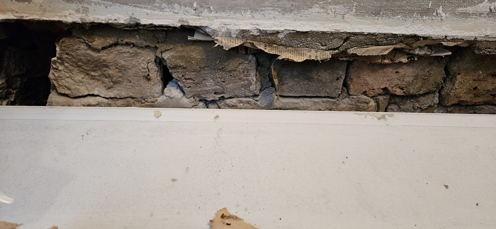

I have a feeling that the bricks are not that robust. If you look at the image I attached, you'll see what I mean. I'm a bit worried that an SDS will crack or break the brick and leave me with a lot of making good to do. If I can cut the brick, I'll limit the potential damage. That's the theory at least.
I did one using a multitool and carbide blade. Worked brilliantly as the cuts were very clean and the backbox fit perfectly. However.... It does take a bit of finesse to get the depth correct and flat for the box to fit flush against/into the wall...blade was dull afterwards, so if I had to do multiple boxes I am not sure I would do the same again. Definitely worth a try IMO if you already have a multi tool.

FYI, the socket in this picture was the one I did with a multi tool. Bit of plaster and then pure brickwork.
make was EZARC (some cheap amazon brand). Can't necessarily recommend this (or any other).. in fact I bought Erbauer a while ago for a different project and they are not much better... so I will be going with a cheaper multi pack and just exchange more frequently. Bit like I do with my headphones.. new set from amazon for 20 quid every 1-2 years...
