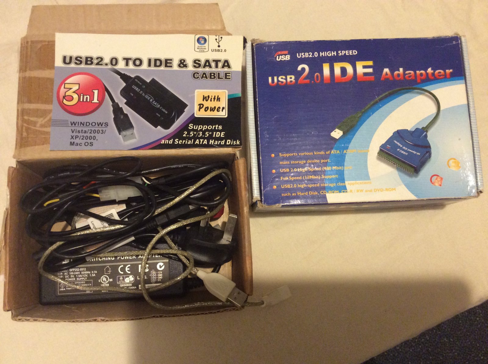

Hi,
I used to be a computer engineer but have forgotten the best ways to do things.
My friend gave me a very old XP Laptop and asked if I could backup the photo's, smash the drive and dispose of the laptop, so I took it away. My first thought was to remove the drive (IDE, fairly simple) and connect it to the USB port of my Windows 10 laptop, I have the cable to do that from years ago, so I did that, my Windows 10 PC makes a noise when I plug the drive in and I can see it in Device manager (2 Partitions, 1 being the manufacturers partition the other being Data), but nothing in File explorer not even a drive letter, I tried to Explore it in Drive Manager but it didn't let me, I can't remember what it said but I couldn't do a lot with it and I didn't want to wipe it.
So, I thought put it back in the laptop and do it the old fashioned way, it was Very Slow (256Mb RAM) and some of the files failed to copy.
So now I'm not sure the best way to proceed, I couldn't remember if Hirens Boot CD would allow me to back up and external drive connected via USB, also I'd like to back up to USB drive rather than CD, I don't think the laptop will do DVD.
Any idea's?
Many Thanks
Steve

Not sure why you trued to explore it in drive manager. That will show the drive and it's partitons but wont show any data. It should just show up in This pc or if you don't have that on your desktop then you should be able to see it in "File Explorer" which is on your taskbar. If that still does not show the data then you should be able to view it by removing the hard drive and connecting it to an external IDE caddy to a USB port.
Connecting a drive via USB whether it be Win 95, Win 98, Win XP, Vista or Win 7 will let you see the data and doing that will not wipe the drive, either of them, providing the hard drive is actually working. I do this all the time without any issues. You may get Win 10 throwing up a warning saying "You do not have permission to view this drive" click continue and all should be revealed. As for using Linux Good grief talk about using a sledghammer to crack a nut.

Agreed, these gizmos are an essential part of kit and should do the job just fine and not too costly.
litl

Yes, That's basically what I have. So I should be able to see the XP IDE Drive in File explorer?
What can I do if I don't?
