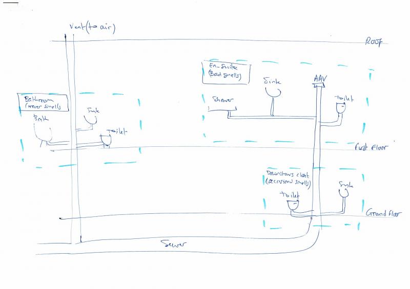

I'm getting really bad smells in my en-suite, mostly originating from the sink. The arrangement is as attached
The AAV is boxed in alongside the cistern in the en-suite and the stack in the main bathroom vents to air through the roof.
I'm running out of ideas how to solve this but I'm considering the following:
1. Extend the stack up into the attic and cap with a new AAV
2. Extend the stack right up through the roof and vent to air (I really don't fancy doing this if possible as I don't know how to seal the pipe through the roof, let alone access up on the roof)
3. Install a HepV0 vertically below the sink trap (I've tried a bottle trap with an air valve but this didn't help)
4. Install a HepV0 horizontally before the stack on the shower/sink branch (i've tried a flap/surge valve on here and it just stopped the shower draining after a while as it became clogged with hair. The gradient on this drain is quite flat with no scope to steepen)
5. Add a branch vent pipe running uphill from the sink waste pipe to the stack.
6. Drill holes in the manhole cover outside
Any ideas on which if any of these I should try (preferably not the second one!).
The sewers outside are all gravity draining and are clear. I had Wessex Water out to check this. We're at the end of the drain line and as far as I can tell there's no venting on the sewer other than the vented stack in our bathroom.
Any advice would be appreciated.
Cheers
Steve
