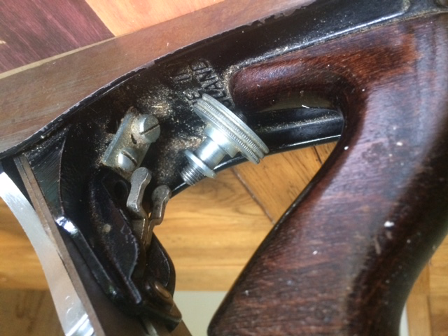

HI chaps, I've got a problem with a Bailey plane. It has a knurled knob you turn to move the blade in and out so setting the depth of cut. This knob runs on a threaded bar about 1.5 inches long, like a bolt only with no head. That bar is screwed into a threaded recess in the back of the frog.
My problem is that when I turn the knob to adjust the depth of cut, the bar turns with it so it comes out of the hole it's screwed into. This only happens in one direction of course, the direction where you are unscrewing the bar. The other way is ok 'cos you are tightening the bar anyway. I've checked that the knurled nut is free to turn on the bar. Unfortunately the hole is only a few threads deep, and there is no obvious way of locking the bar or of getting hold of it to really tighten it. Also no way of holding it still while you turn the knurled knob.
I seriously doubt that putting Loctite on the threads that go into the frog would be enough to hold it. Gorilla glue?
As if that wasn't bad enough, the darn thing is reverse-thread too, confusing me further.
Any ideas please?
Regards from Terry.
Sorry pic upside down & I don't know how to turn it round. :

Loctite really is the way to go. That or a cyanoacrylate such as "super glue" or any of the mitre bonding adhesives (Mitre Mate, etc). Gorilla Glue will just get everywhere. I'd advise against Araldite or any other epoxy in case you ever need to replace the stud

Could you take the knurled knob off, find some appropriately sized nuts (may be difficult!), and lock them together on the bar to screw it back well into the threaded hole?

The problem with Stanley and Record planes is that they used some seriously odd size threads which aren't over the counter sizes. For the record the depth adjuster thread is 9/32in 24tpi American/Unified left-hand thread on Stanley & Record planes prior to about 2004 when Stanley at least went metric - the OP's plane is British made and has a beech handle, so post WWII and prior to the mid-1970s when Stanley switched to plastic handles, whilst the bent metal (sorry, stsmped and folded steel) 2-piece adjuster yoke as opposed to a one-piece cast adjuster yoke probably makes the plane sixties or later). Also, you don't want to reduce the amount of travel of the adjustment nut - with some cap irons you need every millimetre of adjustment to get the blade backed-off into the body

Yeah, RandomGrinch, I thought of locking 2 nuts and giving it a good tightening, then remove them and put the adjuster back on, but I didn't know where to get nuts from or how to cut threads in undersized nuts. JobAndKnock says the threads are pretty odd. I also considered filing flats into the stud on 2 sides leaving threads on the rest of the circumference and using a tiny spanner.

Part of the problem was also probably a mis-op on my part, having overtightened the screw that goes into the kidney-shaped hole in the clamp which locks the blade and chip breaker into place and really having to force the over-centre lever down. So the blade was being held too tightly..
I got a bit of force onto the stud with pliers and a bit of cardboard to protect the threads, and I've not over-tightened the screw on the clamp. I'll give that a go then try some loctite if it still plays up.

One other thing to try which I've seen on a number of old tools is to file, saw or grind (with a Dremel) a slot in the outer end of the threaded stud so you can get a straight screwdriver onto it. Just be careful about overtightening the stud as it is going into the cast iron frog and is isn't too difficult to strip threads
Yeah I wondered about a slot for a screwdriver too. Just tried it and it seems to be better - i.e. useable - poss because I haven't over-tightened the clamp thing.

Nah! It won't hold its setting, and the stud unscrewed again anyway.
I'll try some loctite and report back.

Anyway, that Bailey plane. I sharpened the blade. Then I tried some loctite on the threaded stud as per JobAndKnock's suggestion. Then I used pliers with 2 bits of balsa wood to protect the threads and tightehed it. It seems sort of ok. Problem is, it's not easy to actually see if the stud is turning. I'll try a dot of enamel on the end of it so I can see the problem coming.

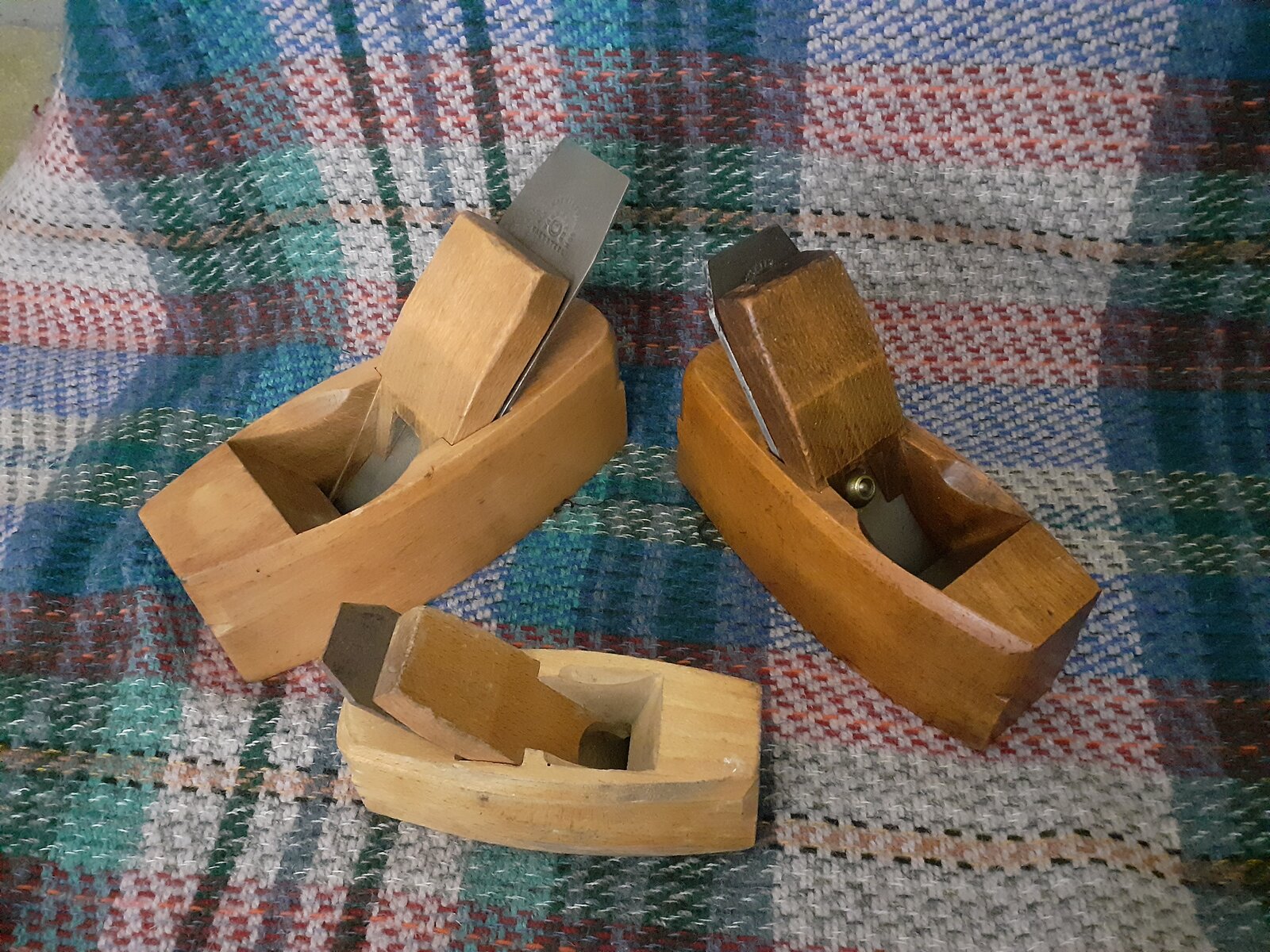

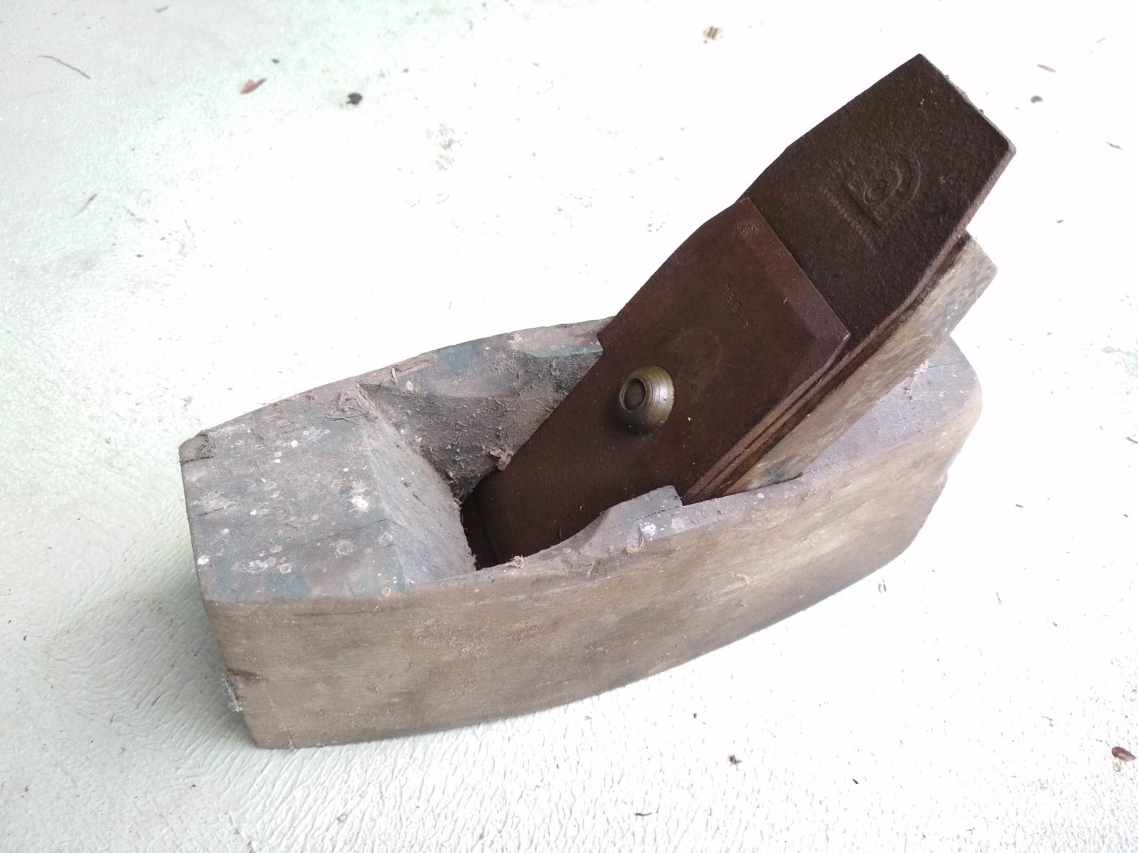

It's a coffin smoother. Like one of these
The two big ones are a 2-3/8in one (left) an a 2in one (right) - little one is a 1-1/2in Marples which would be either a training (school) plane or used like a block plane is these days, and yes that is a worm hole on top of the cheek, but I doubt that the little buggers (if there are any left) have survived 2 minutes in the microwave. The difference between mine and this one:
is that mine are in working order and sharp. If you buy one you will quite probably need a bench with a vice and a sharp, well tuned metal smoother to fettle the woody as you may well end up having to true the sole and adjust the wedge (as well as deal with woodworm) before you can use the plane. Things to look out for and avoid include large cracks in the body, blown cheeks (where the wedge has been hammered in too enthusiastically and cracked the side of the plane), badly scored soles, very wide mouth (indicating excessive wear) and pitted irons/cap irons - TBH none of these is easy, nor worthwhile, to fix
Get a good one, though, and they are quite pleasant to use once you get the hang of how to set the iron using a nylon head hammer and a bit of patience.
