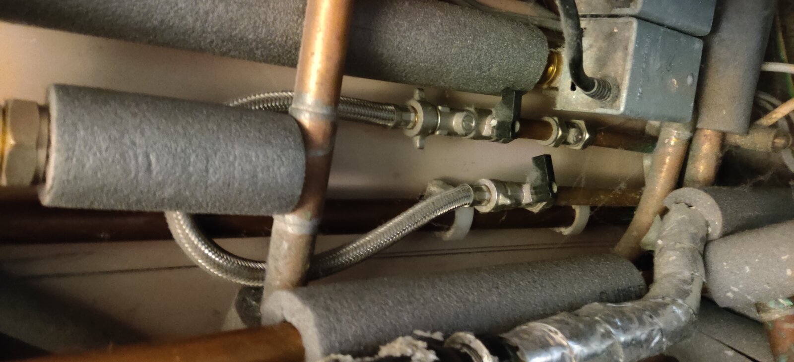

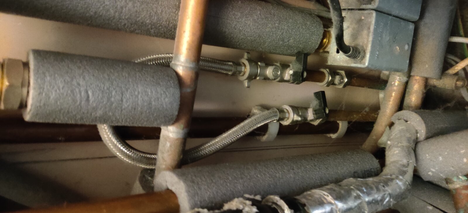

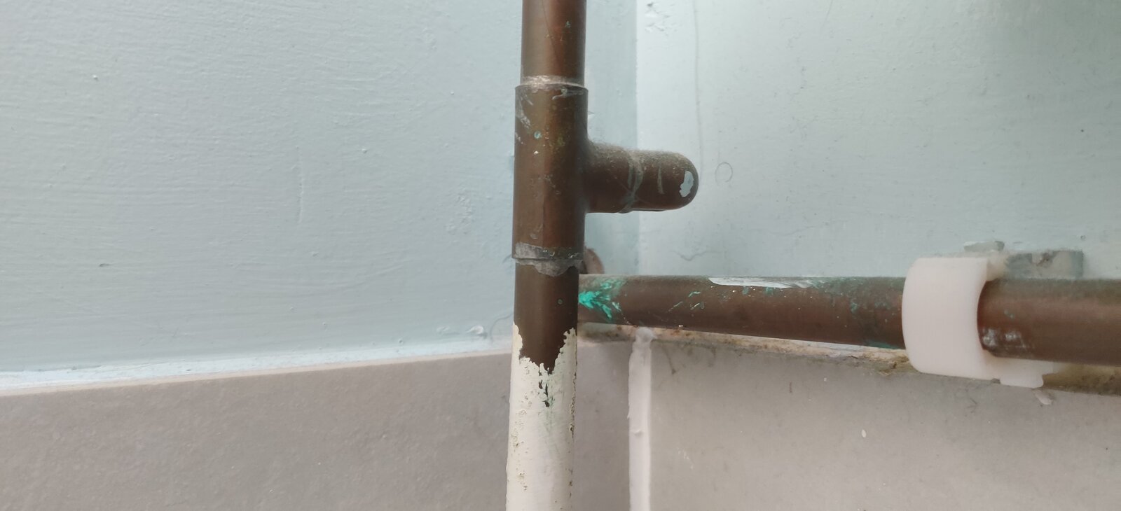

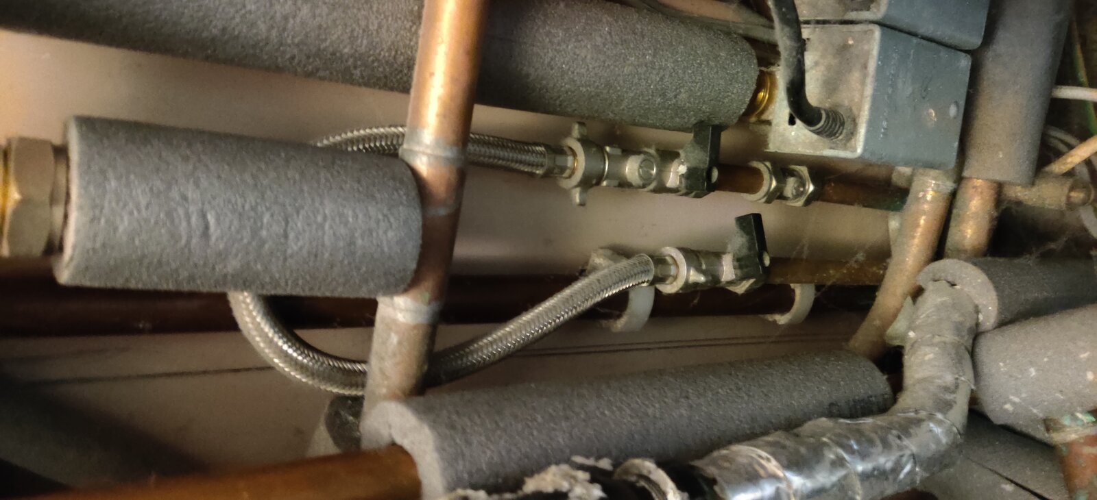

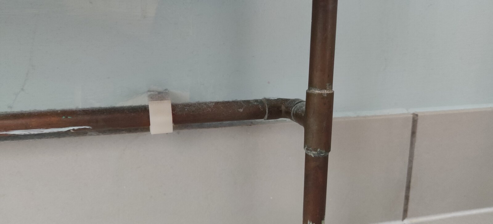

  8. To avoid running a separate flow and return from the boiler to the loft (would have required extra chasing), the plumber suggested we "T" off the first radiator in the system in the main bathroom to extend the system into the loft.

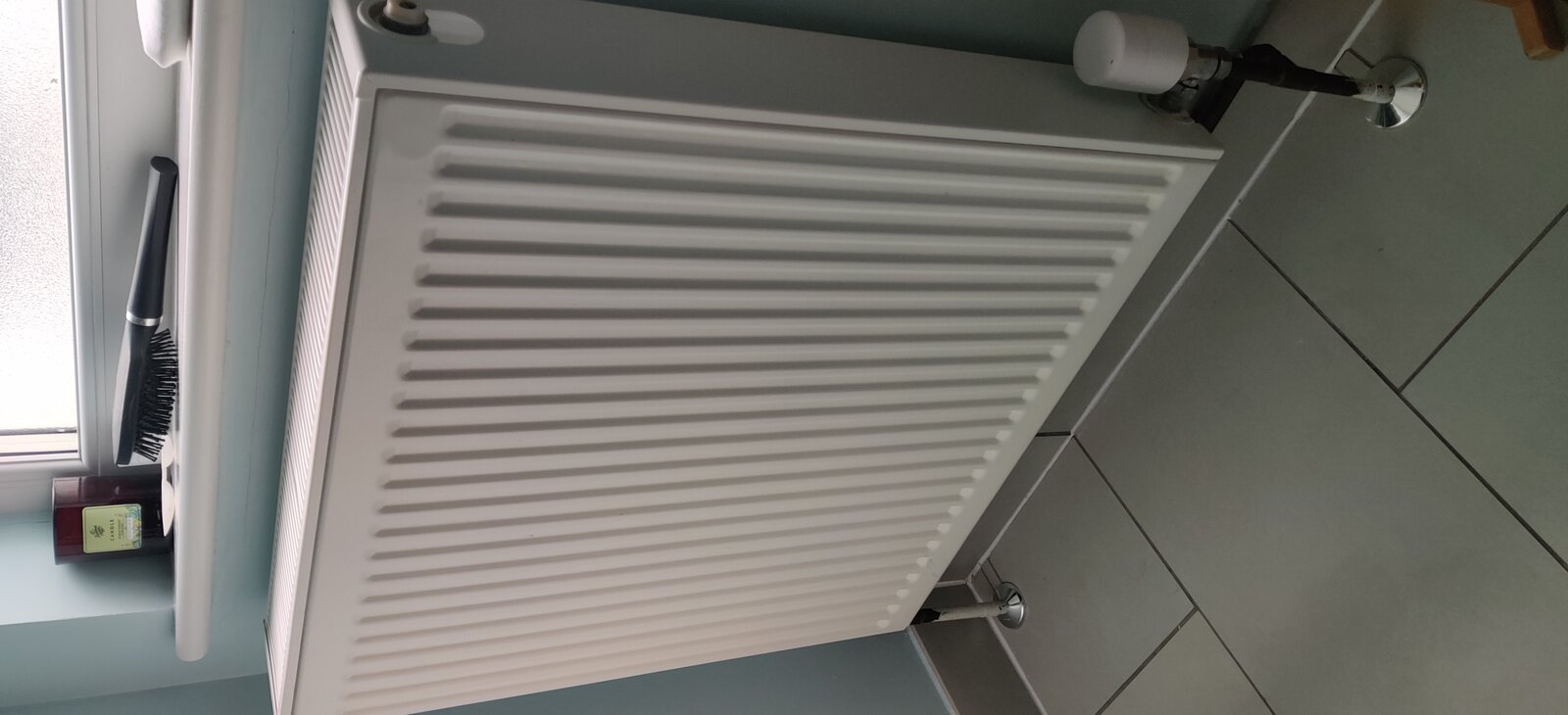

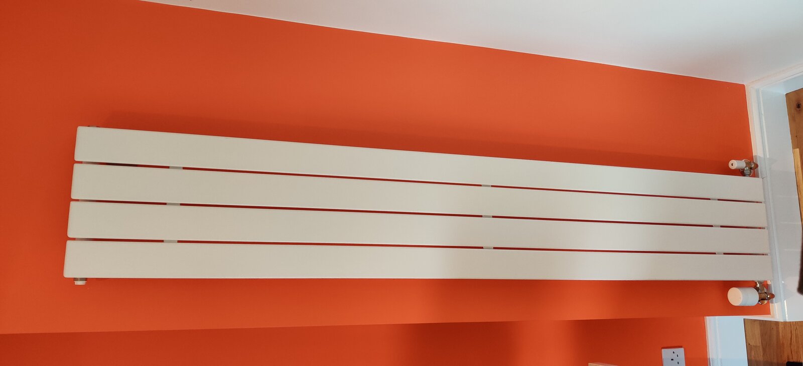

  9. The loft radiators (there are two - one in each bedroom - loft is about 25m2) are single vertical radiators

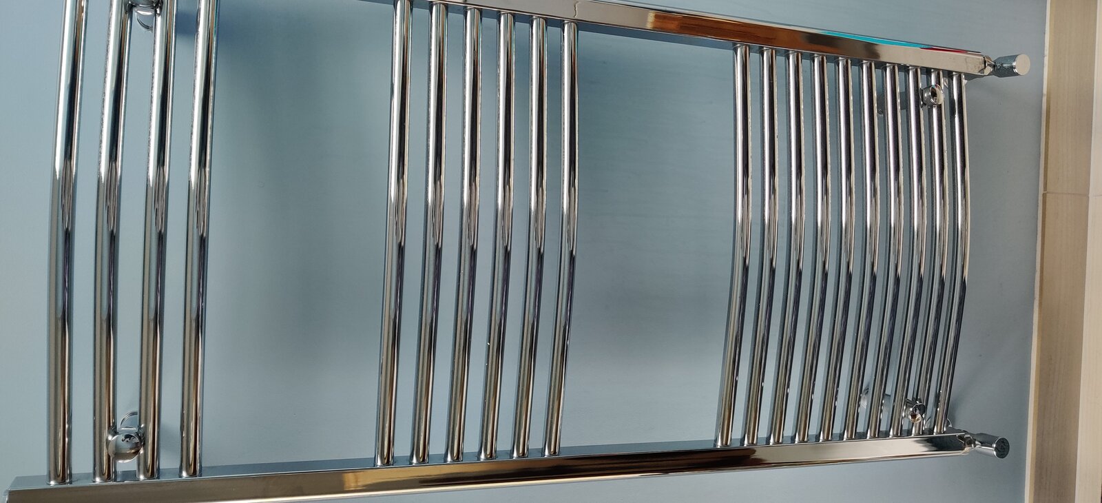

  10. There is a towel radiator in the bathroom which doesn't have any clear valve and lockshield valve and doesn't have a Tado Smart TRV (I read at least one radiator should not have a smart TRV to avoid the system overrunning if all TRVs were off)
  11. If I open both valves on the towel radiator, it heats up to the point of being too hot to touch.
  12. For the loft radiators not heating, the lockshield valve is opened fully and I have put back on the manual TRVs and put on max but still only lukewarm.

  1. What impact if any does the "T"-ing off the first radiator have on throughput to the loft, if any?

  6. Is it possible that the system pressure of just over 1 bar (still in the green range) is a contributing factor? I doubt it is, as the towel radiator in the loft gets very hot. Should I top up the pressure - I think it gets done by opening both ends of this flex to let water through for a period. System was only serviced in Oct 21 so plumber would have ensured that was at the right level.

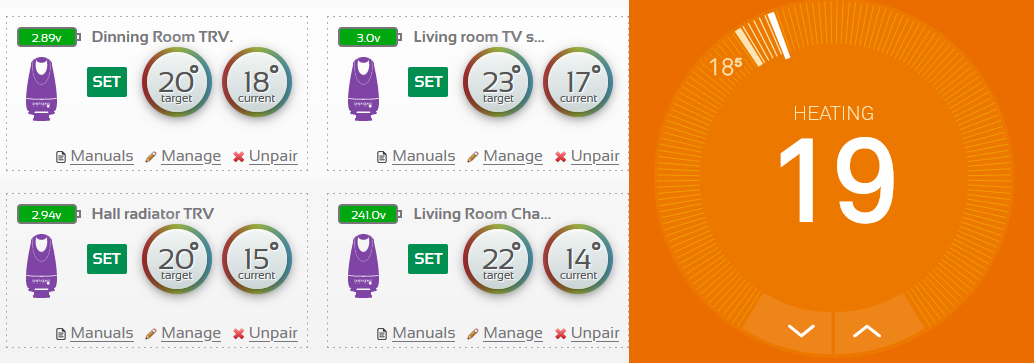

I know one should use a differential thermometer to set the lock shield valves, but could not find it, so started by turning off each lock shield valve waiting for pipes to cool, then ¼ turn at a time back on until just a little warmth in feed pipe.
This resulted in all radiators working, but what I then realised was speed is critical. It takes around 3 minutes for the TRV to move from fully open to fully closed, if in that 3 minutes the radiator gets stinking hot, it starts a hysteresis so it is important no radiator heats up too fast.
The TRV shows current and target, Heating not keeping up.jpg as does the wall thermostat, the aim is to ensure current does not exceed target, clearly at times the current will be below target, and once the rooms where current exceeds target are trimmed, you may need to open those below target a ¼ turn.
But adjust rooms which are over temperature first.

Teeing off that 15mm isn't ideal but it should have enough thermal capacity to run 3 rads. Of course if the bathroom rad is itself teed off a 15mm leg that gets more interesting...
Do you know how convoluted the run to the loft rads is, are there any kinks and sharp bends likely to be airlocked thus reducing the flow to upstairs?
Manufacturers installation instructions.

First thing to do is find the manufacturer's info for those vertical rads and make sure they've been plumbed in the right way round (there are internal baffles so it does make a big difference). After that start looking at more subtle stuff.
By the way, don't assume that because you paid someone to fit them they will definitely have done them right- everyone makes mistakes!
The installing plumber was competent and no concerns. But I've also had my very competent plumber who services the boiler every year check it out a while back and nothing untoward was found.
Would having them installed the wrong way around make them work badly or not at all?
These are the radiators https://www.traderadiators.com/trade-direct-nevo-designer-radiator-white-1800mm-x-272mm The documentation doesn't suggest any way round for installation, but the TRV is on the left which matches the photo on the page.
The radiator is 2,000 BTUs which might be a little under spec'd but only a couple hundred BTUs. I guess my main problem is I can't even heat a slightly small radiator, so the size of the radiator for now is a moot point.
Also, I've realised my towel rail has two manual "lockshield-type" valves. When I turn them both to the max, the towel rail gets very hot. But if I want to set it to pass through a reasonable amount of flow (given it's quite far from the boiler at this point), how do I know which to open maybe half way?
teeing off from an existing radiator, to feed those designer radiators, was always going to be a bit hit and miss
Open the inlet fully.
Open the out 1/2 turn only.
