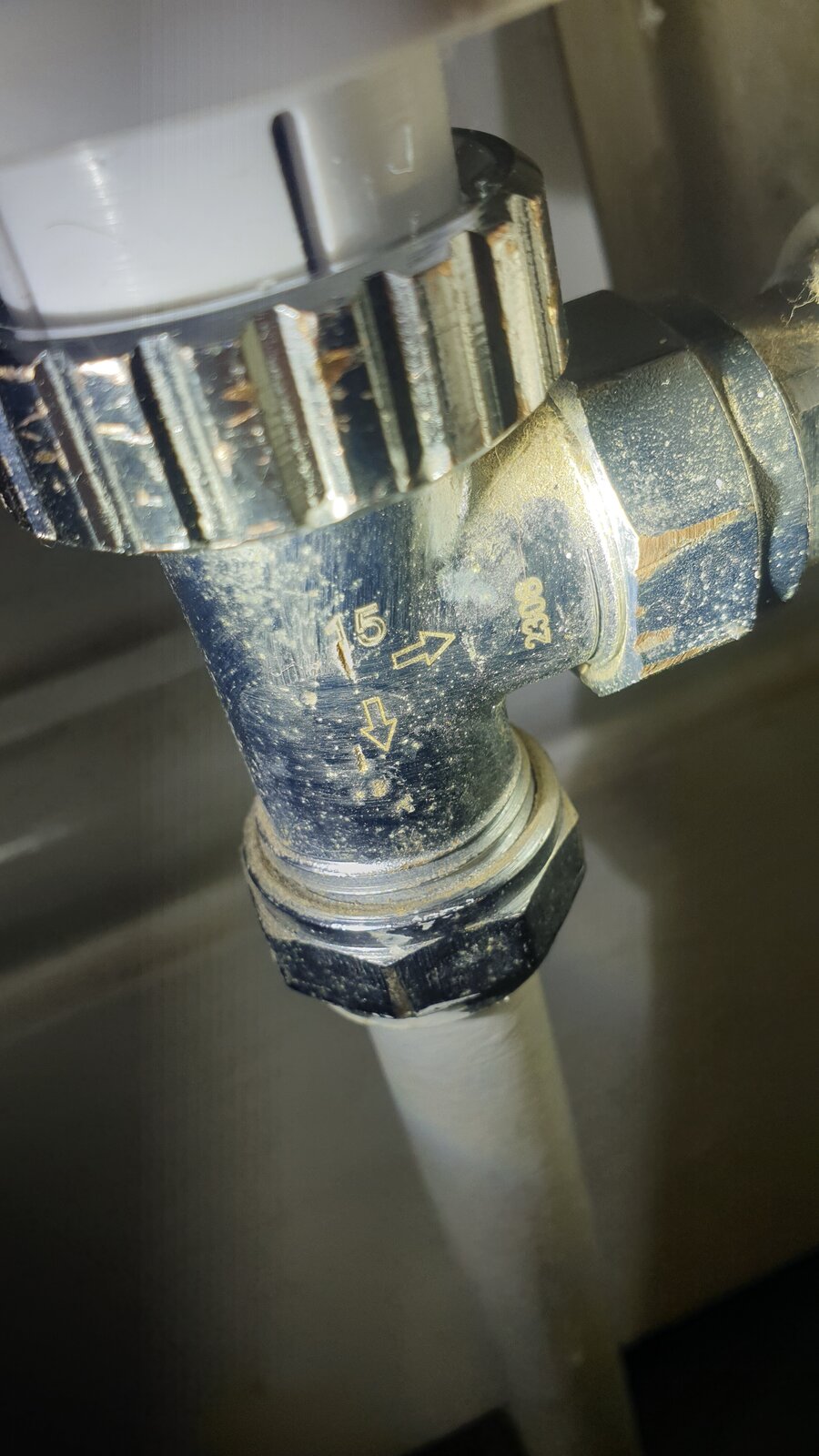

The TRV would be set to fully open on all rads when balancing the system. The lock shield valve is used to balance the system.
It doesn't really matter if TRV is on the flow or return pipework as it's almost certain to be bidirectional.
Check the body of the TRV's, should have 2 arrows to show this , do they ?

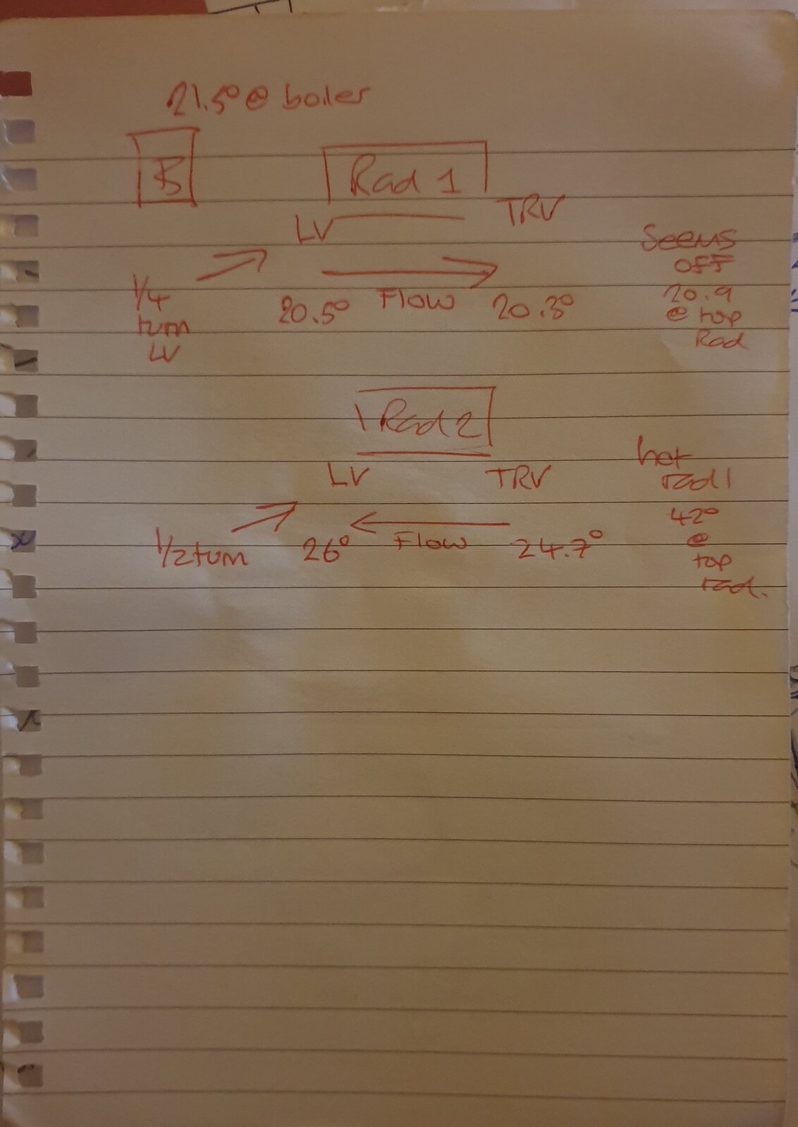

In a diagram is what I have for the top floor on the first two radiators. This as it is after 1 hour of messing about. both radiators now set to three.
I'll do if you say regarding the full balancing tomorrow. It's very hard to find the exact sequence but I think I have it roughly.

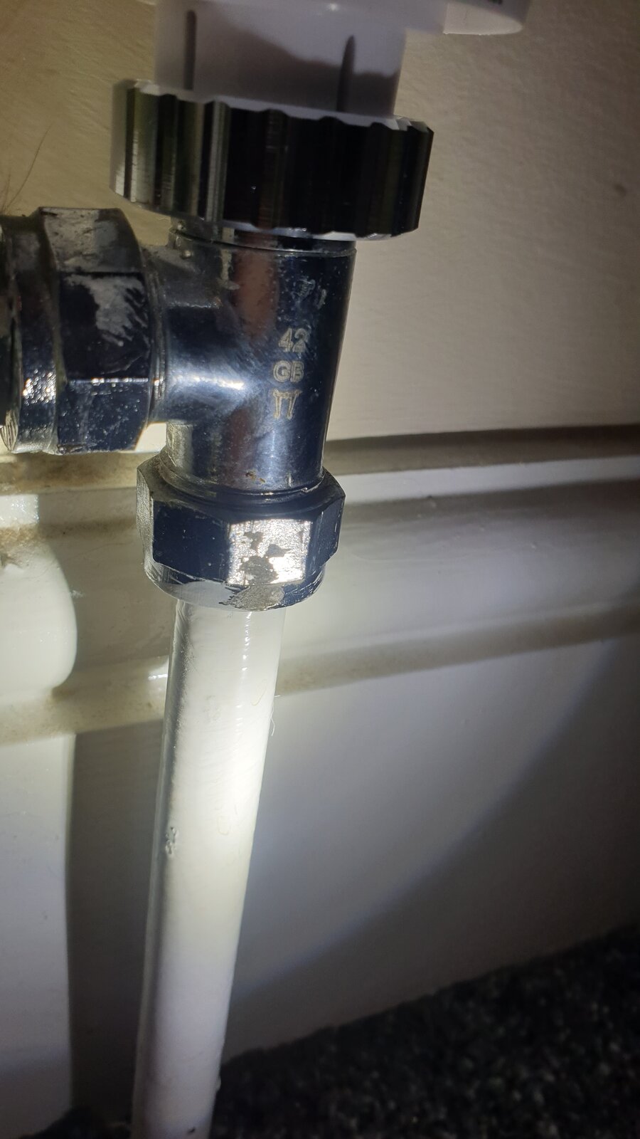

ok iv had a look for arrows.
the two top rads 1&2 as per diagram have this image . 1st one. I can't see the other side of there are arrows. but no two arrows.
3 down stairs have the two arrows as per picture no 2
The remaining two downstairs one in the front window doesn't have an LRV.
The last one in the chain I think is in a new downstairs bathroom and again can't see any arrows.
