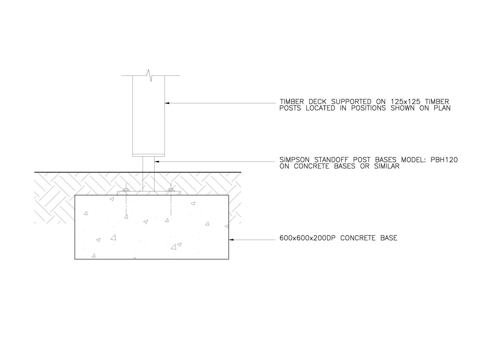

I am adding a self supporting balcony to my house. It will basically be a large 6x2m raised deck.
I'm planning on placing 4 or 5 150mm oak supports on the outside with a 6m 6x2 attached to house via either resin bonding or masonry bolts.
What type on foundation do you think will be required for the oak supports? BCO it coming back with 1m3 which seems a bit overkill to me?
Ground is basically 600mm clay then hitting shale.
Thanks for advice.
Unless you pay for an SE to prove otherwise then you are best off going with the advice of the BCO. It's a fairly generic go-to standard foundation for a point loaded column. Look at the savings (or not) of either method. An SE might just end up speccing the same.

Doesn't seem silly to me, the forces on a ground level platform are smaller and if it collapses or moves the consequences are less bad.
Don't forget that when you ask an SE to design something he is insuring against anything disastrous happening. Suddenly a couple of bricks to spread the load doesn't seem prudent to them as they're not paying to build it, only if it fails.
1m3 is bonkers, this was the last one I submitted to BC and was approved (without SE intervention):

Correct. The taller the column the greater the exaggeration the movement will be (at the top) should the foundation decide to tilt. However, 1m cube per hole is a lot of digging and a lot of conc.
