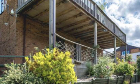

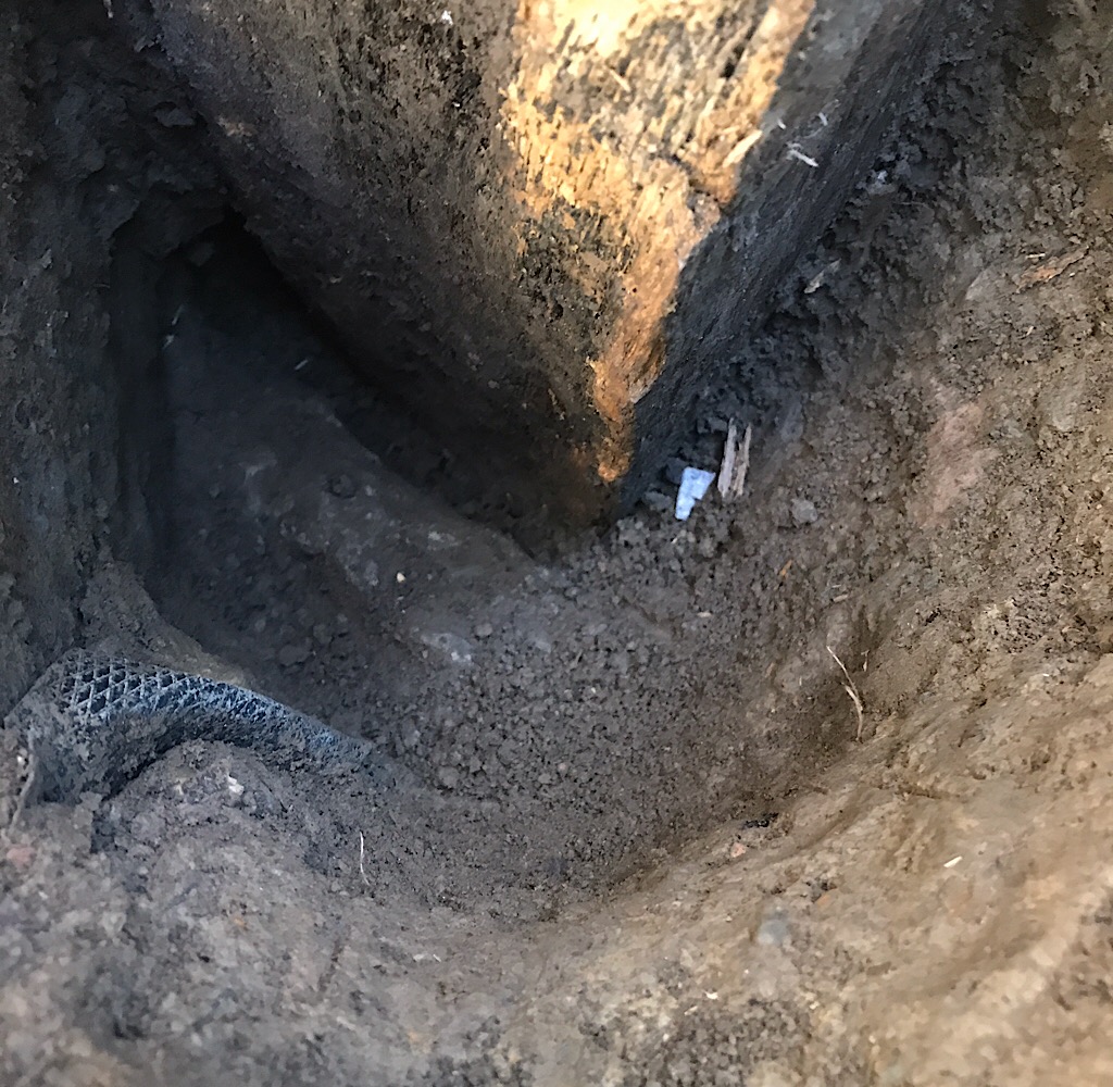

I have a balcony on my house which is supported by 4 8x8(ish) oak beams. These are buried in to the ground. However I can see that they are rotting where they meet the soil. I have also started to dig down and can see this is the same below. As would be expected. See pictures. Ideas to resolve?
Pull down and start again? Dig down to concrete footings and attach steel sleeves up three sides? Any other suggestions?

four posts suggest a deck not a balcony - can you post a pic showing the whole thing?
can you tell if the "balcony" is cantilevered out or pinned to a ledger?
probe the signs of rot to see if its surface damage or deep rot.

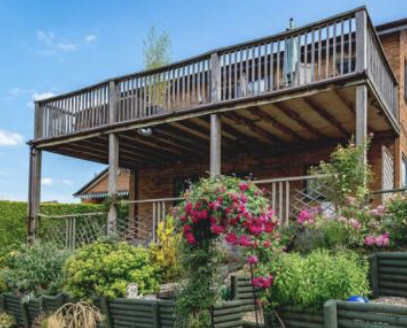

Deck/Balcony I’m not sure. It is approx 5 meters high off the ground and measures 5.5 meters x 9.5 meters.

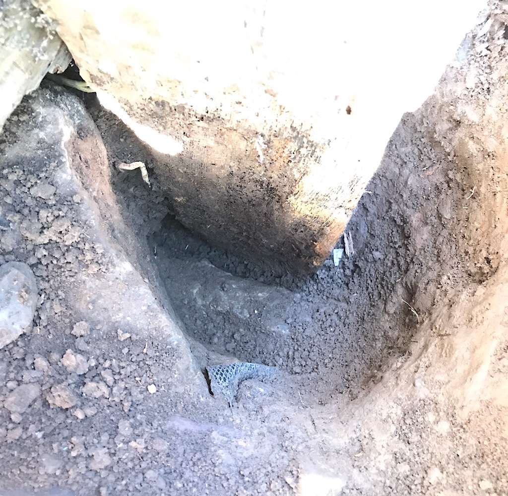

So far I’ve dug holes out down around one of the beams to the concrete they seem to be set in. So far it looks like surface rot. I’m hoping the others are the same.
The plan I think is to get some steel L shaped brackets made and to secure these to the concrete and also to the beam around 1.5-2 meters up. This will be done one 3 sides of each beam. I can’t get to the back side of each beam so can’t do all 4. Or does this sound a bad idea?
Posts quite often rot at ground level first.
Is it just surface rot, can you easily push a nail into it? My guess is it may only be the top few mm.
How long have they been in the ground?
Your brackets may help, but one side will still be exposed.
If you have this bracket applied, you need to ensure water cannot get behind it, as all you’ll be doing is trapping water behind it.

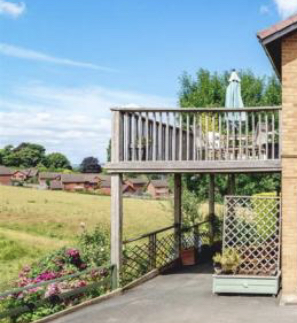

Hopefully from the photos you can see what I mean. The 4 vertical posts are set in the ground and just have earth/soil around them up to around 18inches high. This is obviously where they are rotting as they are in the ground.
Should I remove all earth that’s touching them and make some sort of barrier around them that stops anything from touching them I.e. water/soil? Together with the brackets? Should I get a structural engineer in to have a look?

Hard to make out how 'good' the deck has been built.
But you've uncovered some rot, but we don't know how bad it is, could just be on the surface. Does the structure feel safe when you walk on it?
Looks like the posts have just been plonked in the ground, they should be concreted in (perhaps they are lower down?)

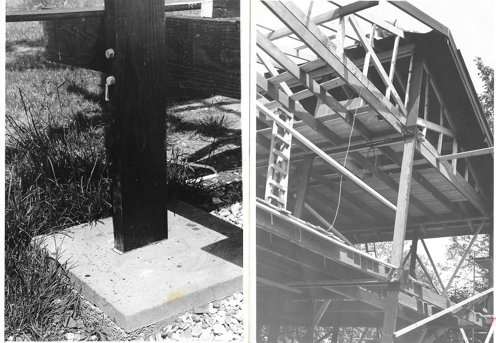

An alternative is to create pad foundations and stand the posts on a piece of 4 mm thick sheet lead. The post is not fixed to the pad in any way other than by the weight of the summer house. Two coats of Sadolin Classic protects the sides of the post and the lead presses into the end grain to seal it from moisture ingress. The lead should be trimmed to the same size as the post to prevent water pooling on the tip of the lead.
Any movement of the post caused by shrinkage of the timber frame is allowed for by the the post not being rigidly fixed to the foundation.
This is one we did in 1980, the ends of the posts are still in perfect condition. ( lead was trimmed after the photo was taken )
post-and-lead-jpg.147883

I’ve dug down around one post so far and got to the concrete that it’s set in. There is signs of rot on this post but seems to be only on the surface. I’ve poled and prodded and seems quite solid.

An alternative is to create pad foundations and stand the posts on a piece of 4 mm thick sheet lead...
I thank you BernardGreen for sharing that post on that thread and I can only recommend that solution to your problem @Genista. In the end I didn't build the summerhouse -- I decided to go for decking with a gazebo over the top. I was lucky enough to buy a sheet of lead from a neighbour taking it from their front door shelter to build a porch.
