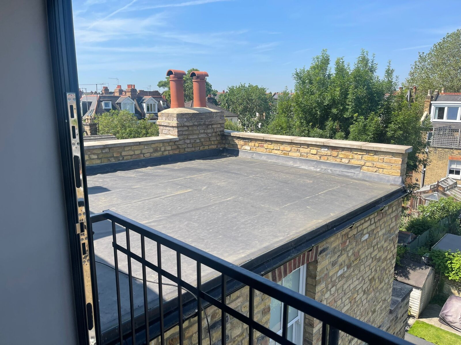

I'm thinking of installing a wire fence for this flat roof. I just want to put a few plants out there and give access for watering. What is the best way to secure max 1m centred posts for the side with guttering?
Initially I thought about a metal beam attaching to the far brick wall, but then it might make it hard to repair the roof when needed. I'm looking at balustrades, but they all go straight up from the wall they are attached to. I would need something that goes around the guttering. Any suggestions?

I expect you'd need something bespoke to overcome that, unless you went for something very simple like keyklamp or similar where I daresay you could cobble together a cranked handrail out of the various components available. BTW you know you'd need planning permission for that?

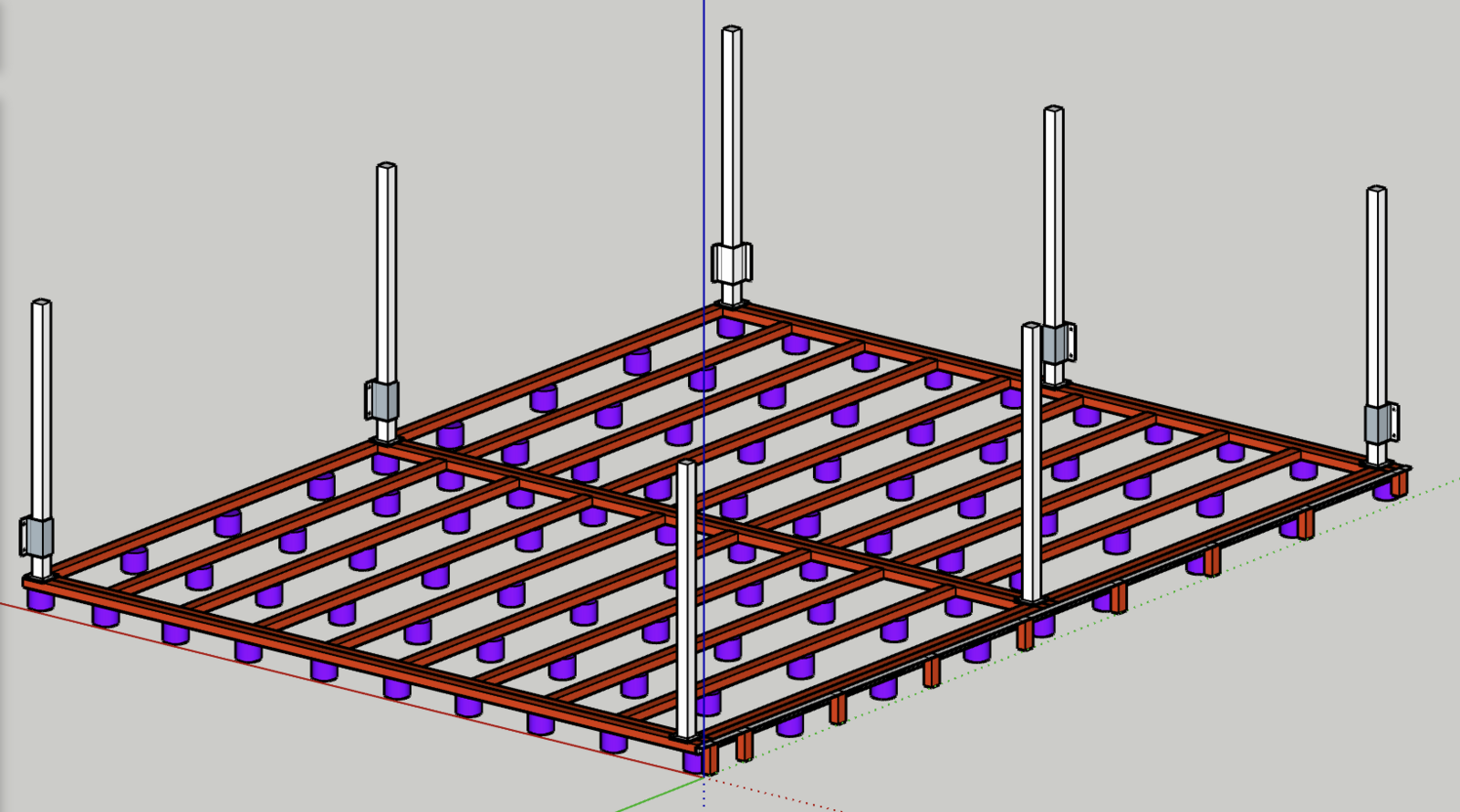

I have attached the diagram they provided. 32mm alluminum joists, doubled up at the point that posts will be positioned. There is plate that goes under the frame and each post bolts into it. Where brick wall is available you can see they are providing fixings that secure the post to the wall. 3 different sizes of pedestals are given, to mitigate the slope roof. Rubber pads are provided to protect the EPDM roof from he pedestals.
The side without a mid post is the entrance. To the corner right is a post without a wall wall clamp, we will need to figure out how to attach that to bolts that will come out of the dormer timber.
I hope that is enough information to help others?

My installer was just asking me that, he has asked me to confirm on the middle post that doesn’t have wall support. He wants to put in an additional 45 degree arm support for that mid post. So I might end up doing that as well. But speaking to the suppliers first.
