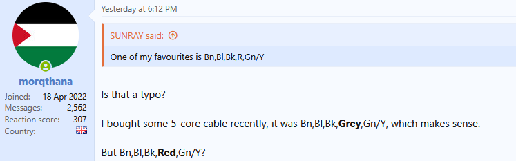

Is that a typo?
I bought some 5-core cable recently, it was Bn,Bl,Bk,Grey,Gn/Y, which makes sense.

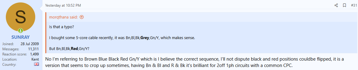

But Bn,Bl,Bk,Red,Gn/Y?
No I'm referring to Brown Blue Black Red Gn/Y which is I believe the correct sequence, I'll not dispute black and red positions couldbe flipped, it is a version that seems to crop up sometimes, having Bn & Bl and R & Bk it's brilliant for 2off 1ph circuits with a common CPC.
"Should be", surely?
Brown ↔ Red
Blue ↔ Black
OK.
I'm curious though about how it came about.
When black & red would have been the colours for N & L in a single-phase circuit, the colours for the other L phases would have been yellow & blue.
When blue & brown became the colours for N & L in a single-phase circuit, the colours for the other L phases would have been black & grey.
Who introduced your Brown Blue Black Red hybrid, and why?
And given that you have to oversleeve black & red anyway, why can't you oversleeve black & grey with no more effort?

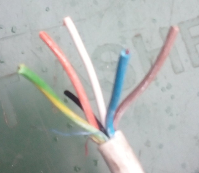

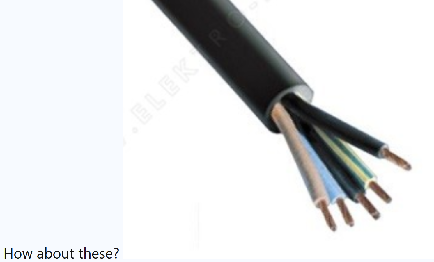

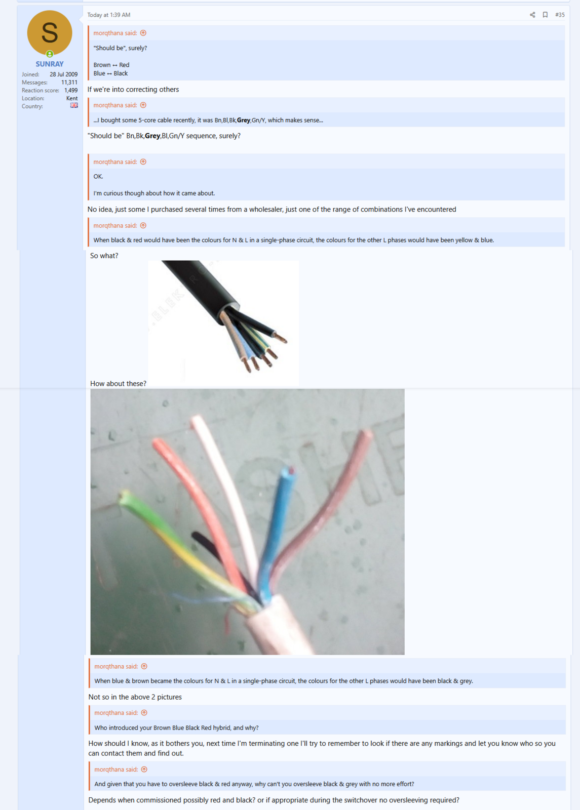

How about these?
Not so in the above 2 pictures
How should I know, as it bothers you, next time I'm terminating one I'll try to remember to look if there are any markings and let you know who so you can contact them and find out.
Depends when commissioned possibly red and black? or if appropriate during the switchover no oversleeving required?

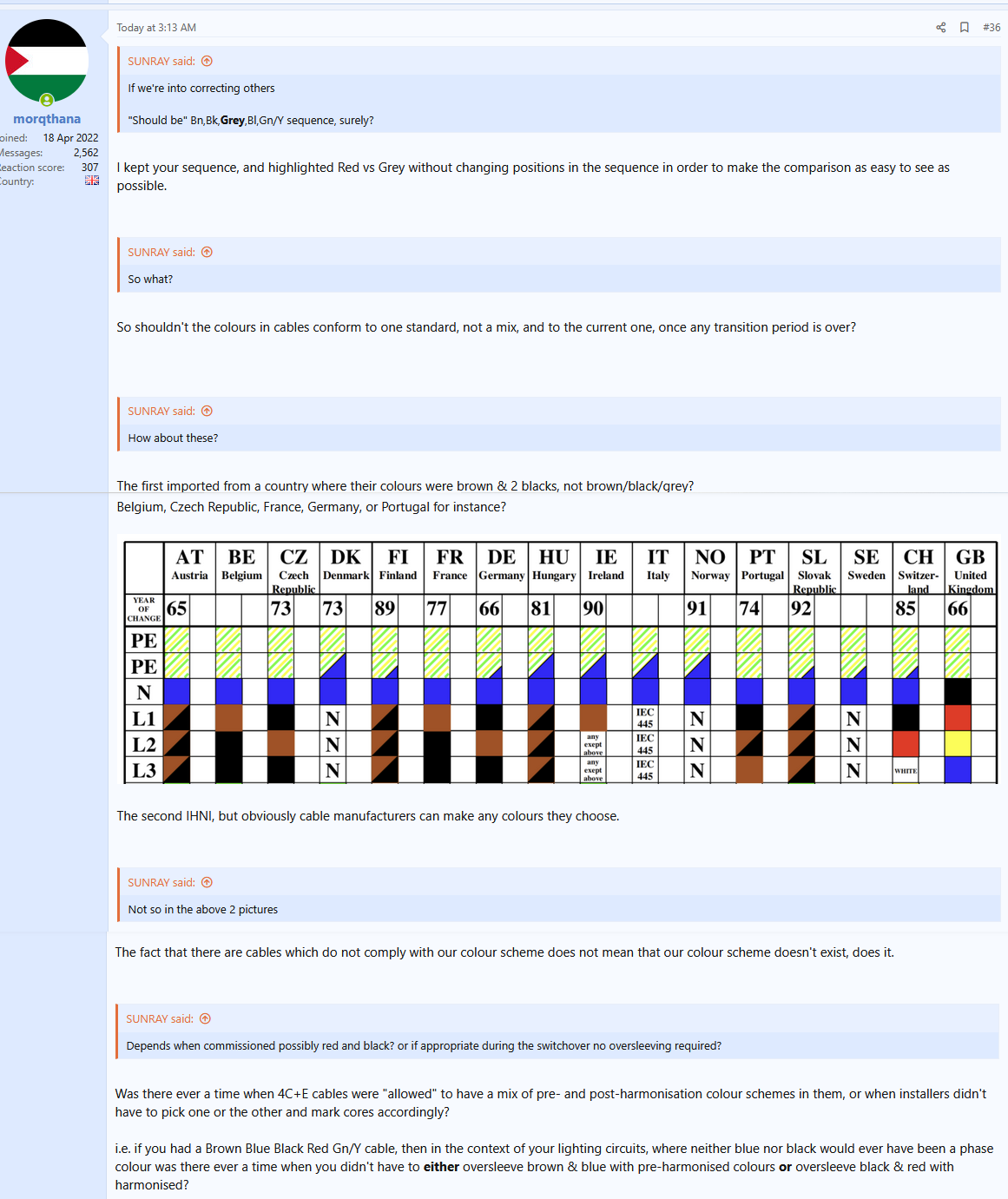

I kept your sequence, and highlighted Red vs Grey without changing positions in the sequence in order to make the comparison as easy to see as possible.
So shouldn't the colours in cables conform to one standard, not a mix, and to the current one, once any transition period is over?

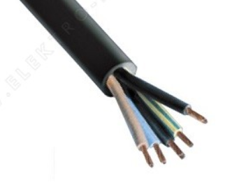

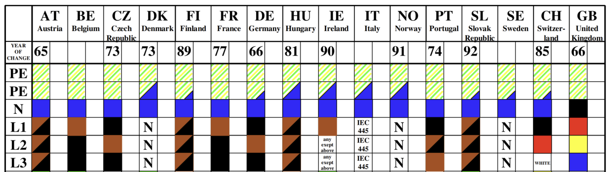

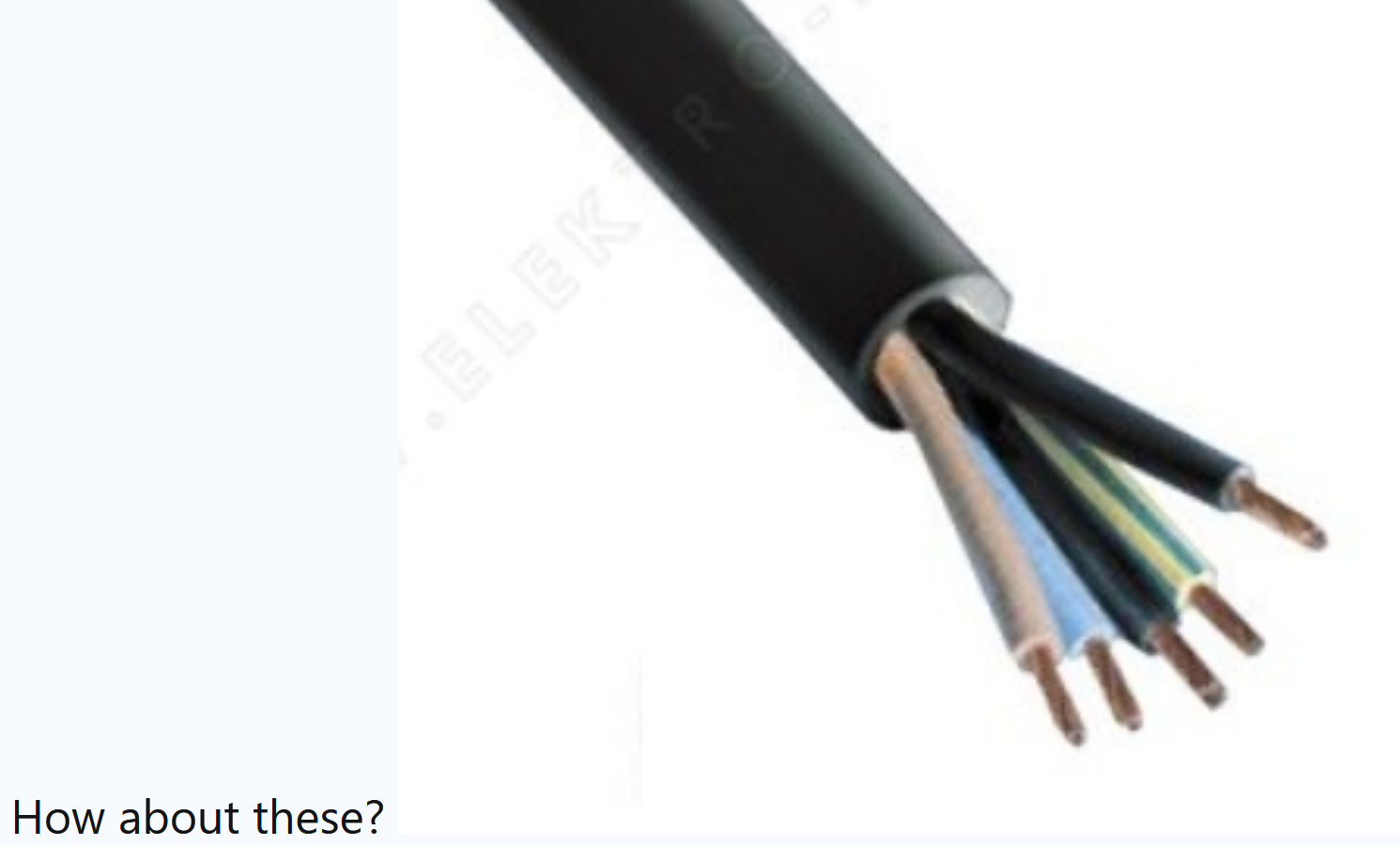

How about these?
The first imported from a country where their colours were brown & 2 blacks, not brown/black/grey?
Belgium, Czech Republic, France, Germany, or Portugal for instance?
The second IHNI, but obviously cable manufacturers can make any colours they choose.
The fact that there are cables which do not comply with our colour scheme does not mean that our colour scheme doesn't exist, does it.

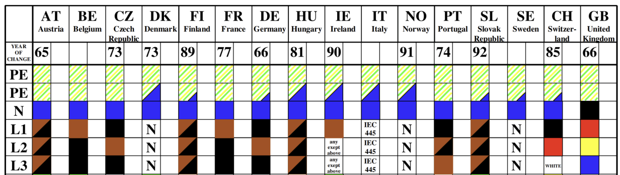

Right so Magenta and Cyan (which are attainable from R,Y,B) are now classed as primary colours?
They always have been, they are two of the "Main" subtractive set of three primary colours.
And BTW everybody - if ever anybody asks you "what colour is earth?" find out the context, don't just say "it's brown".

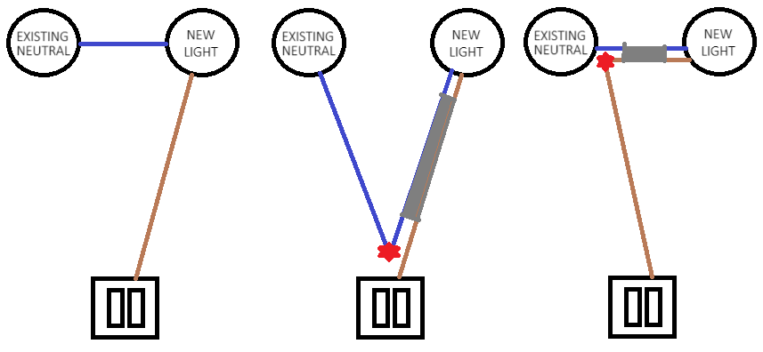

Yes of course, one only has to attatch a label along these lines
in which case oversleeving may be moot, especially if the date of assembly is unknown.
