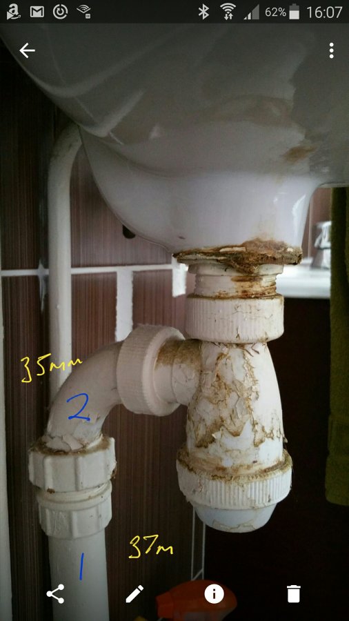

I'm replacing a basin sink trap & waste (see pic) and the local DIY store sells traps in two sizes. Now before I go and buy this stuff am I correct in assuming the size I need is the 32mm bottle trap. The diameters you see in the attached photo are ODs obviously.
The pipe bend marked number 2, does anyone know if this can be sourced off the shelf at a standard DIY store or would it be wise to retain this and just clean it up a bit?
When I'm replacing the waste bit (plug hole or whatever it's called) I've seen that it's recommended to also buy BASIN WASTE SEAL KIT 3 PIECE SET as the standard seals that come with the plug hole kit aren't so good.
As regards sealant am I okay with silicone? I don't want to buy plumbers mate for a one off job.

yes a basin mate is handy for the DIY'er or that basin seal kit. Buy a McAlpine trap too, any others are just a waste of money IMO.
Silicone is fine, just don't use too much, it doesn't need a lot and just on the inside basin waste seal both sides as a belt 'n' braces. Shouldn't need it anywhere else.
