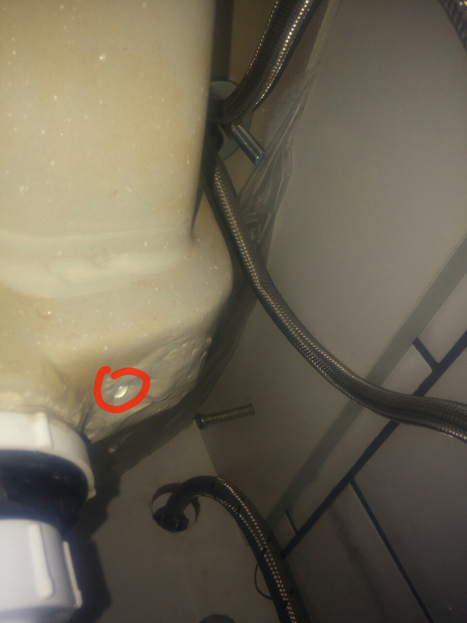

Thoughts on this please? Brand new basin and its leaking from here - ceramic, faulty product??

It looks like it's been filled as the area is like hard putty around it.
Ceramic products often have holes in them to aid the manufacture process.
Given that it is faulty, it is reasonable for you to expect them to pick it up FOC.
