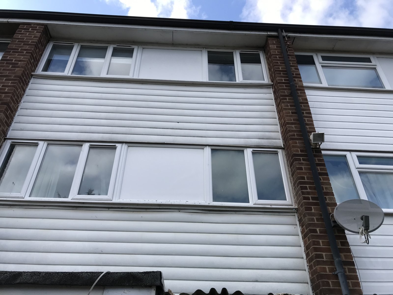

Thanks guys. If I keep this boxed section and the pipe, can I cut into it for the extractor fan?
You may be able to take the vent outside at thay spot and run it up externally.
You should retain a vent somewhere on the system and not AAV it only.
Thanks guys. It would have made my life so much easier to pop the bathroom extractor into this vent pipe. Definite no I take it?
I am mid-terrace. If there are no options to use the existing soil stack, I could pop it through the wall but have these plastic shiplap panels on the other end. I will need to be careful as it will explode everywhere.

If you're in a terrace then there should be more than one vented stack on the shared drain, so cutting down and changing yours to an AAV shouldn't be an issue, always good to get a qualified opinion on that though.
As @denso13 mentions, if you cut into that stack and plugged an extractor into it, anytime it's not being used, drain smells could permeate up and out of it.
AS @Bodd mentions, once the stack was cut you could leave the pipe from the ceiling up through the roof and then put the extractor into the ceiling at the point the pipe goes through it and then hook the extractor into that. May need some support up in the attic though and a cowl on top.

Update: I ran a core drill in the originally envisaged location for the extractor fan. This is at the bottom end of the bath. Fortunately, there is a void between the shiplap panels and the end of the wall. This meant that I was able to slow down the drill at this point and very slowly cut through the plastic. It produced a perfect result. Thanks for all your help.
