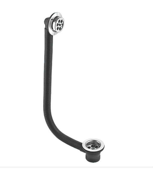

On my bath, I have one of these:
It's all fitted on okay. When I go to screw one of these on the bath waste:
The tightening of the nut goes so far and then it slips off. I then start again and the same thing happens. At first I thought that the fitting my not be straight or stretched by the waste pipe but even when I try it alone (disconnected from waste pipe), the same happens.
I am not trying to over tighten it either but as soon as it's ready for a couple of extra turns, it slips off. I am hoping this makes sense and you guys ca relate to this.
