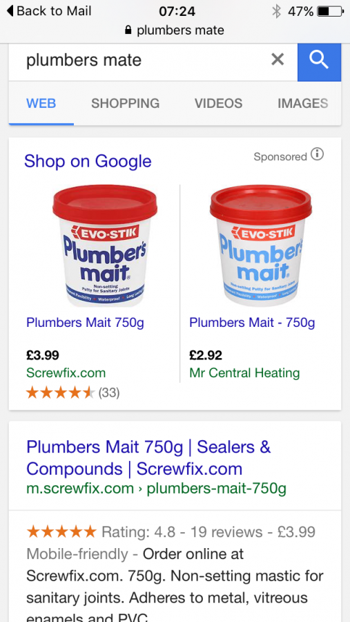

Plumbers mait will last much longer than silicone and it does not "set" so will cope with movement.
