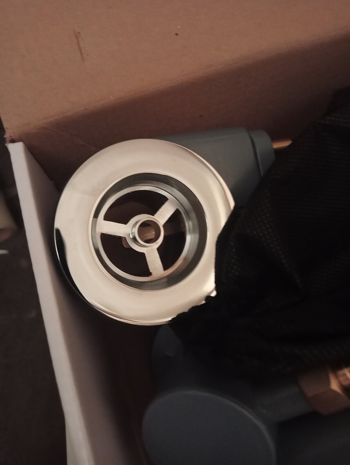

I am talking about the top washer. The shape of the opening and the waste are of different gradients and the seal acts as a padding between the two.
I wondered the best way of tightening that in place. I was thinking needle nose pliers with rubber hose on the wires to stop marking the chrome
Yes, that's what I do with this kind of waste.
Although most have a center slotted screw.
Check in the box.

I use a combi-square. The ruler part is the ideal width.
I too ditch the top foam washer and use silicone
Thanks this hasn't got a screw that tightens to connect the top grill to the base. The top screw screws in to the bottom base. But the only was to do it is to say put a pair of needle nose pliers though the top grill and twist
