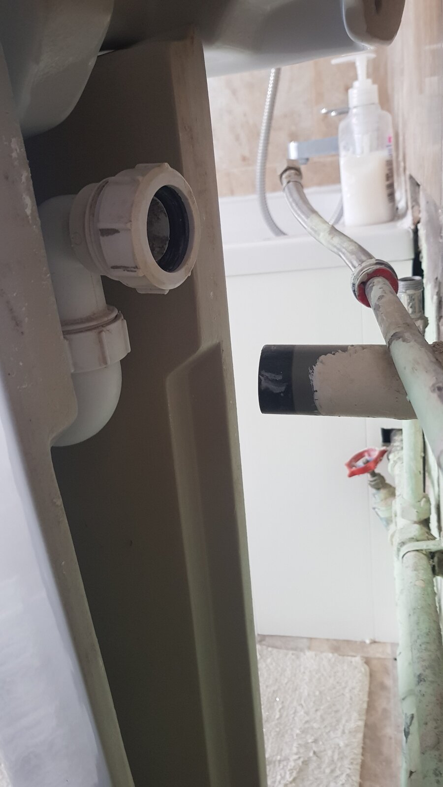

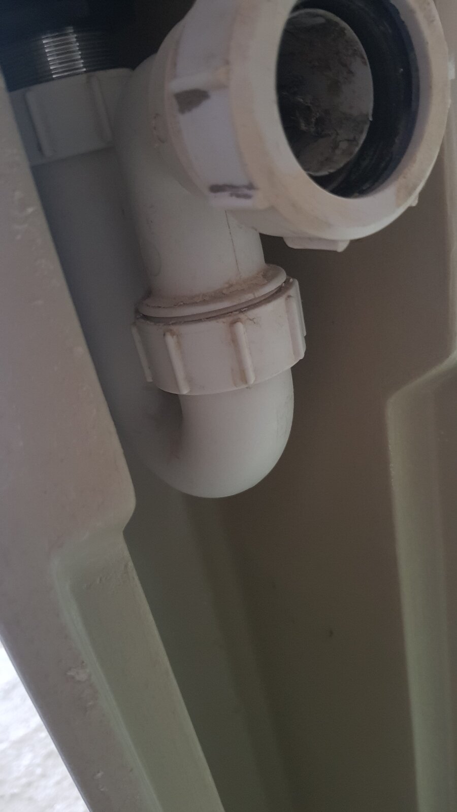

Hey guys as you can see bought a new full pedastal basin and this new one is higher than the old one is there a different trap i can get??? Thanks

The McAlpine ASA10 has an adjustment range of 140 to 230 mm. Measure your gap and see if that would do.
