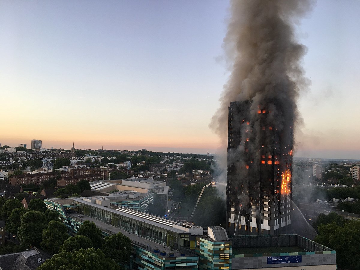

Your confidence is touching.
But such trust is unfounded.
I get mine from DBS cladding, it's Class 1 fire rated but I'll tell them they're selling killer material that's causing all those bathroom fires I keep hearing about next time I buy some. As for B&Q, Wickes etc I'm surprised they're not in prison as they all sell it.
I've done about 10 bathroom ceilings, never had an "undulation" because what I fix it to is level. If I screwed plasterboard to something that wasn't level it would itself become unlevel as would anything subsequently fixed to it.
Cladding from a reputable supplier will be fire resistant.
We all know that to be untrue.
