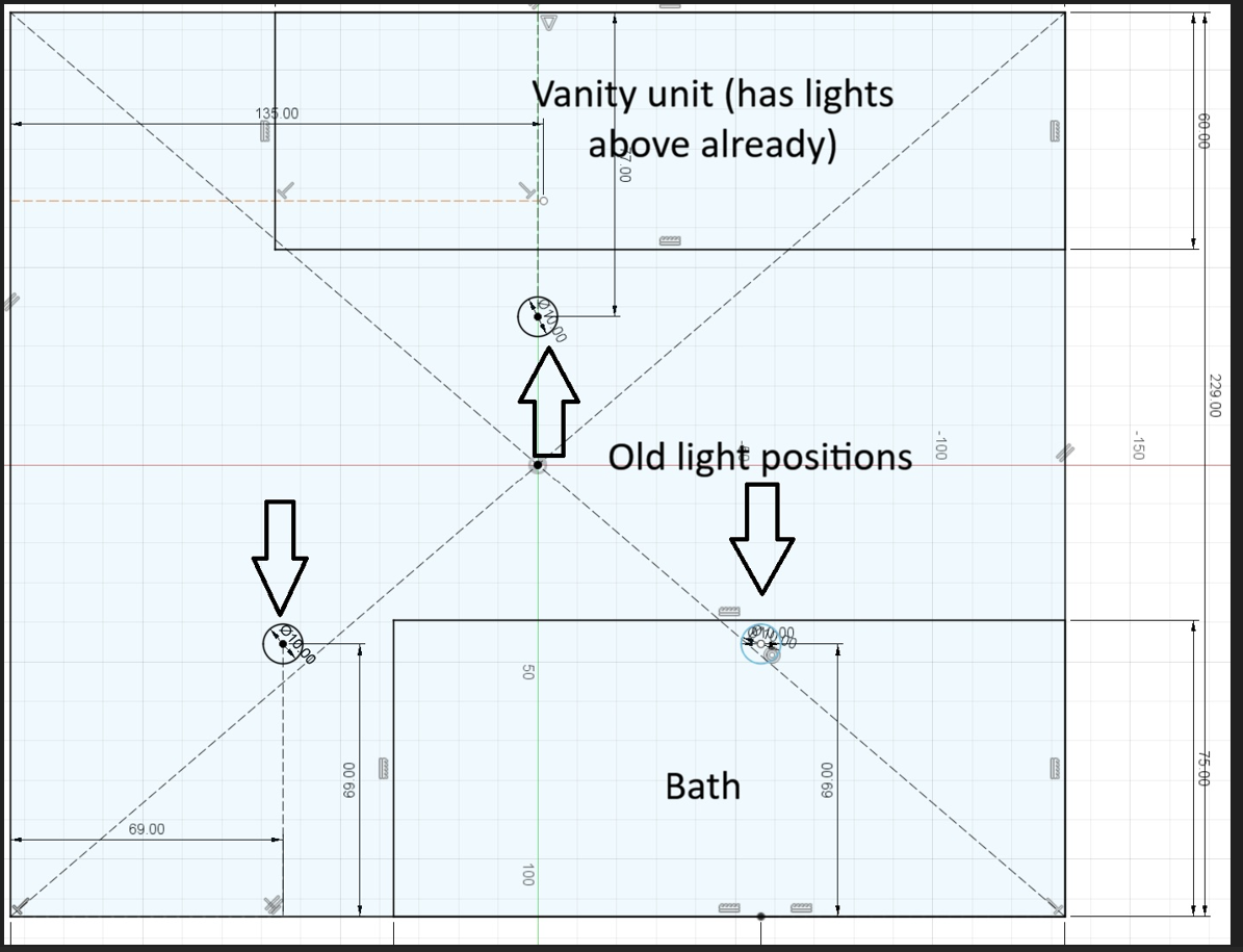

Hi All,
Below is a sketch of our bathroom. We've just had the ceiling replastered and the 3 downlights removed and the holes filled in. What I'm looking for is advice as to where to install 4 new downlights please. You should see from the sketch that the vanity unit above has lights so that area doesn't need any. The bathroom measure 2.67 metres wide by 2.29 metres deep.
Cheers
Daz

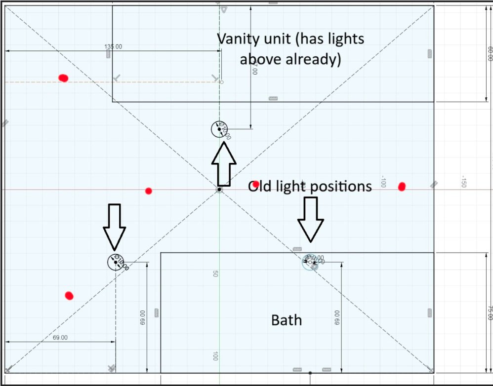

If you have 4 downlights then I would install them equidistance from the centre on the diagonals probalbly 1 to 1.5 metres depending on where the ceiling joists are

So behind the slope of the bath, so not shining in your eyes, and away from the bath enough so they can be aimed not to shine in the bath, @endecotp likely has the best answer, but you don't like that, you can get defused discs to go below the down light to spread the light, the GX5.3 is a larger down light
and will spread the light better. But once you fit a diffusing disc you may as well fit a lamp that size to start with.

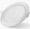

So behind the slope of the bath, so not shining in your eyes, and away from the bath enough so they can be aimed not to shine in the bath, @endecotp likely has the best answer, but you don't like that, you can get defused discs to go below the down light to spread the light, the GX5.3 is a larger down light View attachment 405227 and will spread the light better. But once you fit a diffusing disc you may as well fit a lamp that size to start with.
That is a bit ugly IMO but I have 2 of these in my kitchen and give a great evenly distributed light and are very slim
I would go for two of these at lower watt or 1 at higher.

Always fancied arranging like the great bear
Good idea, so when you lay back in the bath and close your eyes at least you have a meaningful pattern burned into your retina, rather than a boring grid. But on the other hand, and like @pete01 ‘s pattern, you need five lights, and dazzystar only has four.
12W CCT Adjustable Circular LED Panel - 165mm | Knightsbridge (CPL12CT)

Yes its like your picture but that one is recessed so you need a massive hole but the one i posted was 15mm deep surface mounted and the cleaver thing is that the spring clip is adjustable to fit any pre existing hole where your downlights once were.
Also yes that is the beauty of the GU10 as you can just buy brighter bulbs if you got it wrong.
Initially I brought a lower wattage one but it broke so I returned it but also after seeing that it was not bright enough I opted for the next one up while I had the chance.
You can get dimmable ones that work off your light switch by turning it on and off quickly until you have selected the brightness and it them remembers that setting. .
