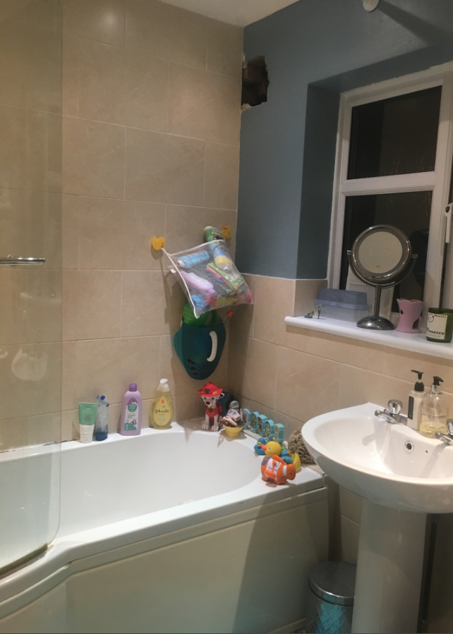

Hi all,
Could anybody please recommend me an extractor fan for the bathroom? There is so much choice, I'm completely lost! Screwfix seem to have 120+ alone!
Criteria is...
- Wall mounted
- Quiet as possible
- Manual on (with over run)
- Suitable for small bathroom (2m x 2m) with shower
I don't want anything linked to the light switch, or with linked to a humidistat. Simply something that I can switch on when I want it (ideally on the unit itself to save putting in a new switch), that will run for 30-60 mins afterwards before switching itself off. The bathroom is directly below the attic, so if it's something I can tap into the lighting circuit for power that would be ideal.
Not too worried about the cost, happy to pay for quality.
Thanks in advance!

I've never really seen the point of linking to the light switch really, unless it's a room without natural light. For a good half of the year it's light enough in that room to not need the light on for morning showers etc, and there is also the annoyance of the fan running on when nipping to the loo for a wee in the night. If people aren't disciplined enough to flick a switch / pull a cord when having a shower... I guess they'll be the ones with the damp / mould to sort out. I'd be tempted by a humidistat for convenience, but a lot of reviews I read seemed to complain about these stopping working fairly quickly.

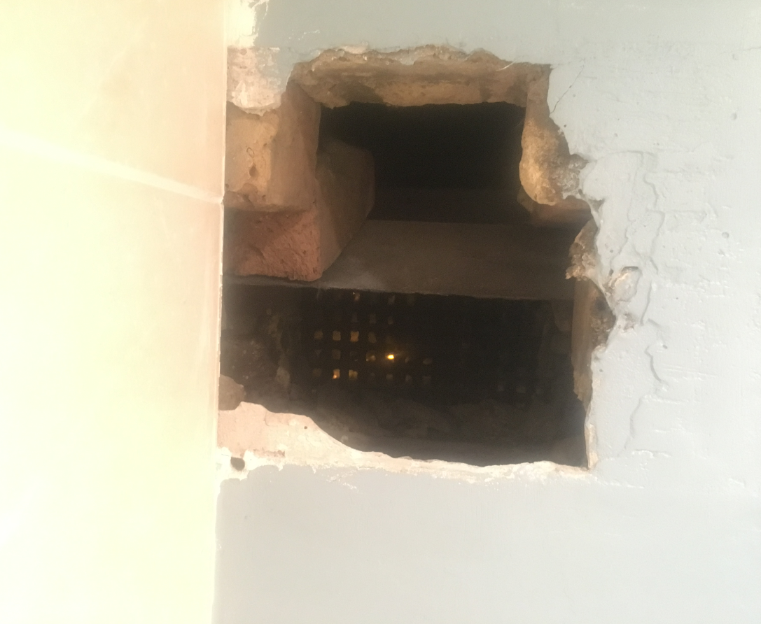

Currently I've a large hole! I took the plastic grille off the airvent to find an airbrick the other side of the cavity, which had been stuffed full of rockwool. This is pretty much at the ceiling height at the end of the bath without the shower head.

It's big enough to fit a large fan then. The typical 100mm builders fan shifts only about 80 cu.m/hr so is insufficient for a room with a shower.
Why do you think it will be an "annoyance" to have a fan running at night? Do you know how quiet the modern ball-bearing fans are? A mouldy or stinky room will be much more annoying.
How high above floor level is that hole?

This is a good-quality 6" fan (duct diamer)
https://www.tlc-direct.co.uk/Products/SLS300CRZ.html
It is powerful enough for a room with a shower and has an adjustable timer.
The faceflate is 214mm Sq
so you will have to make up some kind of moisture resistant board, or brick up the hole round the duct. Tilt the duct slightly so that any condensation or rain runs outside.

A 150mm cowl vent on the outside will keep the weather out and reduce wind noise.
The height above floor level is important, as it will be mounted above the end of the bath. How high is it?

I'd have to measure it, but see below for context.
