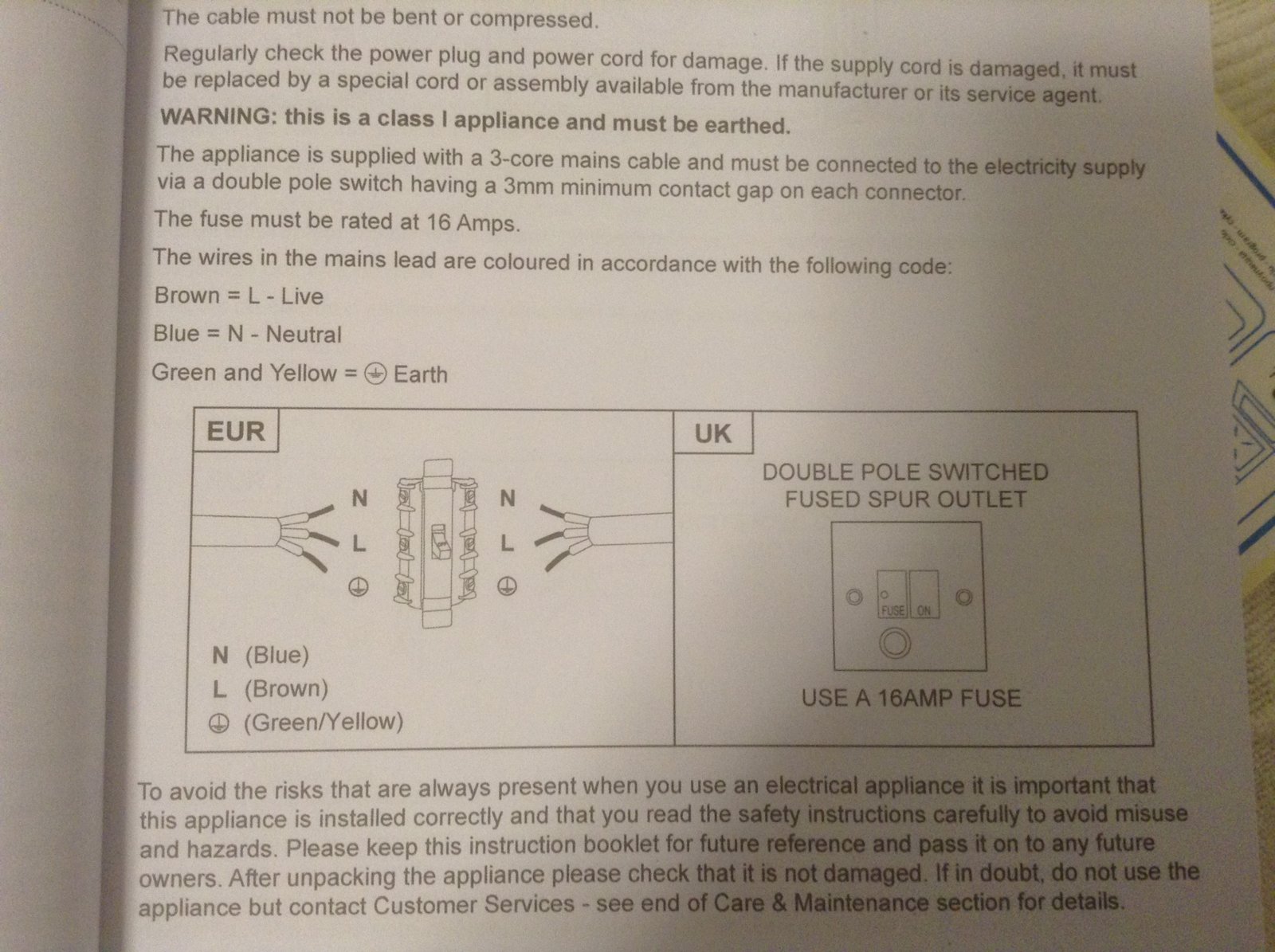

I completely agree that by conforming to BS7671 my ass 'should' be covered, but it's still good practice to comply with the instructions.
The instructions are guidance only and don't have to be followed, especially when they are wrong.
Here is a serious example of wrong manufacturers instructions.
My understanding of manufacturers instructions are that they should always be followed
This has been discussed before. I think you must “have regard to” the manufacturers instructions, but that doesn’t mean blindly following them if e.g. they are obviously wrong.
I had a bathroom fan where the instructions showed fuses in both the L and N supplies. I did not install it like that.
