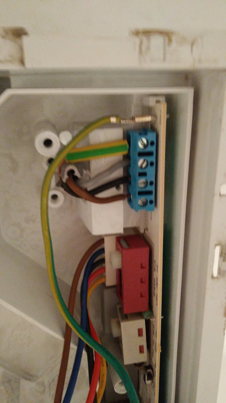

I would be most grateful for knowing how to wire up my new Experia bathroom fan. The wire colours for the new fan do not match up with the wire colours in the ceiling. So my question is which one goes where?

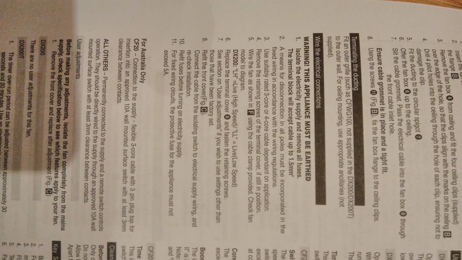

Thanks for the replies. I have some more information that might help in the three enclosed photos.
One shows the wiring in use on the old fan, and other two are from the instruction manual for the dx200 model.
A photo in focus would have been more helpful!
If I can try to decipher it.
The grey was in N neutral (?) - this should have a blue sleeve on the wire
The black was in T (?). This is the switched live and should have a brown sleeve on the wire
The brown was in L (?) This is the permanent live.
And the earth is the one with green/Yell sleeving.
I assume you have a wiring diagram for the new fan(?) and can wire up correctly from the above.
As far as I can tell from the wiring diagram for your new fan, the three terminals, starting from the left, would be the same colours, namely:earth (green/yellow), neutral (grey) (N) and switched live (black) (T) (T means timer I believe). The remaining two terminals give you choice for low or high speed (LH or HH) and the live (brown) would go into one of these. This, to me, explains the "extra" terminal.

The instruction paperwork I showed is for the new model dx200. Unlike my old model it does not have a Timer function (T).
If I have understood right
Yellow / green goes to Earth
Grey to blue
Nothing in the middle for T
Black to brown
Brown to red

Your incoming cable has permanent and switched live, as you know from looking at the connection diagram for the DX200T.
Your new fan only uses switched live as you know from looking at the connection diagram for the DX200, and as you know it has no timer function.
You connect to brown or red depending on what speed you want the fan to run at.
