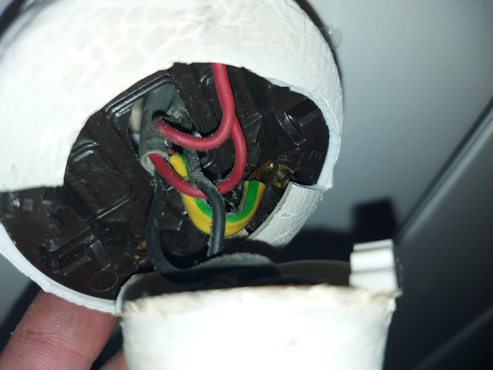

No it didn’t. Think would happen if they were live and neutral when you operated the switch. Yes it would connect live to neutral and trip the MCB. Black does not mean neutral. In this case it is switched live.
Moving on to the light fitting I guess you had 2 permanent lives into a loop terminal and 2 blacks (neutral and switched live) to the lamp terminals. Now again I guess you have wired the new light permanent lives to one terminal and neutral plus switched live to the other. When the switch is off the light is on (with a pull switch you don’t know which is off and which is on). When you operate the switch to on (you presume off) you connect live to neutral via the switched live wire from the switch to the light where it is connected to neutral and trip the MCB.
If so you need to move the 2 reds together to a terminal strip and connect the 2 blacks separately to the 2 terminals in the light.
Do you have a picture of the old fitting before you disconnected the wiring?
Thanks for the replies.

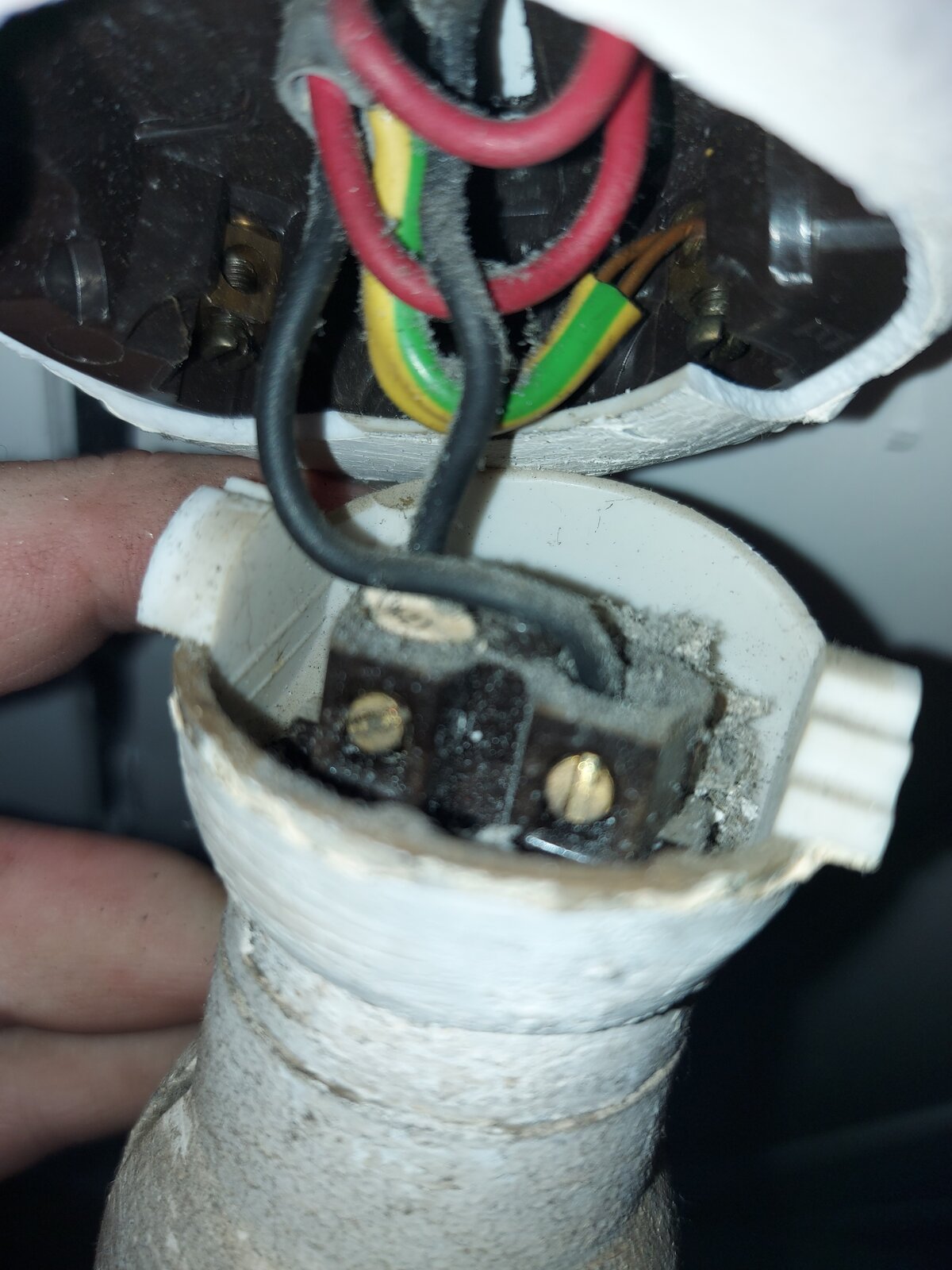

This is the original batten light I removed.

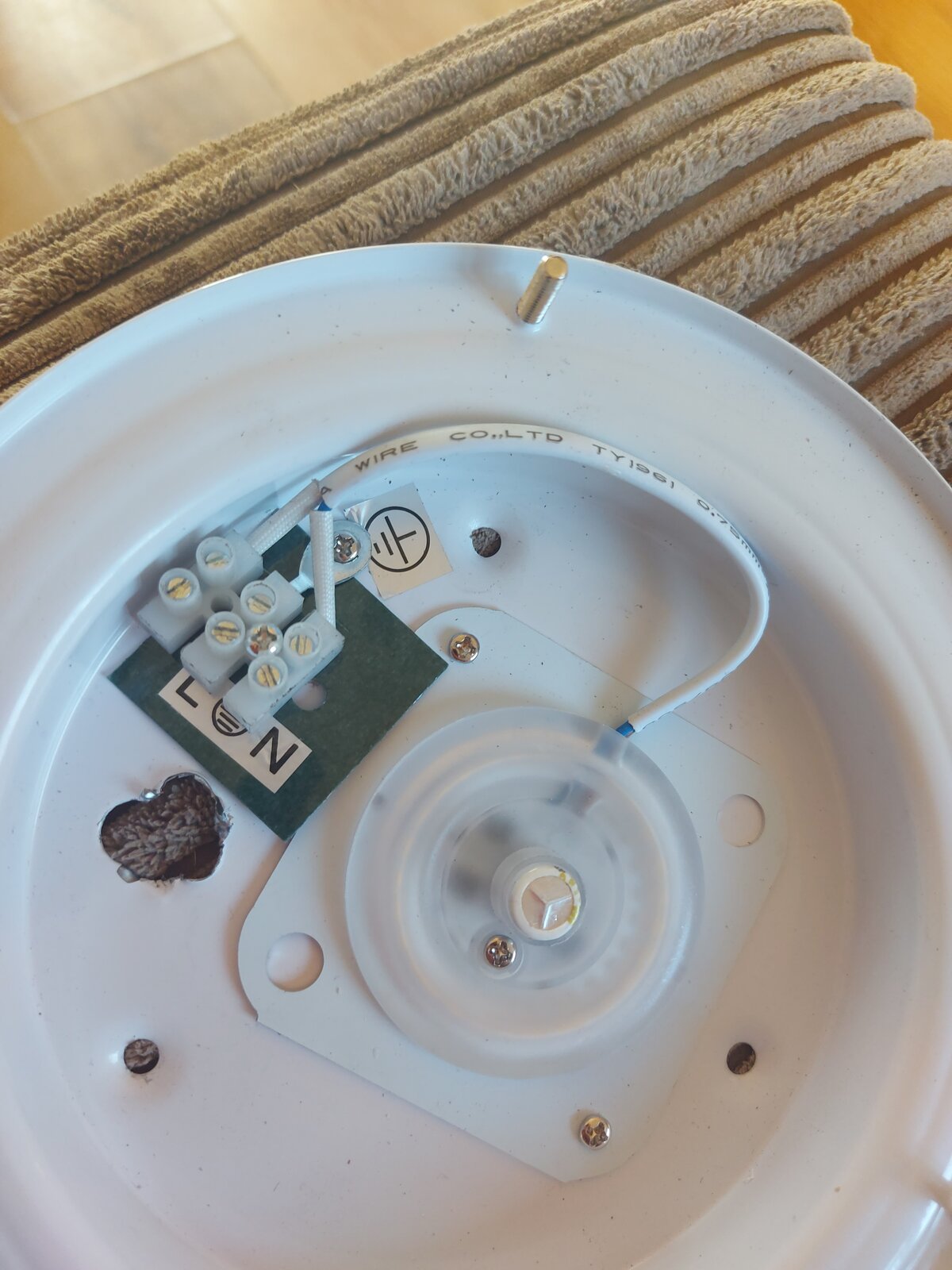

The new light fitting has a terminal block and I followed the same instal as the batten light.... 2 live wires to live, 2 neutral wires to neutral and the 2 earth was already put together with yellow/green sleeve.
And this is the pic of the new light fitting.
I'm wondering if it's on a loop and I need a different light fitting?

The two black wires are neutral and switched live .They do not connect together in a terminal block, they are connected across the lamp.
On your new fittings terminal block one black goes to the neutral terminal and the other goes into the live terminal .The two red wires must connect together in a sperate insulated connector block or wago ,that does not connect to your new light fitting in any way.
Hopefully your new fitting will have space to accommodate the additional connector block in its housing.
The earth conductors connect to earth terminal of course.

If its on a loop will this light fitting still work? And excuse me if it's obvious, the block connector for the 2 reds just terminate in the block?
Your new fitting has 3 terminals ,but you need 4. The 4th holds the two reds.
Is that clear now ?
The rest of the circuit isnt really an issue.
