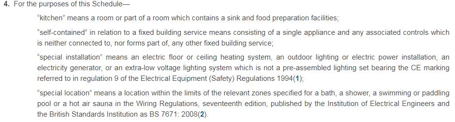

In the main the hole in a FCU is round and most stuffing glands are round, and much easier to seal a round cable, so I would use flex. And I would have no problems signing the minor works certificate when using flex, although here is Wales a bathroom is a special location and so it would cost me £100 plus vat the register the work, so I would use a scheme member electrician as cheaper.
The 'special location' referred to in the Building Regulations is only within the zones (0, 1 & 2) of the bathrooms etc.; this is different than the Electrical Regulations' 'special locations'.
So, the mirror might not be in a 'special location' regarding notification.
It's only been sixteen years.

The regulations are different England and Wales, There were the same to start with, but the English version was watered down, but that did not happen to the Welsh version.
If you look at the wrong documents, you will be mislead.
I said the definition of a 'special location in the Building Regulations and the Electrical Regulations are different.
THE LAW in Wales:
https://www.legislation.gov.uk/uksi/2010/2214/schedule/4/made
This is what Wales has been working with since 2005
