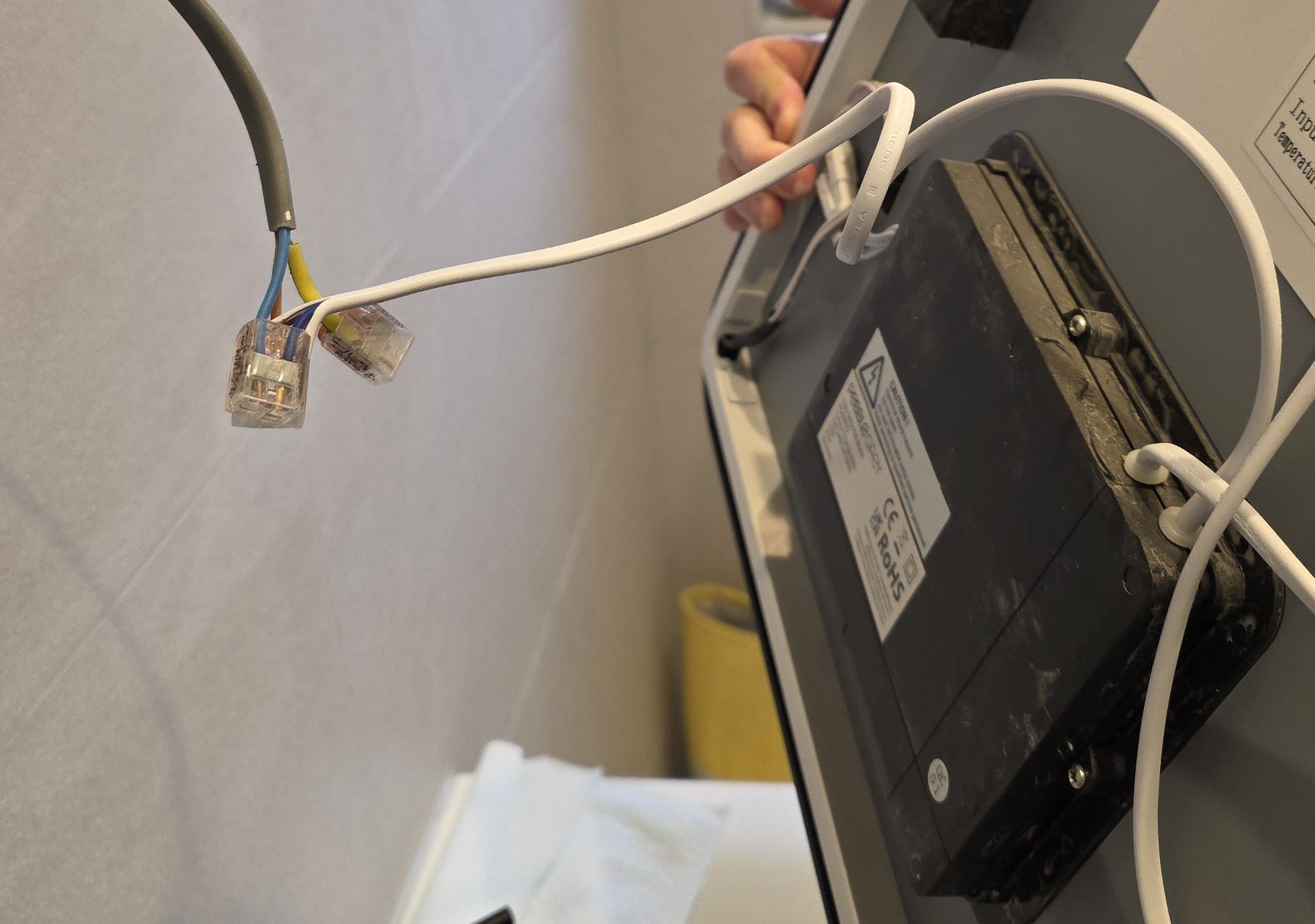

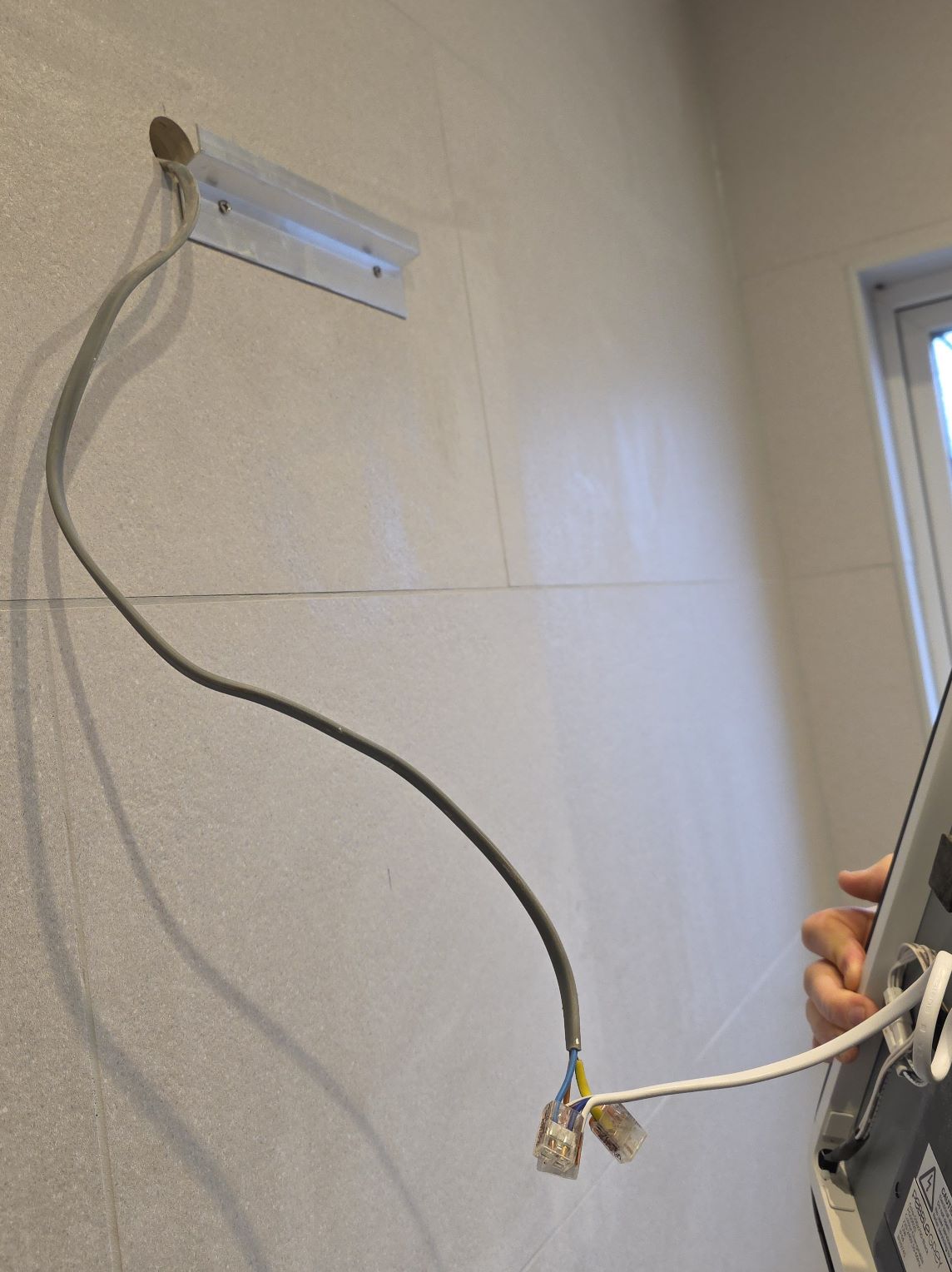

Hi
We had our bathroom renovated a few months ago which included an electrician fitting a heated bathroom mirror. I had reasons to unhook it from the wall recently and discovered that the join between t&e and the mirror 2 core flex has been made with Wagos that are exposed. I won't be calling the electrician back.
I don't feel good about this especially with it being in a moist room and feel he probably should have made the join in an enclosure of some sort? I've been looking for waterproof connectors so I can enclose the join but most are too thick to fit behind the mirror (about 25mm depth).
My other thought was, if possible, to replace the t&e with the same 2 core flex as what's used on the mirror. I could potentially open the mirror back, connect flex cable and run it up to the loft and join to the existing t&e there with a maintenance free box).
What do you think? Am I worrying over nothing? Any advice is appreciated!

You could argue that the mirror and the wall form the enclosure as you need to remove the mirror to expose the connections
I wouldn’t be losing any sleep over it
Only concern there is the mirror sits on the wall with a single bar/hook - it can easily be pulled forward from the base to expose the wagos.
Is that definitely how it is supposed to be fixed to the wall?
It could end up hanging by the cable, which would not be great even without the wago issue.
Where did you get the mirror?
Installation guide seems to suggest single bar... agreed probably not great but I don't have any prior experience of mirrors and if they're generally supposed to be fixed in multiple places?

One bar or hook type fixing of the mirror at the top end and then at least one fixing at or near the bottom and only removed or slackened with a tool (example a screw) should deter accidental disconnection but allow easy maintainance if required).

It's more the fact theyre 'exposed' and likely pushed against tiled walls that are likely to condensate - water drips down in to a wago, potential for corrosion etc etc. It just doesn't seem right that theyre not enclosed when in a wet room. I can't enlarge the hole as its a tiled wall (I don't have the skills to do this) so almost certainly am going to just replace the whole length with 2 core flex but appreciate all the feedback so far :)
Failing that I'll get some connector blocks as suggested or even the wago gel box thing - I would have assumed a cable joiner would need to offer mechanical grip that a gel box might not give however?
