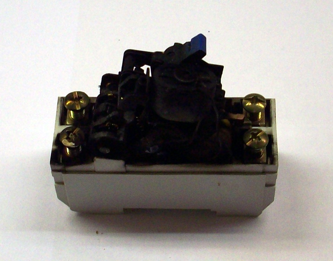

As I said, I'm hesitant to dissect the brand new Wylex RCD I've been experimenting with. However, some of you may remember, from four or so years ago, my daughter's RCD which blew up when she touched the 'test' button ....

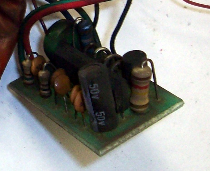

The electronics of that (Protek) RCD looked like this ....
I've just dusted off that PCB and had a quick look at it. It is more like what I expected than the one in the video, in that central to it is a VG54123 IC, which contains an amplifier, together with a voltage regulator, reference voltage source and a latching circuit - and, as in the video, has a thyristor/SCR (BT169D) triggered by the output of the IC.
The IC seems to be powered by a bridge rectifier using four discrete silicon diodes (again, similar to the video). I haven't yet attempted to trace the circuit, but it looks as if, as in the video, there are two silicon diodes and the thyristor/SCR in the supply path - which, if true, again means that there would be too much forward voltage drop across those devices for it to work with a 0.7V RMS supply (as my Wylex seems to do).
More after I've looked at the PCB in more detail.
