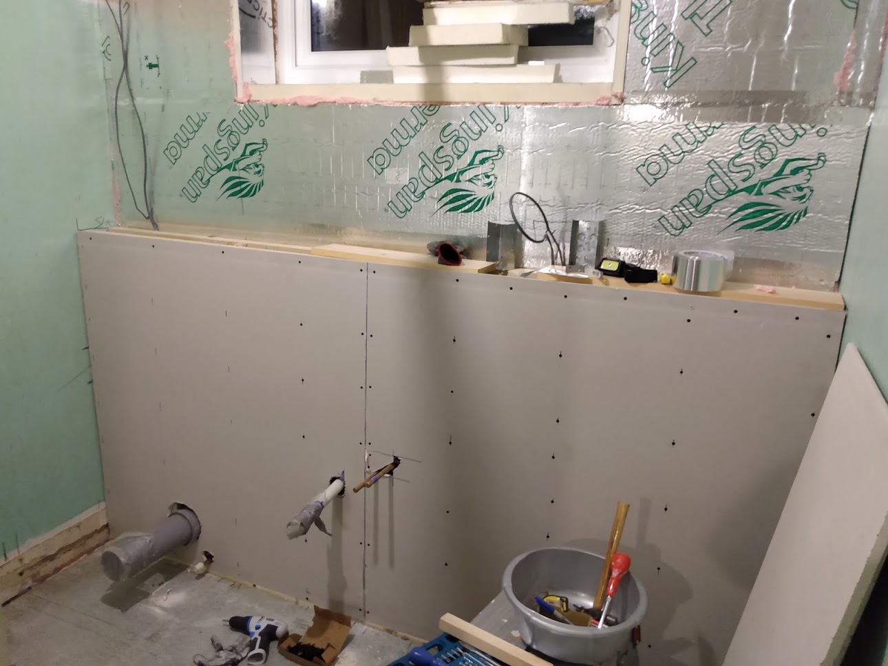

Looking good. But the sink waste could of had a 45 degree out of the soil giving a steeper drop. Or better still put it into the soil stack in the boxed off back.. One less pipe under the floor to deal with.

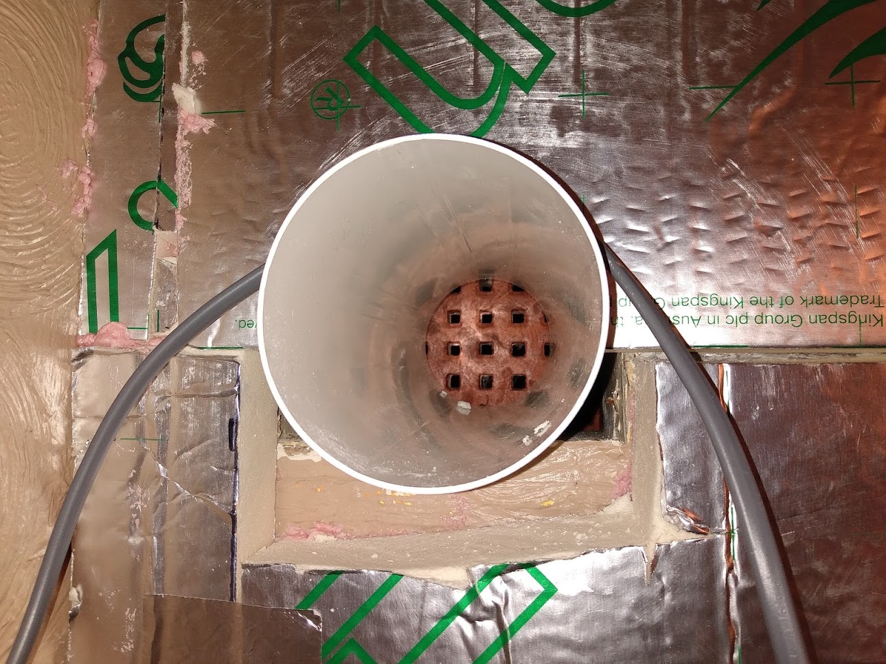

I've bought the extractor fan (wall mounted, cord) a pipe, and outside cover. Could I not use the cover, just put the pipe up to the airbrick? It will be insulated / foamed in.
Latest bathroom pic:
With all that effort you put in don't skimp on cutting the airbrick out. Get a cheap wood chisel to knock out the circle.
Cheers. Wasn't sure how necessary it was, but I guess it would be better to put the pipe right through and seal the airbrick holes not being used.
Will use my hammer and and sds drill bit (the cheap Katsu drill broke)!
Yes. That brick will restrict flow and with it being cold the hot stream from the shower will condensate on it.

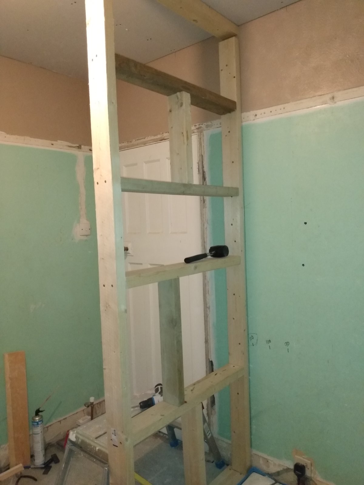

Started my wall today, my first stud wall!
Mallet is on what will be a shelf
Wall will be about an inch thicker, need to get some wood for the back. plasterboard on back, the board front.

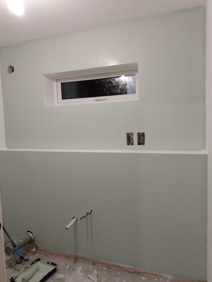

Getting there. Almost ready for the plasterer.
Update - boarded, plastered, painted. Just need to get the electrics finished, install toilet and basin, then tile shower, fit shower and door, put down floor. Done.

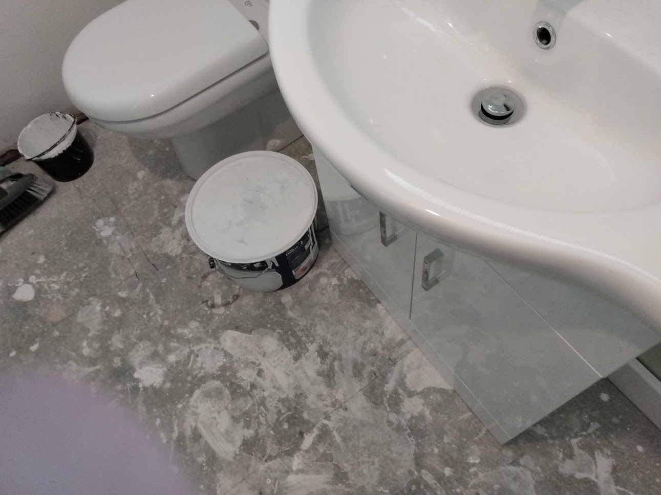

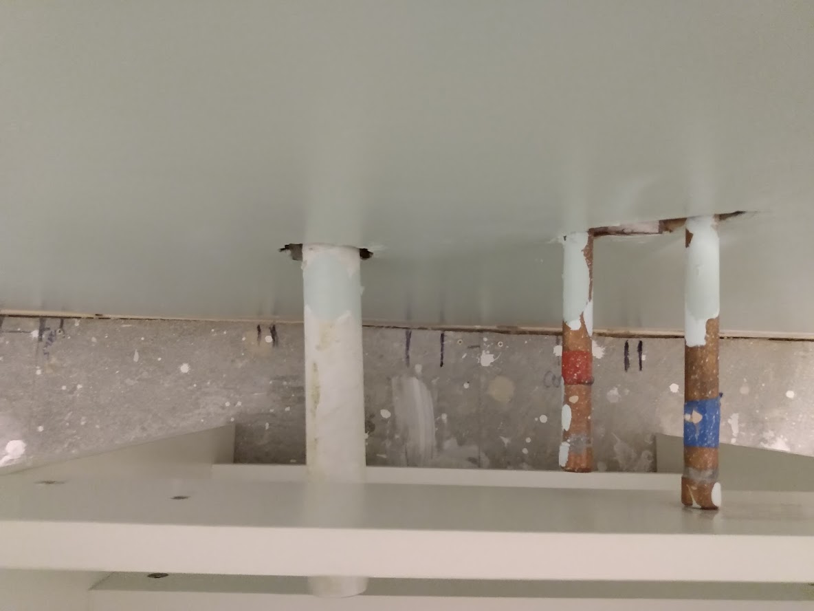

Basin and unit arrived. Pipes in wrong place, but can drill holes.
Plumber will be fixing it anyway, but curious, what is best practice for securing a basin to wall when you only have plasterboard to fix to?
The unit can be fixed well as there are 3 battens it can screw into (shown with the black marks on the floor) but the basin won't line up with any.
Toilet, radiator and basin in and connected.

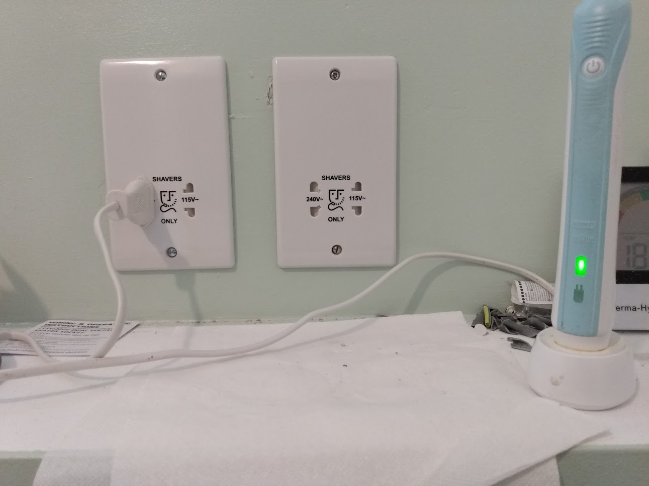

Electrics wired up - with a 5A switched fuse as suggested. All working.
I need to make this tidier, will get a MK plastic switched fuse box so it does't look so silly later when I renovate the front hall. It's all safe and hidden behind a shoe cabinet.
