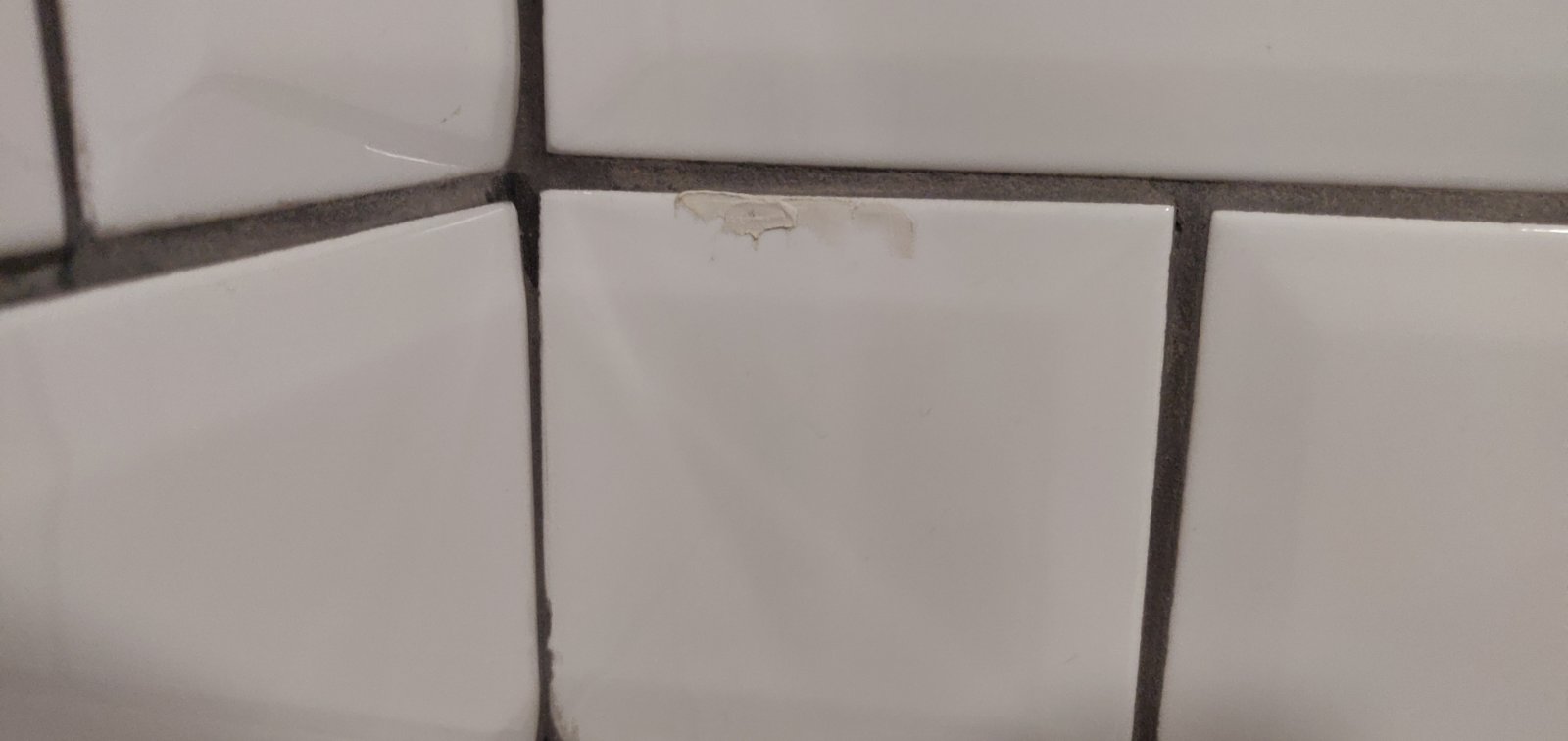

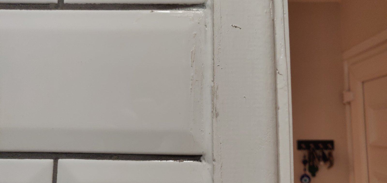

Hi everyone, I'm looking for a bit of advice after a bad experience with a (very well reviewed and recommended) local tradesman.
Our bathroom was flooded by an upstairs neighbour when my wife was 30 weeks pregnant. Luckily, insurance paid out and we managed to find a contractor who could complete the work before our due date.
Unfortunately, there is quite a lot of the finish that I'm unhappy with. Our timescales meant I had little opportunity to ask for work to be re-done but, now our daughter has arrived(!), I'm hoping I can fix some of it myself.
What I'm really hoping for is some advice on which of these things are easy to tackle for someone without any DIY experience;

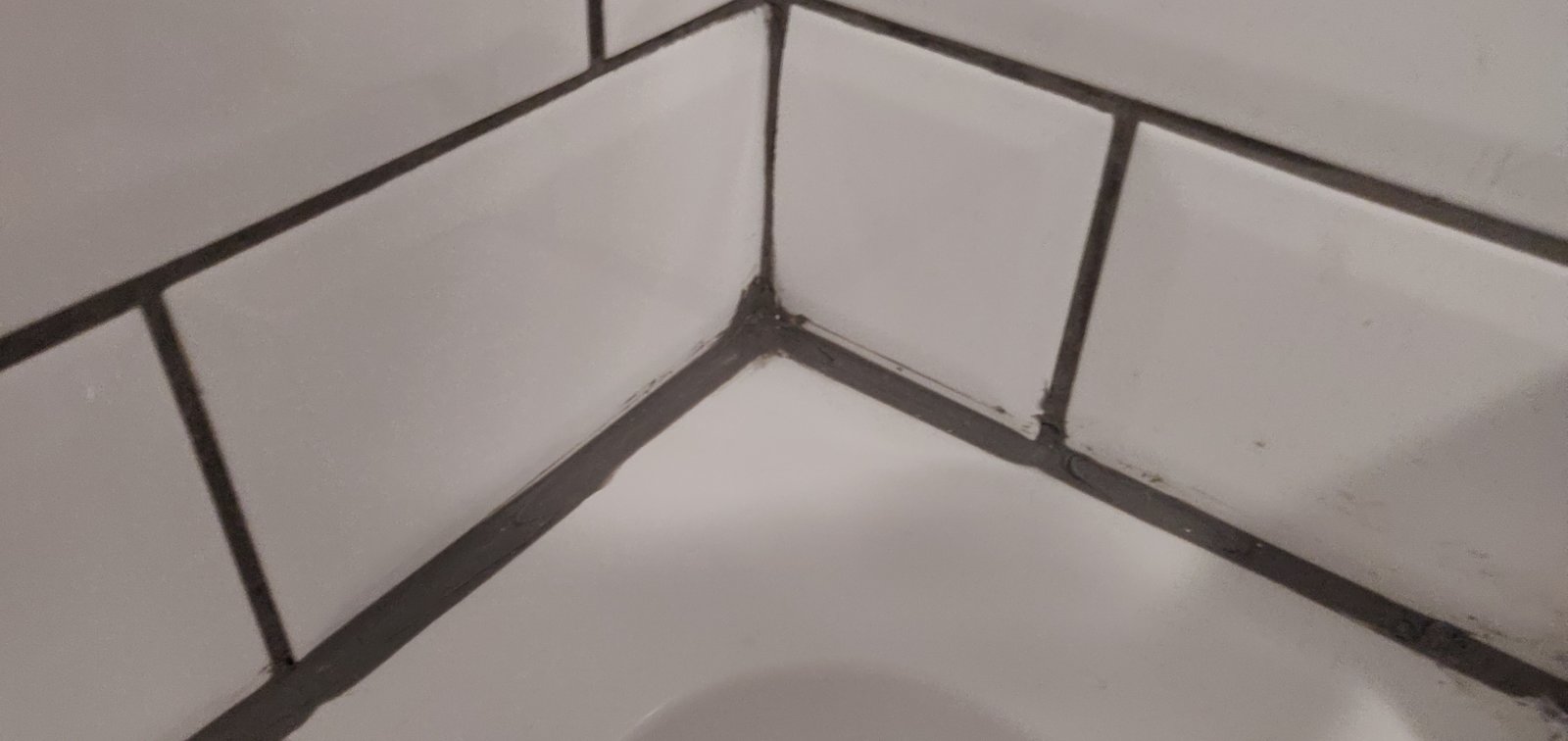

  • Replacing shoddy silicone seals

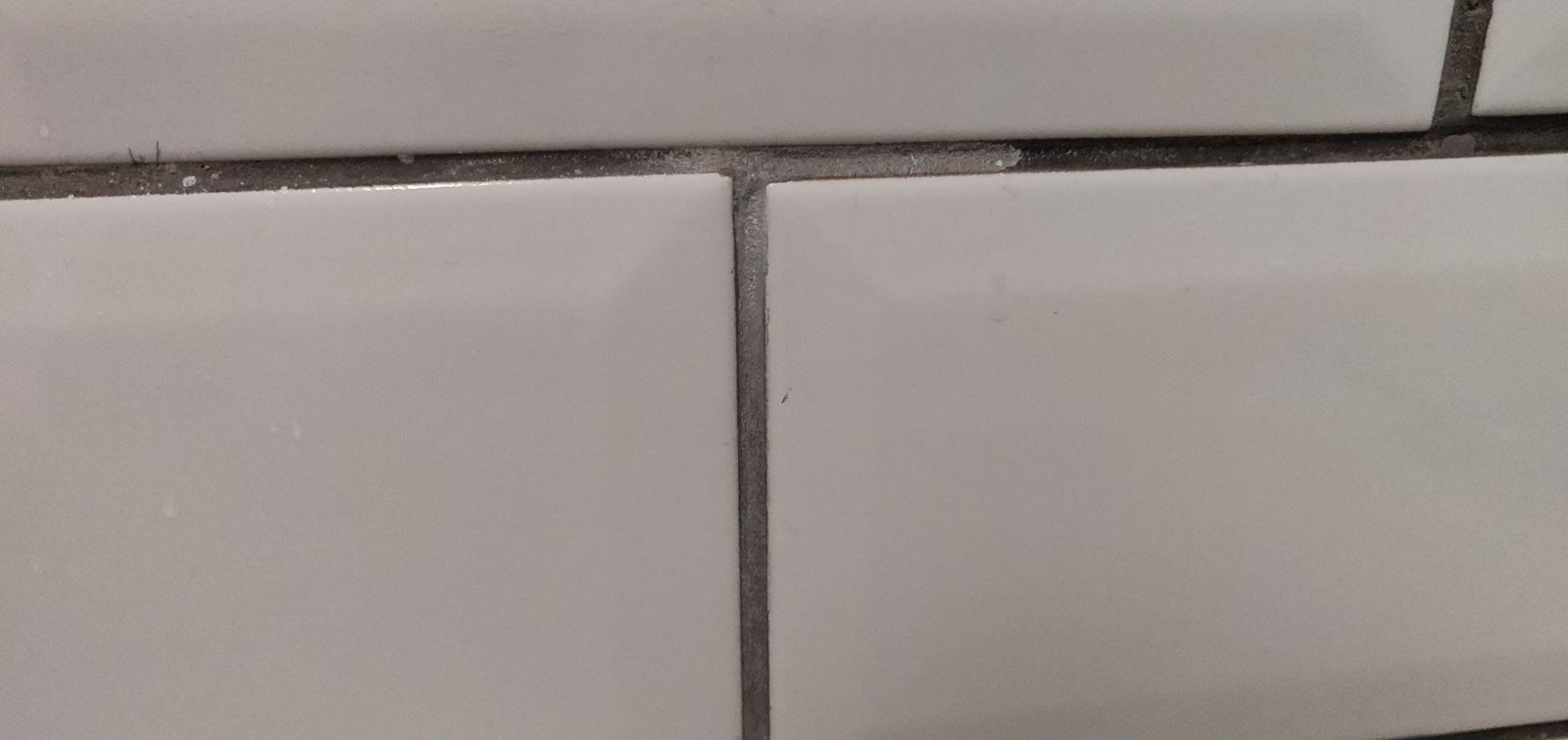

  • Re-doing grout that appears to have been painted over
  • Removing (?) from tiles
Pictures attached and thanks in advance!
Frustrating but all easily remedied. Would suggest using a scraper with Stanley blades to remove offending silicone. You can then mask up and apply new sealant. Use a wet finger to smooth the surface prior to removing the tape.
The scraper should take the paint off of the tiles or perhaps some warm water and a scourer .
There are tools for removing the grout if needed. You can then buy a bag of the correct colour grout from screwfix mix and apply as necessary.
If sealing the bath to the wall tiles, ensure the bath is filled with water and left overnight.
Thanks so much for the reply - I'll have a go at this in the next few days!
Re: the very sound advice from Peanut the reason you should fill the bath with water before you seal is that the bath drops slightly with the weight. If you don't do this, after you have sealed, and someone takes a bath, the bath will drop with the persons bodyweight/ weight of the bath water and rip the seal.

The different colours in the grouting looks like contamination, by that I mean that the sponge probably ended up with tile adhesive on it.

BTW when working with silicone, dip your fingers in dilute washing up liquid. It stops the silicone sticking you your fingers.
The dark grey silicone is going to be very difficult to apply to a high finish, especially given that your tiles have bevelled edges. It might be advisable to find a specialist (as per Dang32's advice). Oh and get them to run silicone up where the tiles meet in the corner.

When finishing Mastic
There are several "Mastic Finishing Tools" out there, a simple plastic device that smooths of and gives a consistent angled mastic finish.
Suggest you have a look at U-Tube for such finishing devices??
