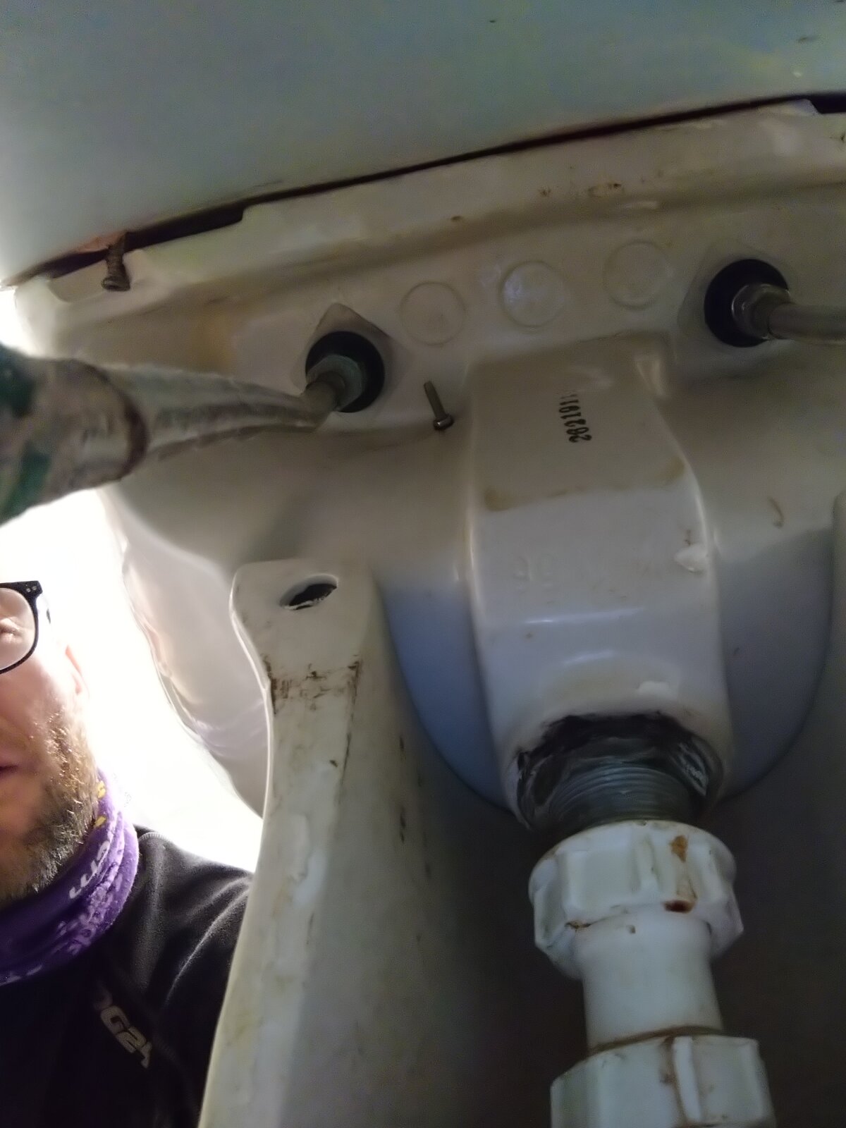

Ok, you have at least 1 broken screw hole in your basin, and if you want to use the sanitary-ware whilst removed, you’d have to extend pipework etc. To remove you can isolate the water to each pipe if there’s isolation valves, if not, then I recommend fitting them, full bore too.

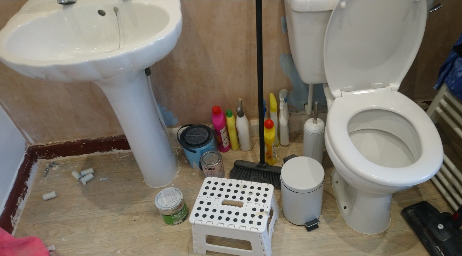

First image is an overall view

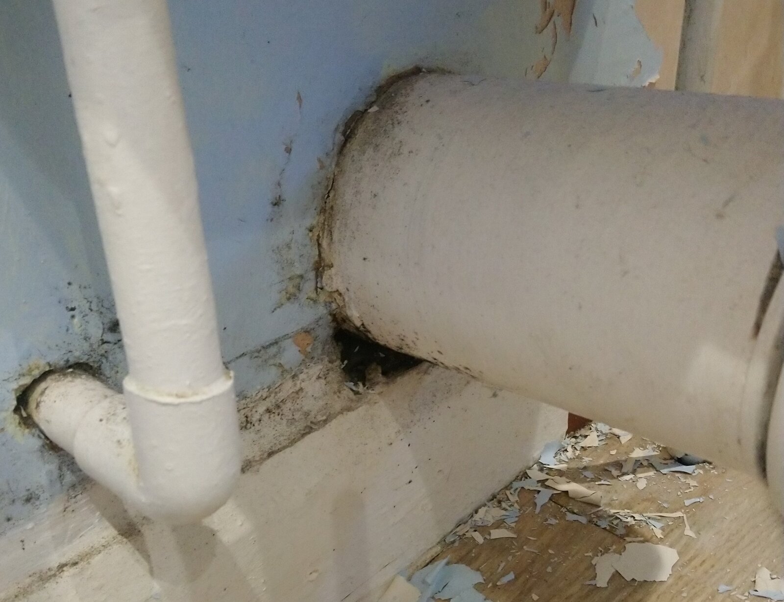

2) refuse pipe from toilet with destroyed plaster

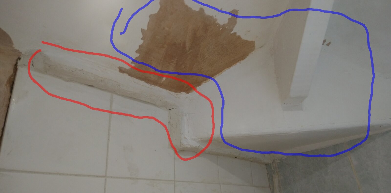

3) red line indicates piled up grout... And blue shows how wall is structured in the corner with corner structure where moisture collects and then mold build ls

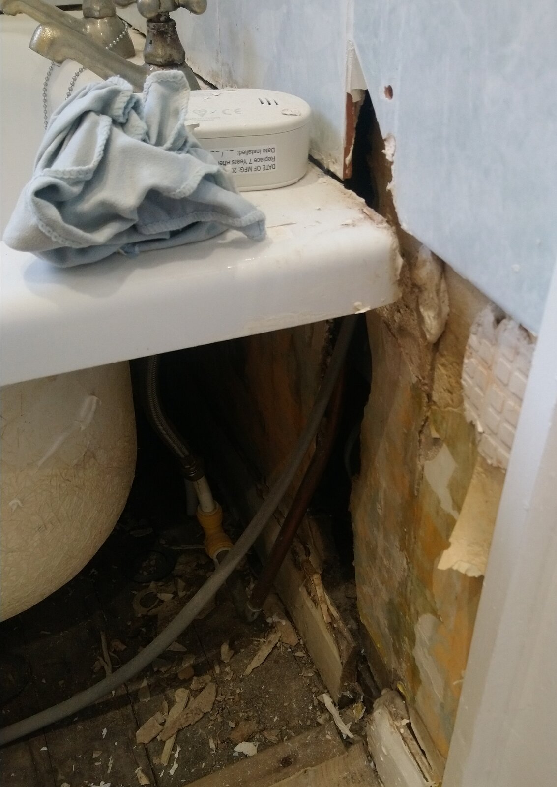

4) destroyed plaster board behind bath panel where shower cold water inlet was piped in

Your bath needs removing, the rot removing and then properly sealing on the wall sides with modern sealing solutions. Same for the toilet, where it looks like you have damaged walls and damp (hence my comment about an extract fan).
My experience is that half a job has to be done twice and the walls in the pictures look in poor shape. You want to be really getting them right before you put any ware in the room and thats much easier if you take it all out and do it afresh.

With regards the bath - personally, I’d get it removed, fix everything needed to ensure no more leaks, otherwise you’ll be doing it every year or so.
The “destroyed” plaster behind the toilet looks minimal, so polyfilla, or maybe one-coat plaster.
If you’re only removing certain parts to decorate, then no need for isolation valves, unless it’s going to take a long time. If you want to fit them, make sure you use inserts in that plastic pipe.
