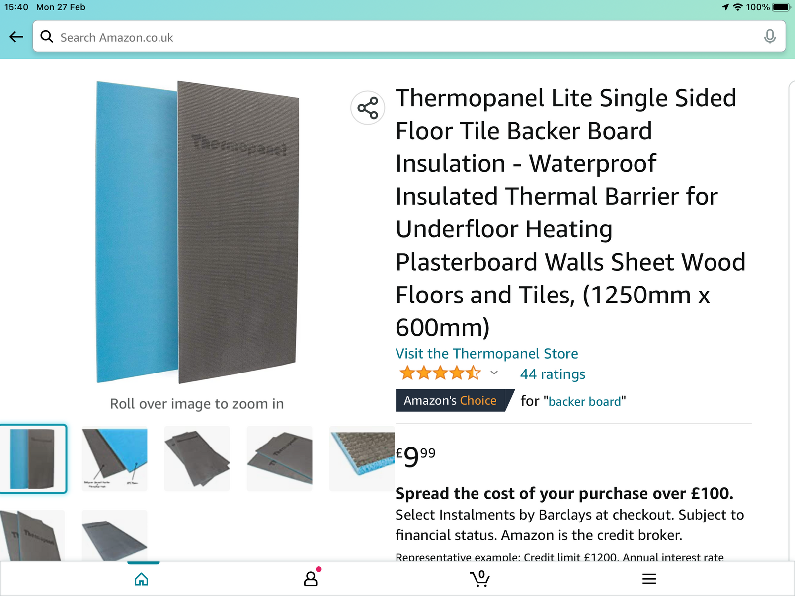

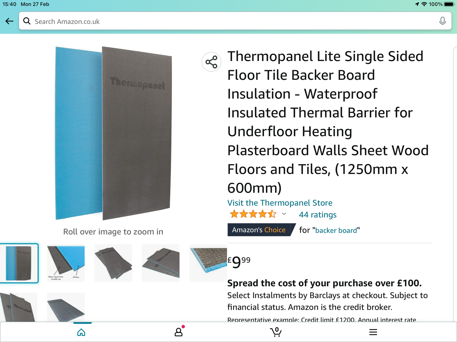

Hi, are these backer boards suitable for fixing to my now bare stud work (plasterboard removed) for fixing the shower wall panels to please?
Click meeeee
Sorry, here you go
I would have thought so, but that would be a question for the manufacturer/supplier really.
