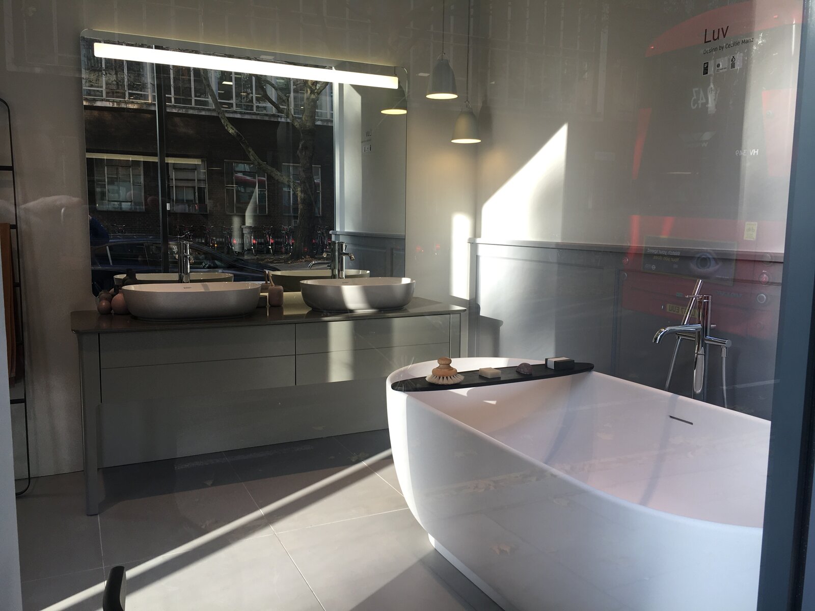

All of the shaver sockets on the market seem to be pretty ugly with designs and aesthetics dating back to when electric shavers were first invented. I have seen some new charging points specifically for toothbrushes from Proofvision (there is a double version and even one with extra sockets so a 'shaver' can also be plugged in - or water flosser or whatever other low power grooming device might be needed). I'm thinking about trying to hide the socket in or behind a new bathroom console (see photo of what it looks like in showroom without any charging sockets!) so that I don't have to have ugly toothbrushes or cables on display. Does anyone have any advice / tips on achieving this please?

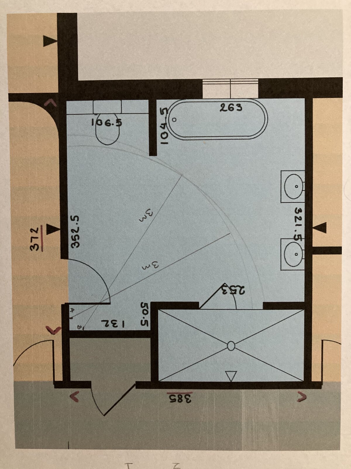

As a secondary question I know that the rules state it is OK to have a normal 13A socket in a bathroom so long as it is 3m or more away from a bath or shower. I won't bother rehashing the debates about bathing with toasters and Darwin / extension leads. However, I would like to have a socket installed at A or B on the diagram attached. I want to put a freestanding cabinet there to store towels, medicines, etc. I'd also like to use that as a location to store beard trimmer, hair clippers, etc. Possibly even for the wife's hairdryer. It is more than 3m from the bath and sinks. However, with some creativity the shower / steam room (which is fully enclosed with a glass door) is within range if you were to run a cable under the glass door and then dry your hair while taking a shower and laying on the floor. Does anyone think an electrician would sign off on the 13A socket under these circumstances? This is a master bathroom not used by children.

If that is a shower at the bottom of the diagram, then your sockets are not more than 3m. from the door.
Basins are irrelevant.

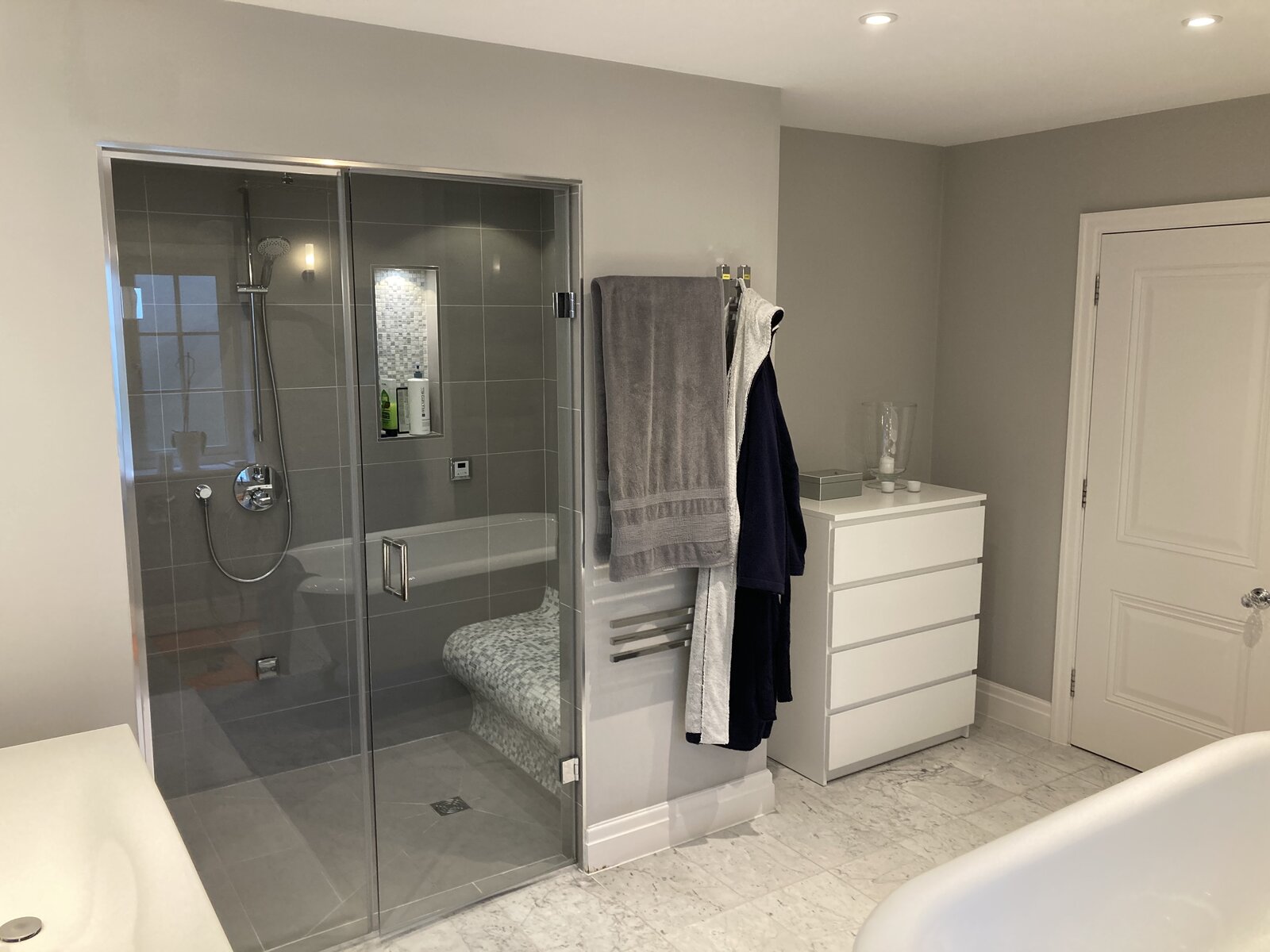

It is a shower / steam room with a door that seals (to keep the steam / water in). The door hinges as shown. As I said with some creativity you could shower with a toaster (by running the cable under the door and leaving door open - or running cable through crack between door and hinges when open - you could take plug off toaster, run cable through and put plug back on. If I was really desperate to shower with a toaster I could also just run an extension lead from just outside the bathroom door. It sounds as though common sense and intended use is irrelevant and it all rests on distances. Is that 3 dimensional distances or on the same plane? If I had a socket near the ceiling and ran cable into the cabinet I want to put in the alcove so I could then place items needing charging in cabinet I assume that would make no difference?

You could do all sorts of strange things but that wouldn't alter how far 3 metres is.
The distance is horizontally from the socket to a vertical plane from the edge of a bath or shower opening.
So if the socket were close to the ceiling I would be OK as there is no opening to the shower close to the ceiling keeping on the same horizontal plane (see photo)? Although I assume not?! (BTW the bath is still to be installed so is not actually in the right position).
A&B on the diagram are more than 3m from the bath, so sockets could be installed there if the shower/steam item is considered to be it's own separate room.
If the shower is considered to be part of the same room, then they cannot, as it's less than 3m.
The rules on bathrooms do need to be revised, as the 3m thing is total nonsense.
A small bathroom cannot have any socket outlets in it - yet a socket outlet is permitted just outside the door, because that is not in the bathroom, and zones / measurements don't extend outside of the bathroom.
You could do all sorts of strange things but that wouldn't alter how far 3 metres is. ... The distance is horizontally from the socket to a vertical plane from the edge of a bath or shower opening.
A&B on the diagram are more than 3m from the bath, so sockets could be installed there if the shower/steam item is considered to be it's own separate room. .... If the shower is considered to be part of the same room, then they cannot, as it's less than 3m.

photo is of the bathroom furniture we are installing at a showroom
Of course in a showroom there may be no water plumbed in, and it would not be classed as a bathroom, however as to then fitting it into a home, it is another question.
