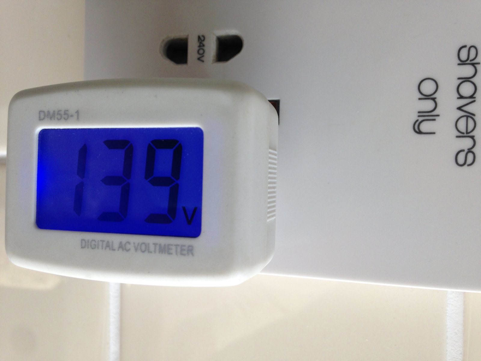

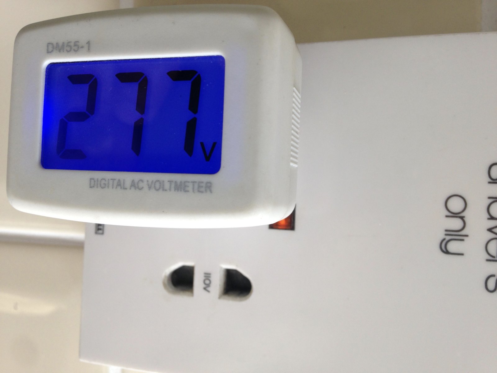

More important is the fact that the regulation on shaver sockets is sh1t. On low loads such toothbrush or shaver charging the output can be as high as 280 volts which could damage the toothbrush or shaver. Much better to charge on the 110v output which will rise to around 140 volts, and which is in the typical voltage range of 100 to 250 for these products.
Note the MK models won't accept a British shaver plug in its 110v outlet. So don't buy an MK one.
That rather surprises me. I had always assumed (again, maybe wrongly) that they used a 1:1 transformer (with a secondary tap for 110V), in which case the output voltage would never be greater than the input voltage (but would probably be appreciably lower when powering a shaver).
Kind Regards, John
For once Winston has correct information.
The off load voltage on the secondary will be higher than the voltage ( rated ) at normal load. The resistance of the winding and the current flowing through it create a voltage opposing the voltage produced inductively in the winding. So the manufacturer will add a few turns on the secondary to allow for the resistive voltage.
