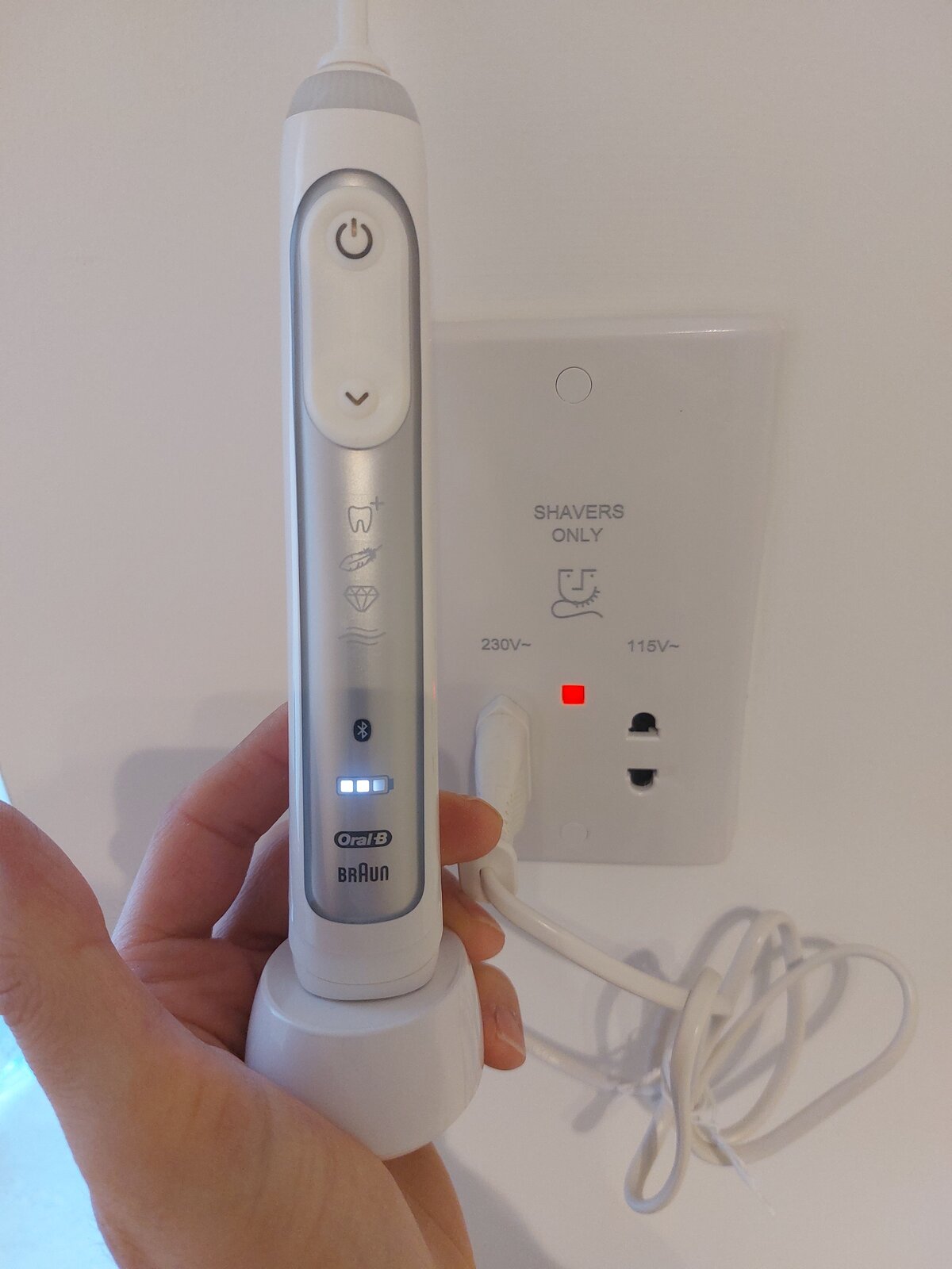

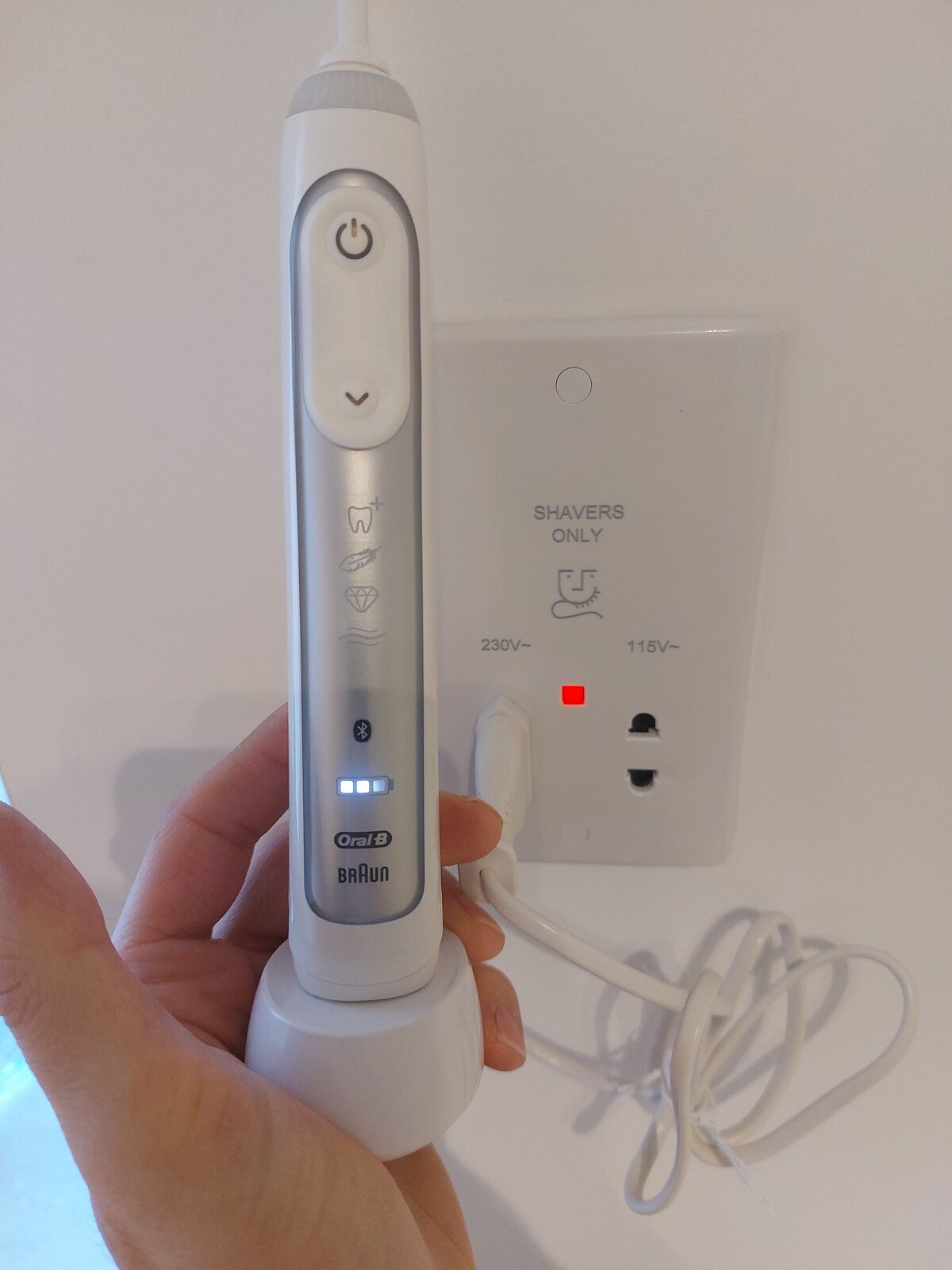

I have just moved into a new build property. My shaver and electric toothbrush both charge/work using the bathroom shaver socket.

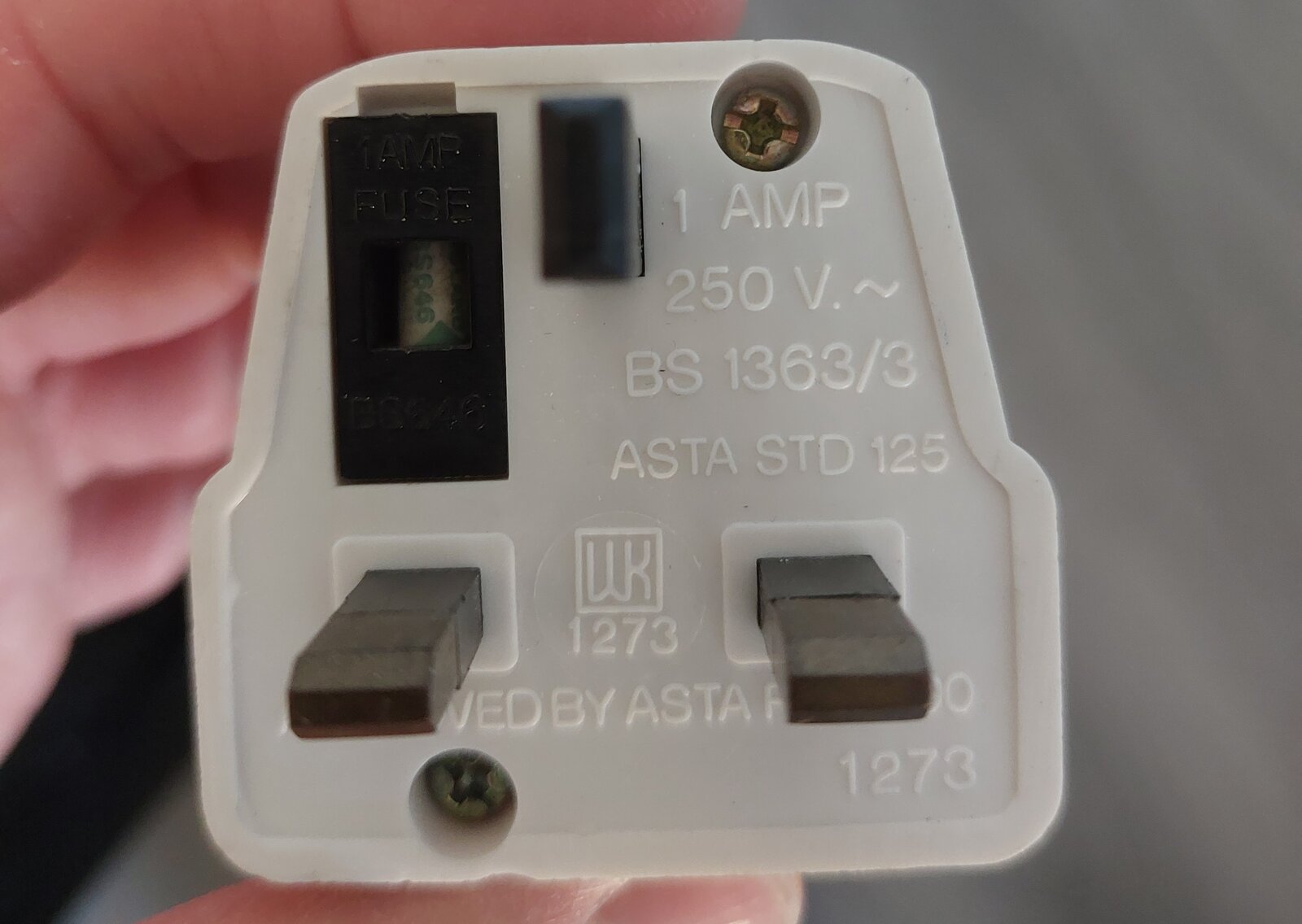

I have two, 2 pin to 3 pin adapters to charge the shaver/toothbrush using a 13amp 3 pin normal socket, however neither the shaver nor the toothbrush work when I try. (They worked fined in my old place just before I moved last week). I have tried in multiple sockets. The 3 pin 13amp sockets all work fine for everything else and I have used a socket tester as well. Cannot figure out the issue.

1. Shaver and toothbrush work in bathroom shaver socket (cannot be device specific)

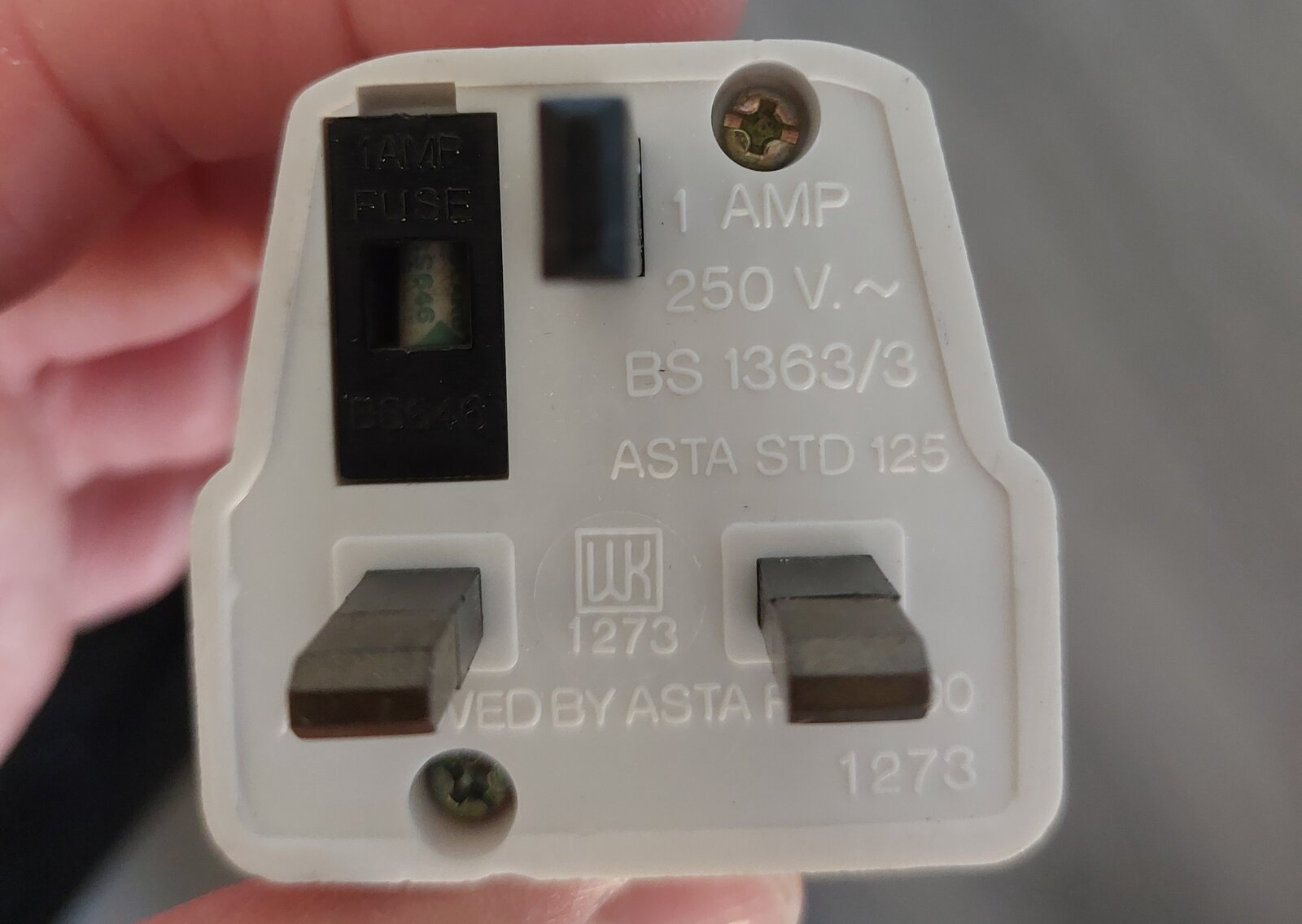

2. I have 2 different brands of 3 pin to 2 pin 13amp adapter and neither works with either the shaver or toothbrush, cannot be the adapters (Also tried switching out the 1 amp fuses in the 3 to 2 pin adapters).

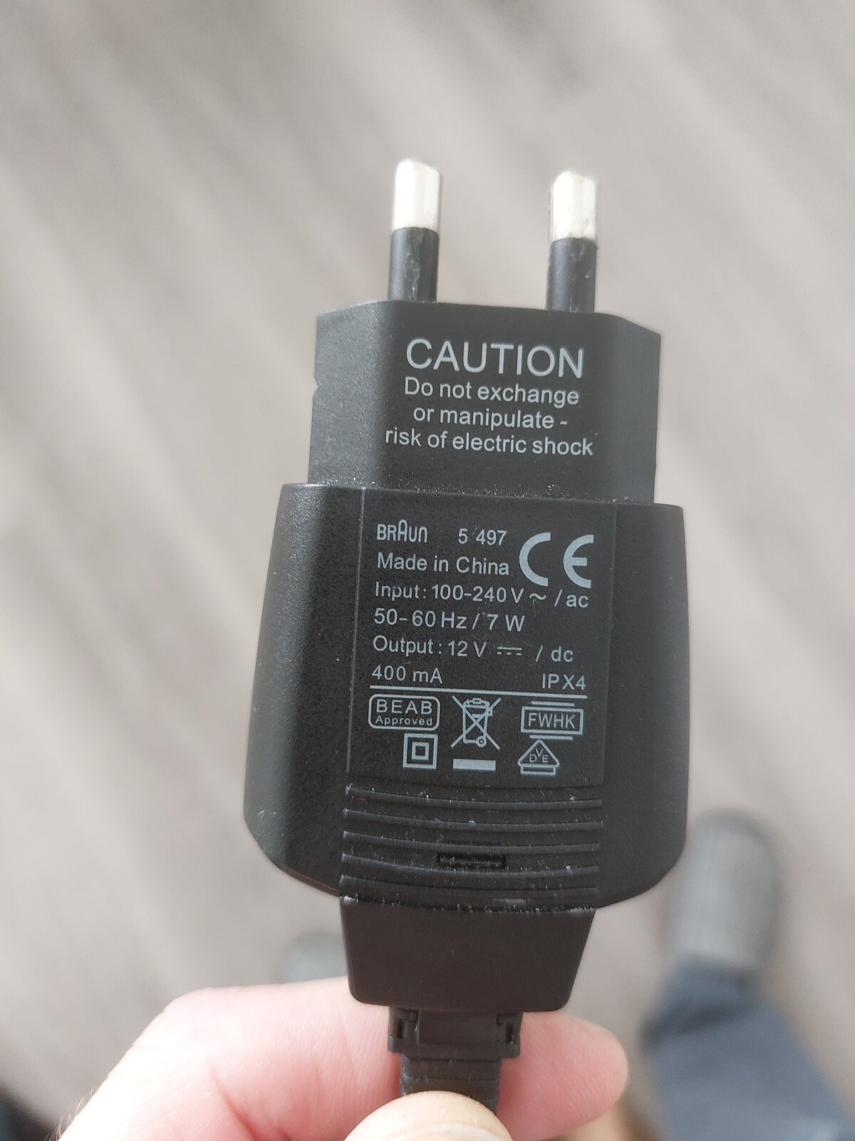

3. I also even tried a spare charging cable for my Braun shaver.

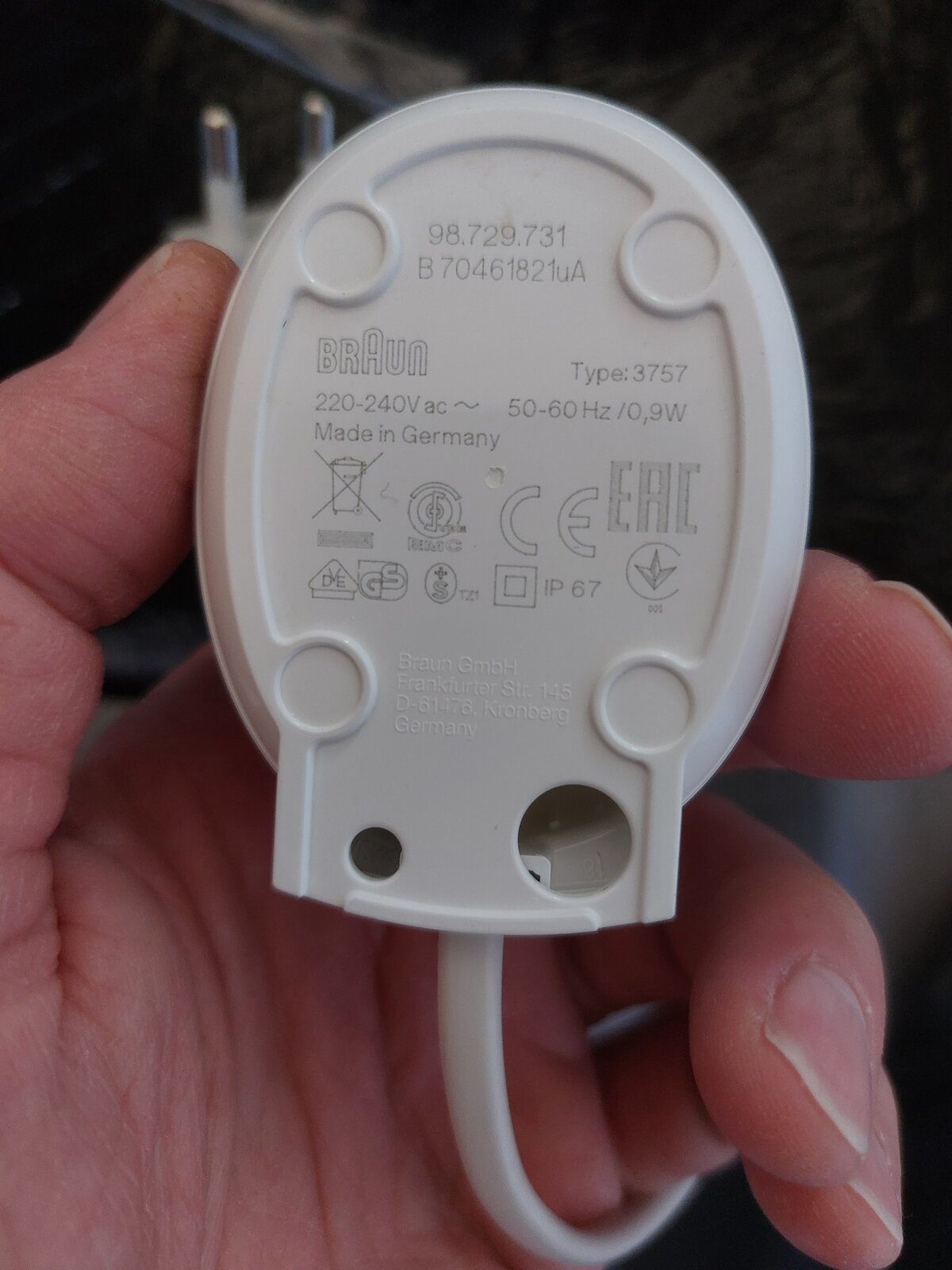

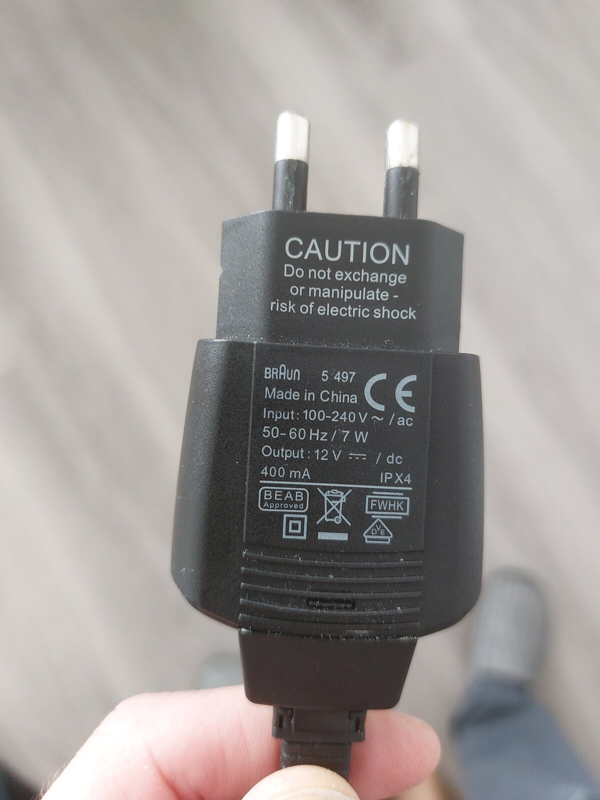

Photos of specs for each item attached.

Photo no. 2 appears to be your adaptor.
Why do all three pins look like they are made of black plastic?
Have you tested the removable fuse? What is its rating?

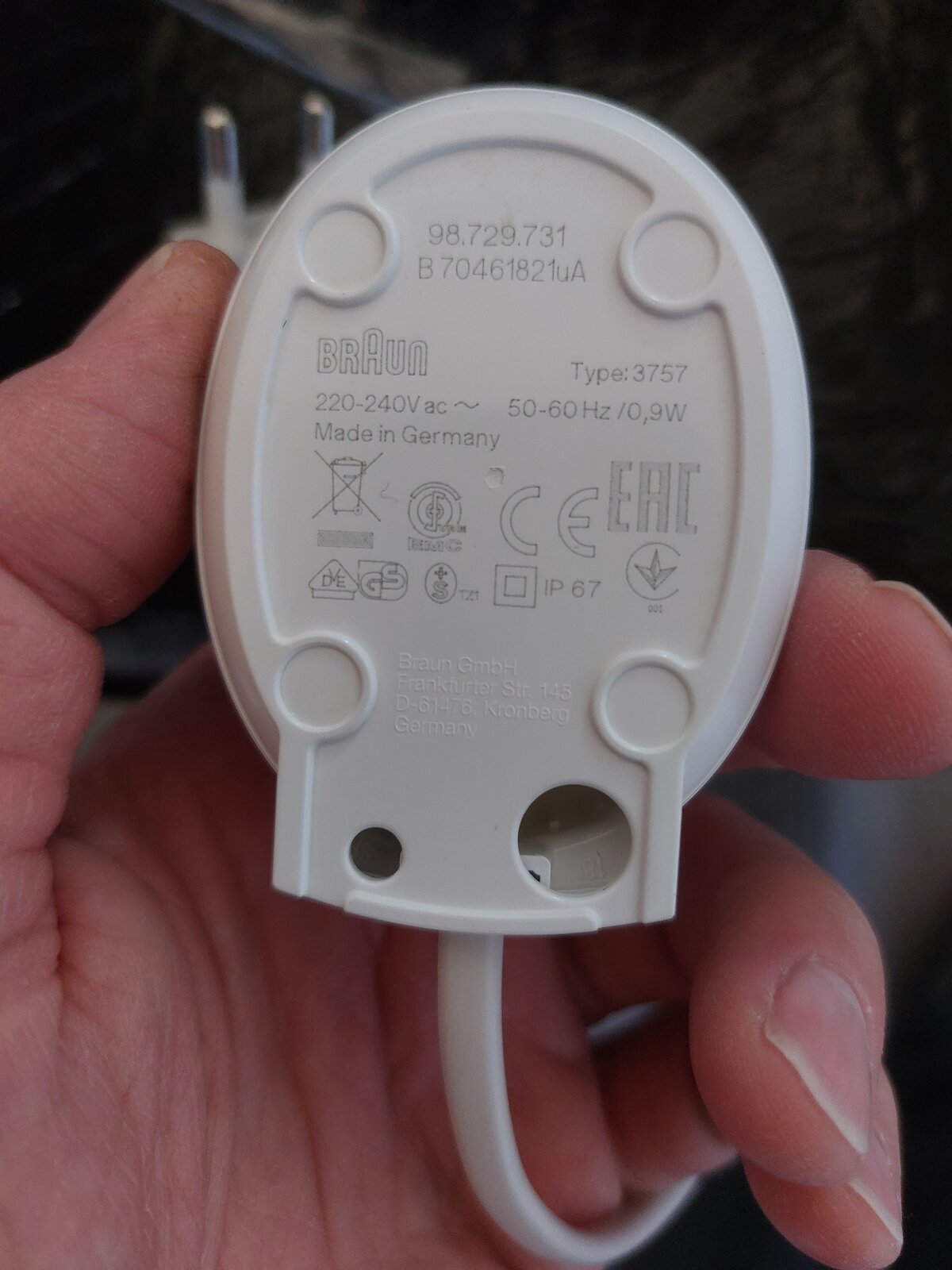

Photo no. 4 is presumably your shaver PSU. Is it an original Braun part? The pins look rather short to me and it looks like it is heavy enough to drag.
Thanks for quick reply. Yes it is shaver psu, absolutely is original. I have 2 of them identical, 1 from old shaver where battery died. As I say, worked in old house using the 3 to 2 converters, and works in the shaver socket, but neither shaver nor toothbrush work in the 3 to 2 pin adapters in my new place I just moved into on Friday...

The shaver socket works, it's the 3 pin to 2 pin adapters I have that don't seem to work, and they worked in my old place. It's the other way around, which no-one seems to ever have reported. Shaver wall socket is fine, all working. It's the 3 pin to 2 pin adapters to use in 13amp wall sockets that won't work with either my shaver or toothbrush.
There is nothing in the adapter apart from a fuse, so as long as the pins are making good contact it must be the fuse. But you say you've changed the fuse and normal use shouldn't blow a one amp fuse. If it was me, I would check the fuse with a multimeter, but if you don't have one then as a test try a 3 amp fuse. (If your house burns down just tell your insurance company someone on the internet said it would be OK)

Unplug the white adapter from the mains, undo the screws, and take the front off.
I suspect that the pins of the two pin plugs you are using may have stretched the socket contacts out of true. Nipping them up with needle nosed pliers, so the plug is a snug fit, should fix it.

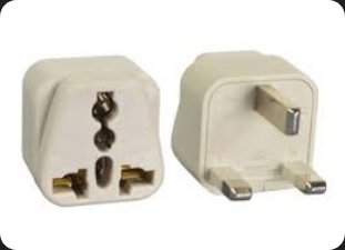

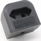

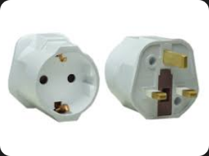

The plugs my look the same, but they are not quite the same, an adaptor like this 1724967299500.png or this 1724967346120.pngsupport the euro plug, but adaptors like this 1724967459273.png offer no support for the plugs, have no shutters, and often no fuse, and once a plug with the fatter pins has been used, those with thinner pins may not make proper contact.
Not really want we want, we should be using BS 4673 but often we find the Europlug is fitted.
I use those adaptors for toothbrushes, but for overseas visitors, I got them to bring me a multiway extension which I put a 13A plug on.
