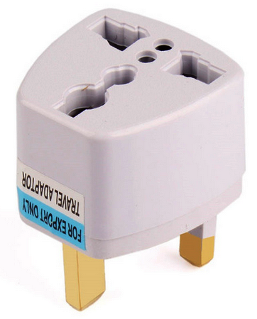

Personally I would return it as unfit for purpose, but I have some items I know don't comply, I have a few of these 1657794342923.pngwhich do not comply, but in my bedroom plugged into an extension lead, so fused by the extension lead fuse, they are handy to use switch mode power supplies with 100 - 250 volt input and USA plug formation. I have no children in the house, and visitors will not have access to my bedroom, in fact to allow them access could be deemed illegal as I have transmitting devices which require a licence to use.
So although if found at work I would smash with a hammer and put in bin, at home I feel safe in my hands. But they came with equipment and the suppliers were technically breaking UK law by including them with the equipment. But suites my needs.
