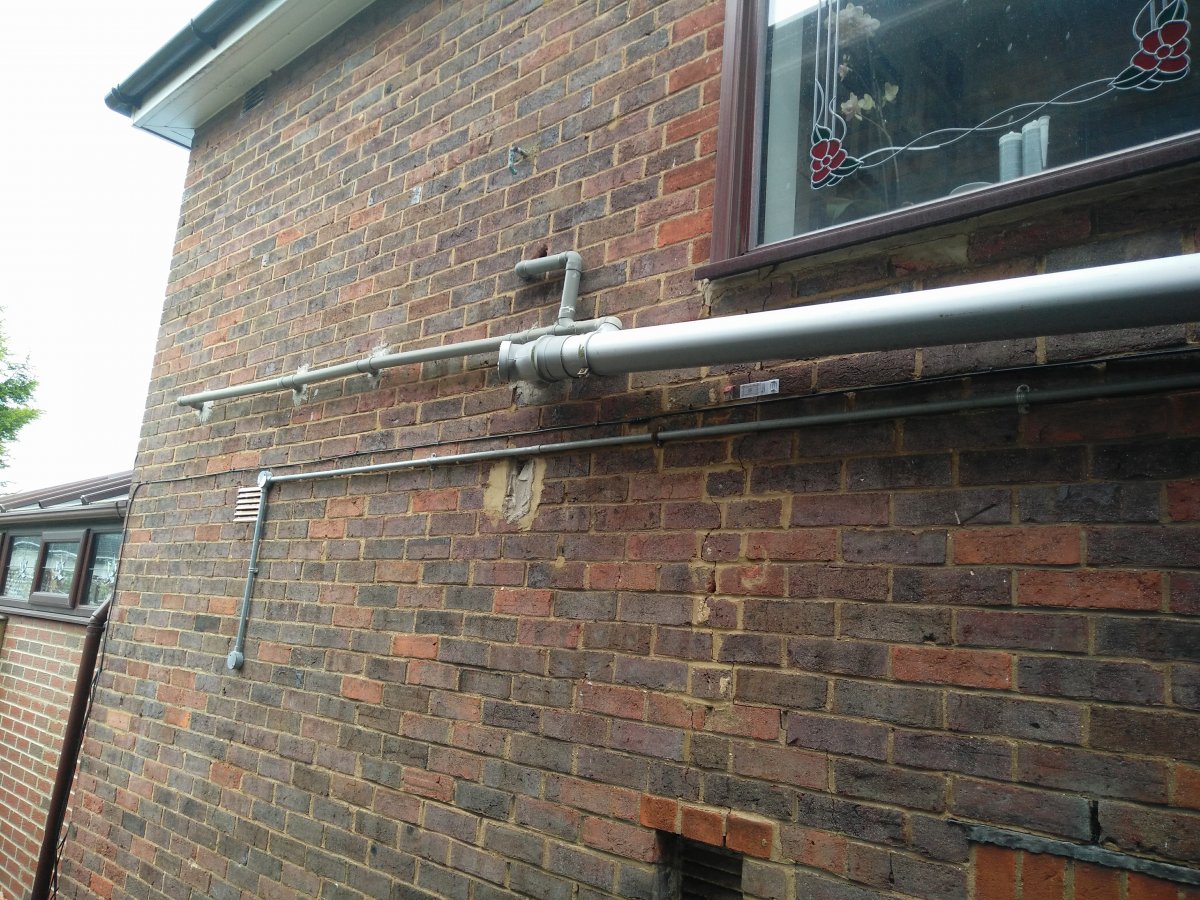

Hi all, I'm remodelling my bathroom and looking for some advice on sorting out the waste connections. The bathroom currently has a bath, a separate shower, a bidet, a basin and a toilet.
The toilet waste goes outside to an elbow then horizontally around 2m at a slight drop to the vertical soil stack.
Each of the others has a separate 40mm waste pipe inside which leads outside and they then all T into the same 40mm pipe on the outside which goes horizontally around 3m at a slight drop and then joins into the toilet waste.
(see pictures below)
My understanding is that each waste should connect directly to a soil pipe and they shouldn't all join into the single 40mm waste pipe on the outside. Is that right?
I am going to be getting rid of the bidet and also moving the position of the shower so that it is in line with the bath.
What I want to know is whether I should make any changes to the existing waste or whether I simply block off the bidet waste and existing shower waste and T in the new shower to the external 40mm pipe like everything else is? If not what should I do short of moving the whole stack?
I’m not sure who did this work and clearly this is not an original bathroom but currently everything drains ok. I wouldn’t say it is brilliant and drainage sometimes slows down a lot but after clearing (?hairs) with caustic soda it is fine again for months. One of my concerns is that after moving the shower, the waste for the bath will run underneath the shower tray so if there are any problems with this in future, access will be difficult. The bath waste also currently seems to sag a bit inside (under the floorboards) and exits the bathroom at a high level (only just below floorboard level).
If keeping the current system is not a good idea then the simplest thing that I could think of would be to replace the elbow where the toilet soil pipe exits the house with a T and extend the soil pipe along the same line as the current 40mm pipe then T everything into the extended soil pipe. It would be a very long horizontal soil pipe but would this be ok?
Any advice or bright ideas on how to sort this with the minimum disruption would be great.
Thanks in advance
