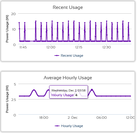

I suspect my Kia battery is on the way out,
all other batteries settle down and show a voltage over 12.8 at 0.1 amp, but the Kia battery has been switching between 0.1 and 0.8 charge rate for weeks, after I allowed it to go very low. Or the is some thing left switched on in the car which I have not found.
